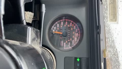

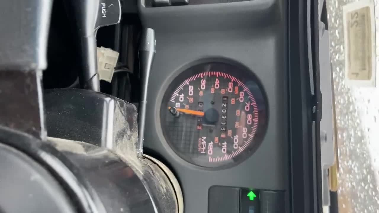

Okay, when my car is in park I rev the engine and the speedometer goes up and it goes up fast I can get to the max speed just by revving the car. Any idea what this would be?

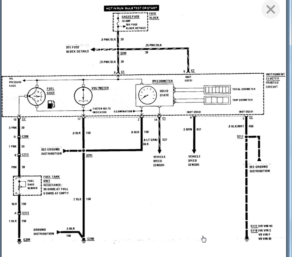

So this is a direct feed from the speed sensor through the gauge and direct to ground. Did you run a new ground wire or at least check to make sure it is a good ground? then we need to monitor the voltage on that wire when in park and you are reving the engine. If you have voltage spikes then I would think the speed sensor is the issue. If not then the cluster must be the issue.

This car has a buffer box and it goes from the buffer box to the cluster dash the speed sensor wires got cut somewhere by the last owner and when I rewired it not it does this before I had nothing because it was not wired. I was thinking maybe the speed sensor is going bad or the buffer box is acting up.
Oct 20, 2020 at 1:48 PM
Okay. Clearly the wiring diagrams are not matching your vehicle so based on that information, I would think the buffer box is the issue and not the speed sensor. Assume this is the speed sensor that they are showing as your vehicle having, it is a driven gear. So if that is not spinning then there is no voltage generated. The box however, could have a short causing the issue.

This is the video. sorry it took me so long.

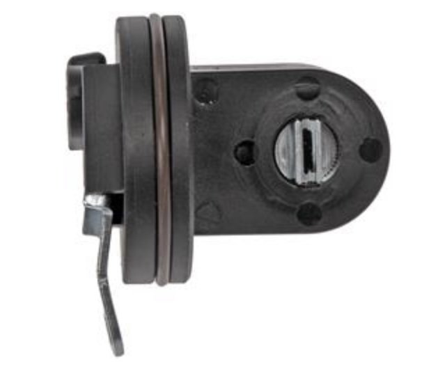

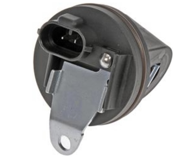

This did not do anything. But than you for the info I have a new VSS and I rewired it with all new plugs and the wires. I have a new speed buffer box put in and a new dash cluster. what else am I missing? What can mess up the speedometer other than the speed sensor in the back of the transmission? Or what?
Nov 28, 2020 at 12:26 AM
Has this issue been the same the entire time and it has never changed? You are not missing any components so the only thing I can think is we have a faulty part or like Danny said, we have dirty contacts or something like this.

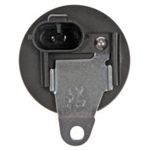

To answer your question, there isn't anything else that would cause this other then one of these parts. The only other question that I have is, what gear do you have in the vehicle or do you have the speed sensor? Can you get a picture of the sensor that you have?
Nov 29, 2020 at 11:42 AM
TREVORMCCASLIN
  • 11 POSTS
That is the VSS that’s in the back of my transmission. And yes it’s been the same ever since I hooked it up.
Nov 29, 2020 at 5:41 PM
Okay. Can I dig a little deeper into what you mean by it has been the same "since you hooked it up"? Does that mean that you recently bought this car or whenever you got the car the speedometer was not hooked up and as soon as you hooked it up, this is what it was doing?
If that is the case, then it is safe to assume this is why it was unhooked. Which means we may be dealing with something the previous owner messed up.

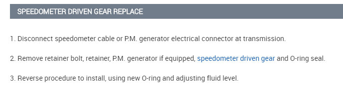

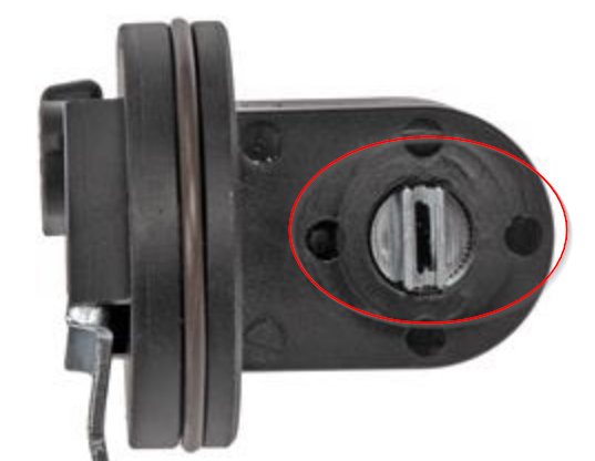

I am trying to find it but there should be a driven gear that attaches to the sensor where I circled.
I am not finding the gear options but there are normally other sizes for when you change the wheel or gearing size then you can adjust the speedometer gear so that it is accurate.
This would all make sense as to what you are seeing because if that gear is wrong then the speedometer climbs too fast.
Can you remove the sensor again and see if there is a removable gear inside the unit? This is what I am not finding in the manual so we are going to have to just see if we can figure this out. As this is the way most all other vehicles of this era operated.

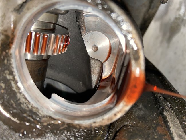

Okay, I got the VSS out and there is like a bracket in the transmission the broke. how can I fix this?
Jan 2, 2021 at 4:23 AM
Sorry, but I am not seeing the broken part? If it is inside the transmission then the only way you are going to fix that is to take it apart. Let me know if I am missing something. Thanks
Jan 3, 2021 at 10:38 AM
DANNY L
  • 5,648 POSTS
Hello again.
Yes, I'm not seeing anything broken either... Can you take another picture or circle what you think is broken? Thanks again for using 2CarPros
Danny-
Jan 6, 2021 at 9:40 AM
TREVORMCCASLIN
  • 11 POSTS
I think I found out what it was it had a different gear on that shaft it was a metal gear and I pulled it off and I am going to be putting a plastic one on the shaft tomorrow and I’ll let you know what it does.
