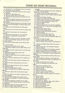

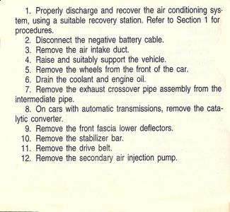

I wondered about the engine removal and found that one must remove the engine from the bottom . Before 1993 the engine could be removed from the top like normal bujt since the body style change it's diferent. What bothers me about your engine is that the oil pressure stays up until it reaches 180 degrees. If you lost oil pressure the lifers would make a racket. you can try using some engine cleaner. the screen in the oil pan could be glogged. Or it could be the oil pump. try some engine cleaner first to see what happens. enclosing instruction to remove the engine. You might have to save as picture then resize when you have them on your computer.

Thanks MJ for the info, I believe that i will end up taking the engine out to check it.....
