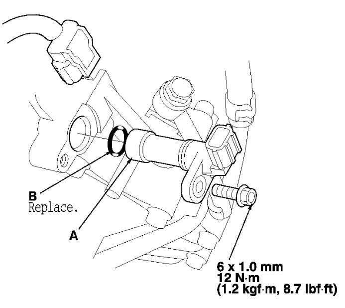

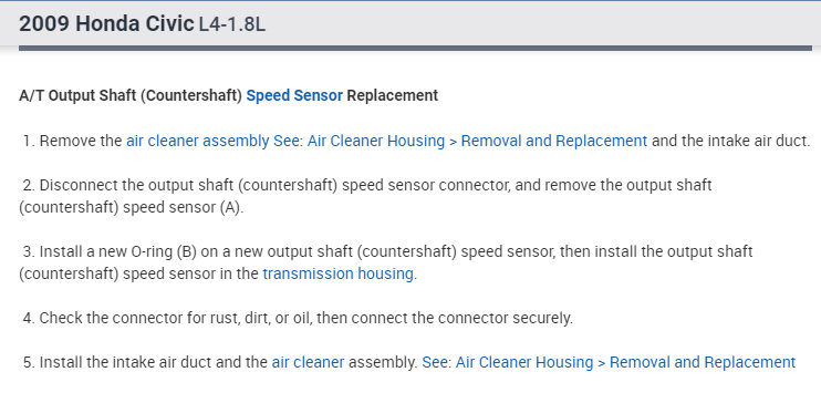

I had a check engine like reading code p0720 and p0722 but AutoZone is saying the p0720 needs replaced, however I cannot find where the sensor is. My car is so congested it's hard to see anything. However, is it just the one sensor that needs replaced or both? My speed odometer isn't working and car shifts to second but nothing higher, sometimes not even out of first.

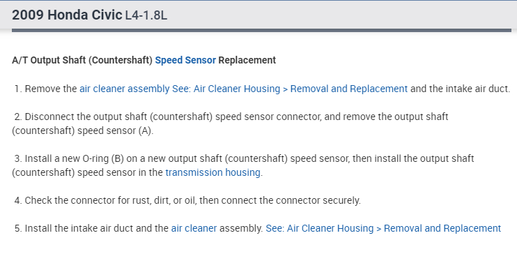

If you remove the air cleaner assembly you will have access to its location. I've attached 2 pictures below showing what it looks like and how to replace. Hope this helps and thanks for using 2CarPros.

So are there two sensors I'd have to replace or just the input speed sensor? I know some things about cars but never knew about these.
