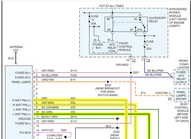

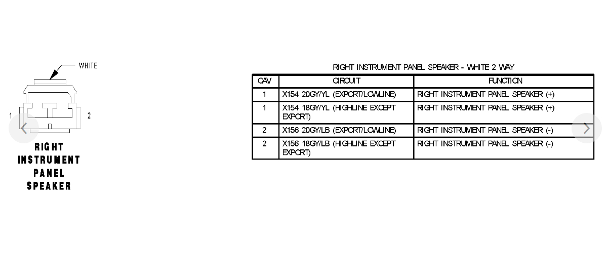

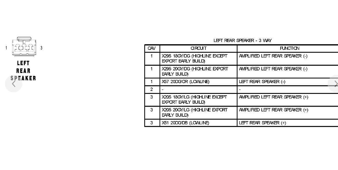

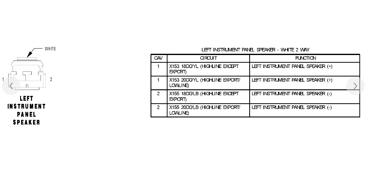

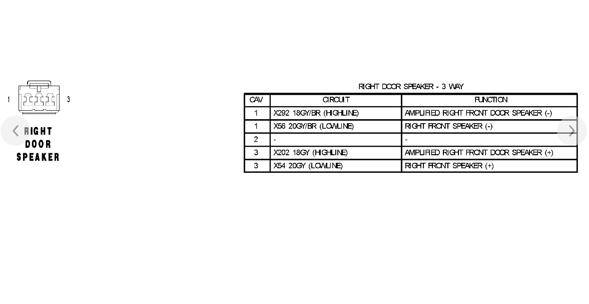

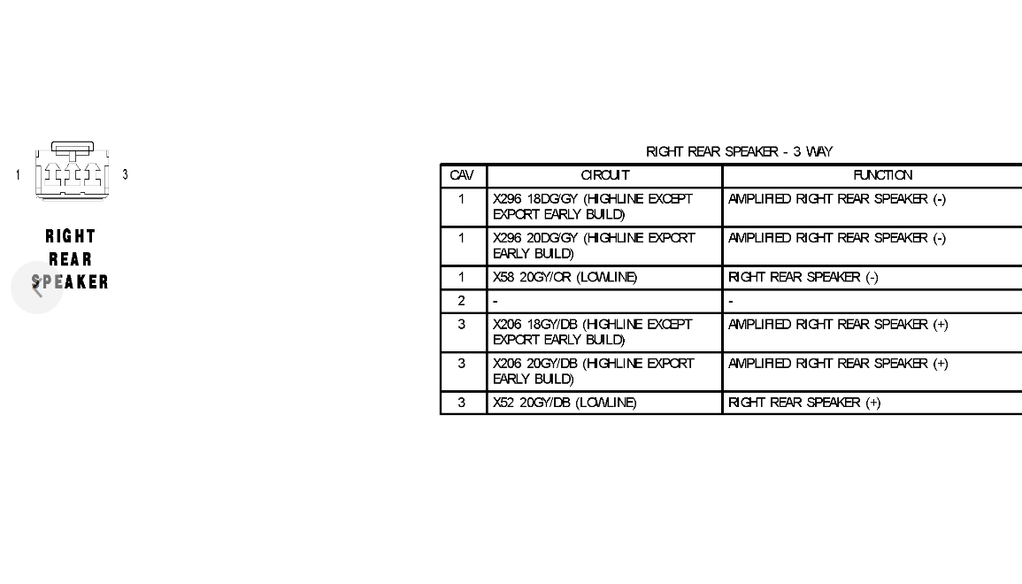

I installed an aftermarket stereo and speakers. My issue is trying to figure out the positive and negative of each speaker wire. My van has two dash and 4 door speakers. I'm going to be adding amplifiers, so just would like to make sure all wires are in the correct phase.
Jan 15, 2022 at 4:19 PM
SQM
  • 6,383 POSTS
I have attached the pinout for each speaker below.
It shows the positive and negative and the color of the wires.

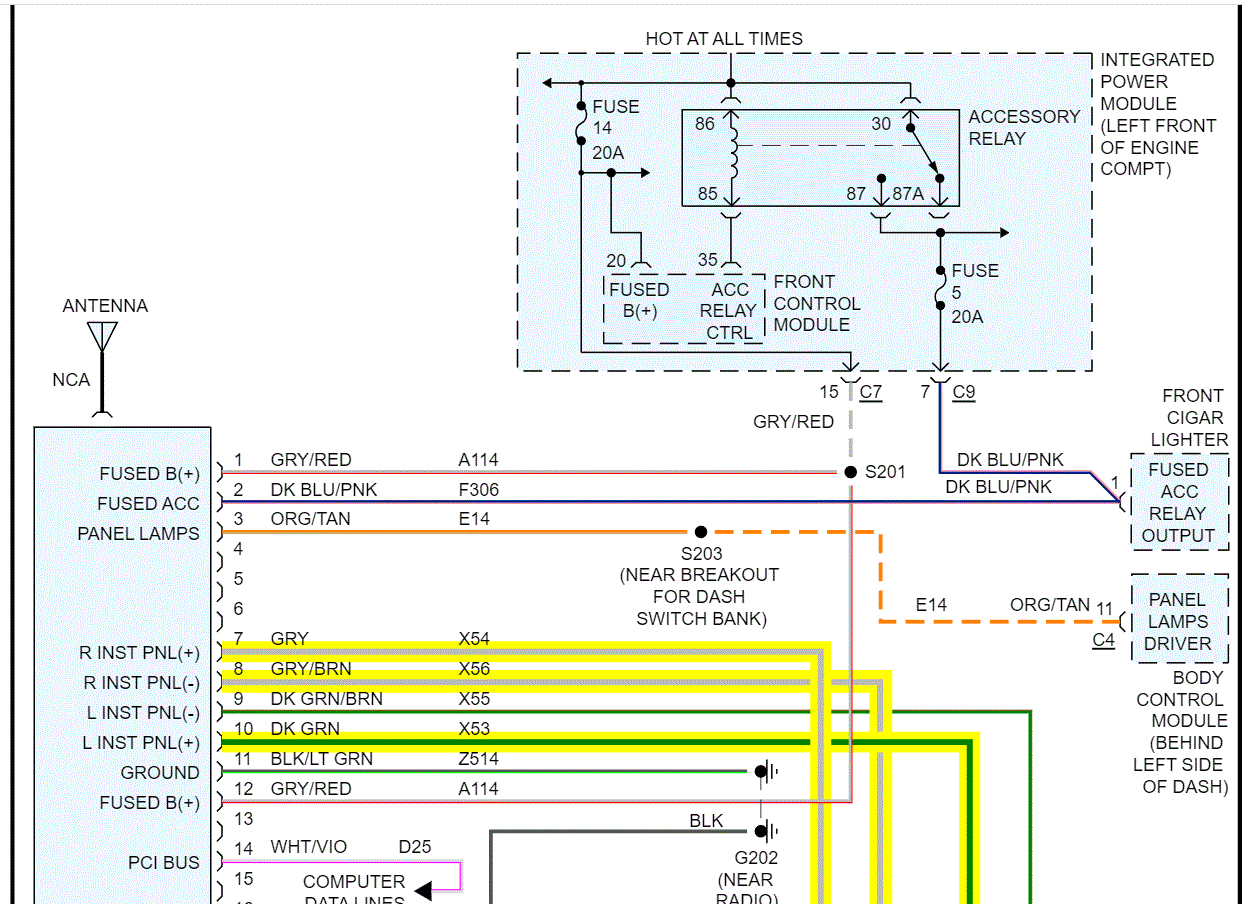

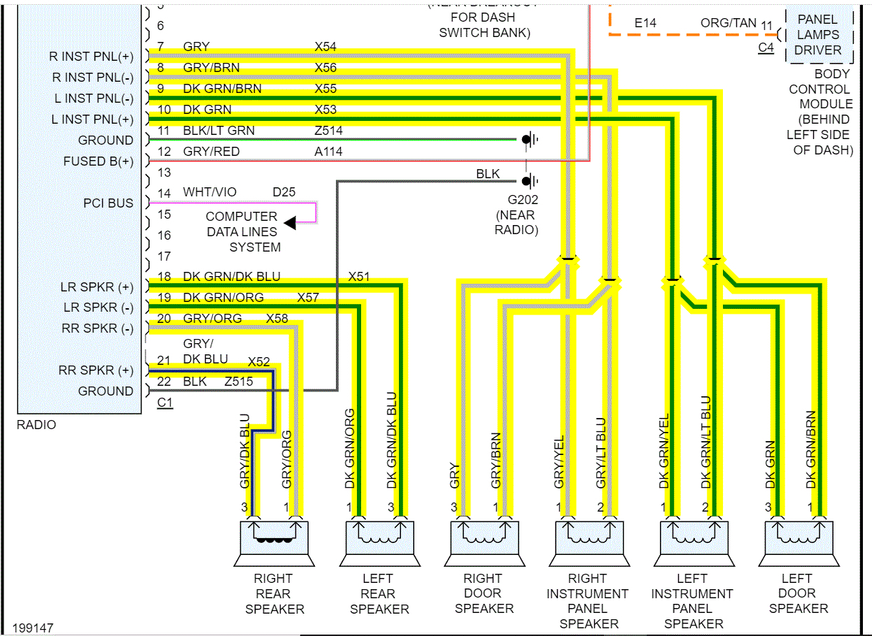

If you look below, I attached the wiring schematic for the basic stereo that came with the vehicle. I highlighted all wires related to the speakers.
If you follow them back to where they would attach to the back of the radio, you will see which are negative and which are positive. Also, the wire colors are included in the schematic, so you know which wire is which.
See pics below. Note: I had to cut the schematic in half to make it readable for you. I did overlap the two so you can follow from one to the next.
