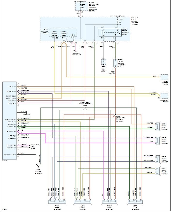

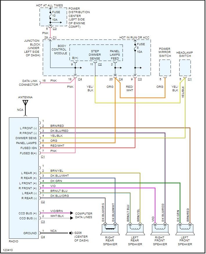

I am having trouble installing an aftermarket stereo to the infinity speakers without the factory amp. I need to know what the color codes are for the front 6x9 speakers. There are 4 wires, not just 2

I have attached the wiring diagrams below for both the premium system and the base system since I don't know which you have

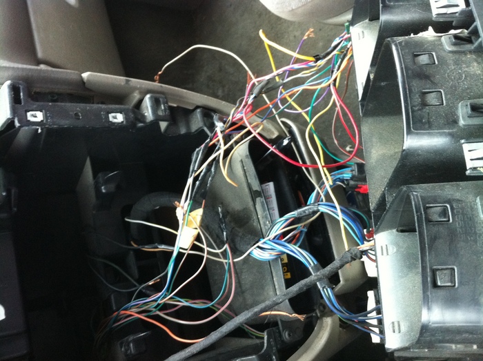

If you could direct me to a color diagram for the schematics of the wiring and any info that I have a 2003 dodge caravan sport 3.8, and want to install a aftermarket stereo. When I took out the old radio I seen a big mess of wires all spliced in multiple spots and different color wire that wont match the harness I bought, I even went to a scrap yard and couldnt find what I needed.
Please help my wife is gonna kill me if she sees the dash like this

CARADIODOC
  • 33,916 POSTS
Do you have Infinity speakers? The word "Infinity" will be on the door speaker grilles, or you'll see four wires going to each door speaker instead of just two.
-2
Monday, March 25th, 2019 AT 11:33 AM (Merged)
FATHEROF4
No its just a simple 4 speaker with out the infinity system

CARADIODOC
  • 33,916 POSTS
This is from a 2002 service manual, but Chrysler was pretty consistent over the years.
Gray / red: constant 12 volt memory
Dark blue / pink: switched 12 volts
Orange / tan: lights
Black / pink: ground
Black / light green: ground
Dark green: left door speaker +
Dark green / yellow: left instrument panel speaker +
Dark green / brown: left door speaker -
Dark green / light blue: left door speaker -
Gray: right door speaker +
Gray / yellow: right instrument panel speaker +
Gray / brown: right door speaker -
Gray / light blue: right door speaker -
Dark green / dark blue: left rear speaker +
Dark green / orange: left rear speaker -
Gray / dark blue: right rear speaker +
Gray / orange: right rear speaker -

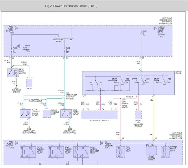

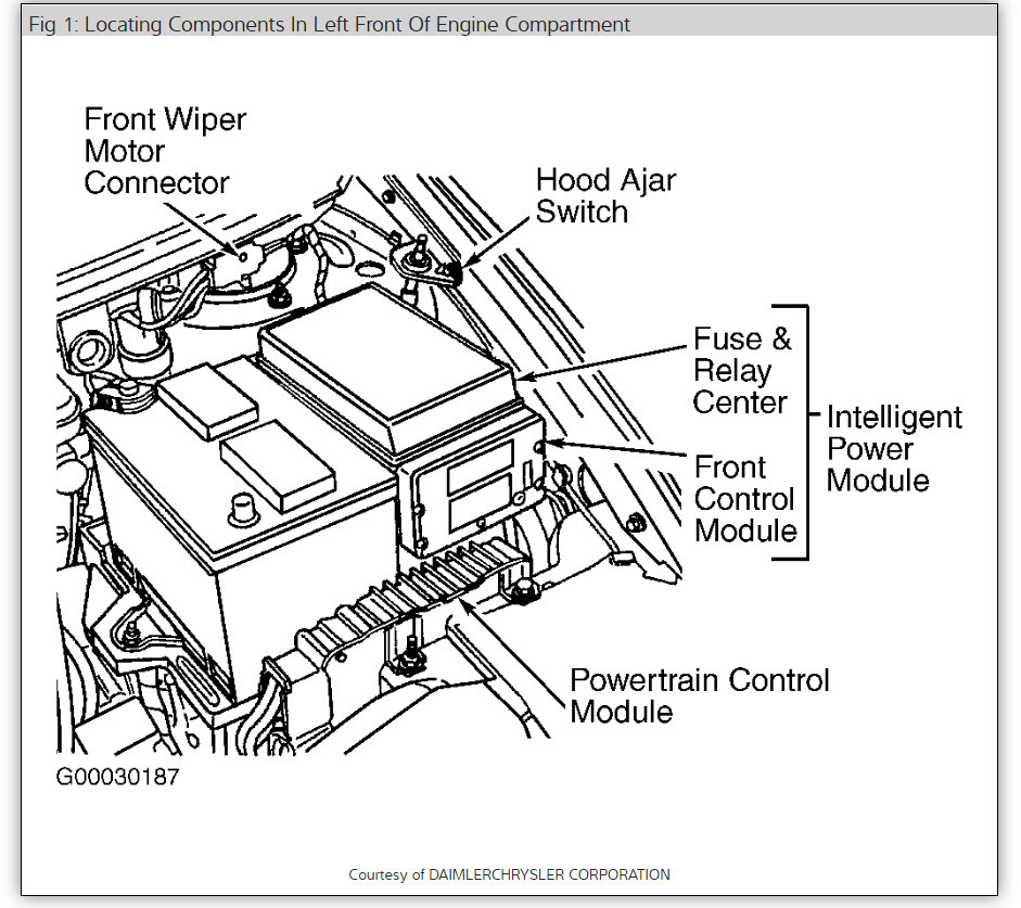

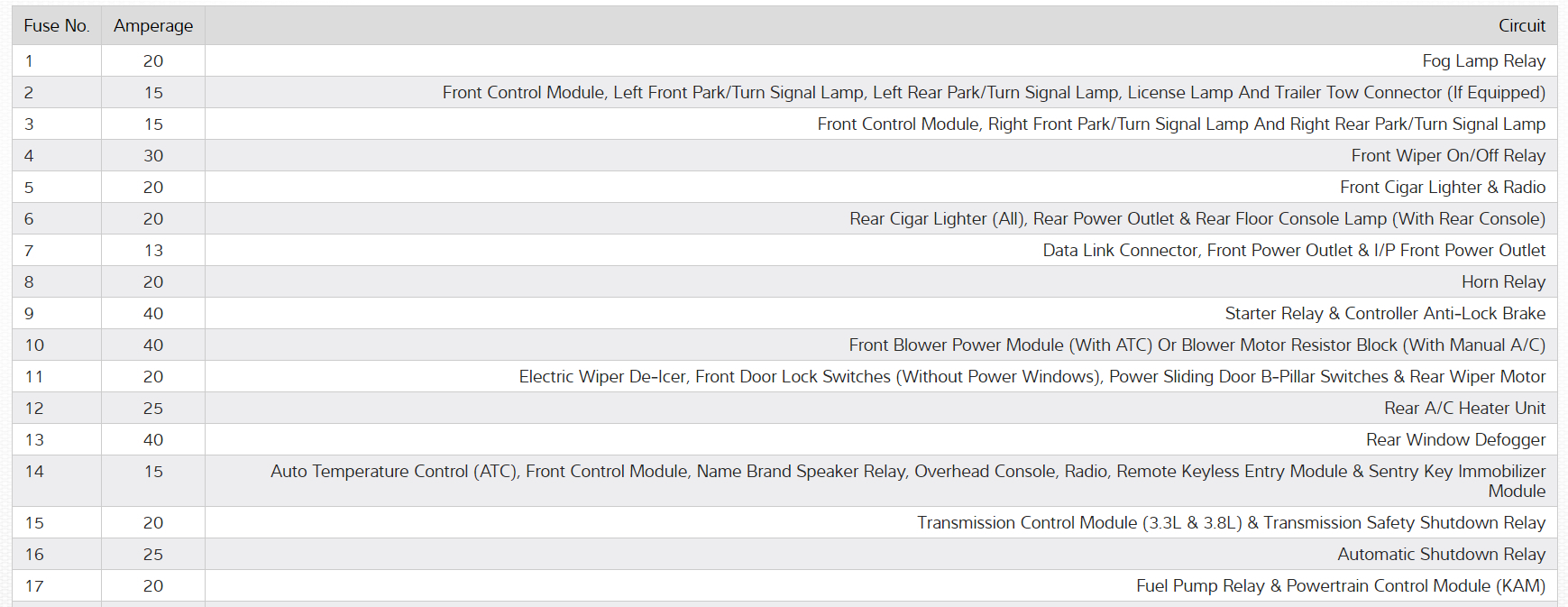

FURNACEBAGS
  • 2002 DODGE CARAVAN
  • 6 CYL
  • 2WD
  • 115,000 MILES

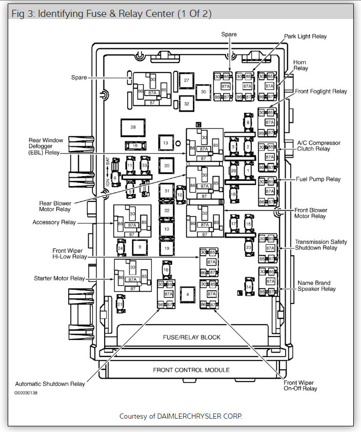

Blew a fuse for the radio and cigarette lighter, but cant seem to find it. I looked in the main fuse box beside the battery, but it is not indicated.
KEN L
  • MASTER CERTIFIED MECHANIC
  • 48,363 POSTS
The fuse is in the TIPM under the hood fuse #5 and #6 both 20 amp. Here is guide and a wiring diagram so you can see how the system works to help you find and test the fuse.
+1
