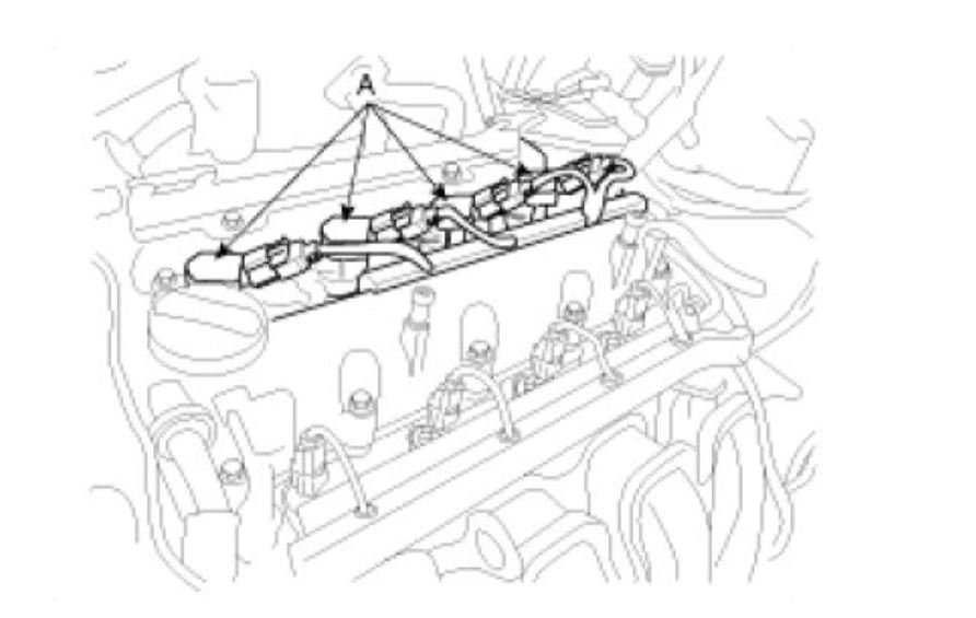

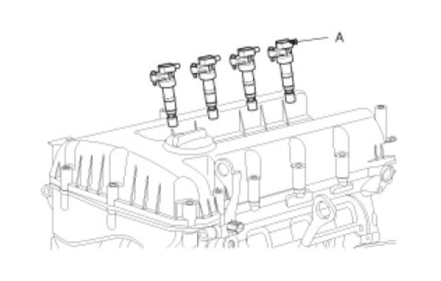

I was watching your video on spark plugs for this vehicle. Is there anything I should unplug or detach that is electrical within the car before doing spark plugs? Such as a battery, sensors, etc. and if I disconnect the battery should I only take the negative off or the positive terminal as well? Just trying to be precautious. Thanks!
Apr 24, 2019 at 6:05 PM
Good morning,
No special items to disconnect. No need to remove the battery cable as well. Here is a guide to help with diagrams below to show you how on your car.
https://www.2carpros.com/articles/how-to-change-spark-plugs
Apr 24, 2019 at 9:07 PM

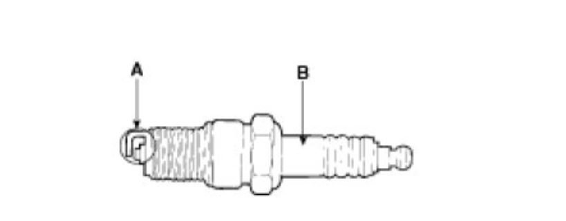

What is the spark plug gap for the 2.4L Thanks
Nov 27, 2020 at 9:42 AM (Merged)
  • 75,992 POSTS
Hello the spark plug gap is - Gap 1.0~1.1 mm (0.0394 ~ 0.0433 in.) here is a guide that will help walk you through the service.

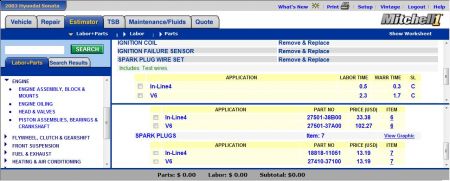

How much does it cost to replace the spark plugs and wires on my 2003 Hyundai Sonata?
Nov 27, 2020 at 9:44 AM (Merged)
  • 75,992 POSTS
Labor rate per hr. varies with location could range from $70-$130.00 per hr. See quote

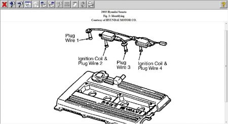

Where are the spark plugs located on the car. How do you replace them?
  • 75,992 POSTS
Its under the coil and plug wires-see below
