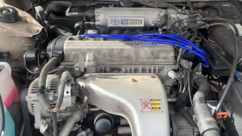

I pulled off all my spark plug wires to change the valve cover gasket. Three of the wires snapped back on, but one won’t “snap” on and now the engine is running a rough idle. How do I get the one wire that won’t “snap” on to “snap” on?

Thanks Joe. Hope you have a Happy Thanksgiving also. I was eventually able to get the spark plug wire back on the spark plug and the car is still running rough at idle. I have a feeling that the wires are bad because before I took the valve cover off, I degreased the engine, and I got quite a bit of water in the spark plugs tubes. Water got all over two spark plugs and the associated wires. Am I right to think that water coming into contact with the wires would make them go bad?

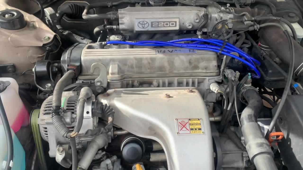

Here’s a video of the car at rough idle, make sure you watch to the end. Thanks again.

I watched the entire video and noticed the change toward the end. That doesn't sound like a misfire to me. Were there any other issues prior to replacing the gasket?
Do me a favor. I need you to check if there are any diagnostic trouble codes stored in the computer. This has an OBD1 system which doesn't require a scan tool to retrieve codes. Follow the directions in this link and let me know if any codes are found.

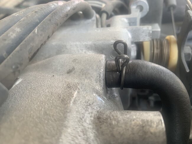

So, I changed the spark plugs and spark plug wires and the engine is still running rough. However, I found a small crack on the small hose coming from the PCV valve. Is this crack enough to cause a vacuum leak and this causing a rough idle? I attached a picture of the crack.

Looking at the crack, I'm going to say no because it is before the clamp. However, if it is cracked there, it may be in a different location.
Here is what I would do. With the engine running, carefully spray carb cleaner where the crack is located. If there is a leak, the engine RPMs will likely increase. You can do this around other vacuum hoses and the intake.
