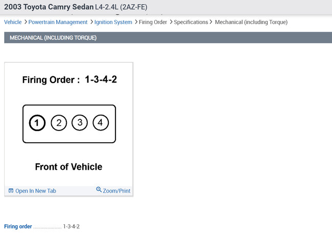

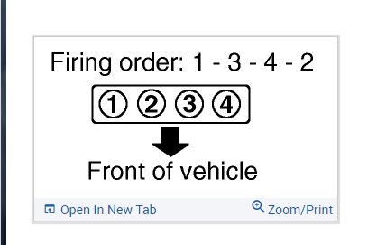

i want to know the firing order of this model?
Oct 29, 2008 at 8:30 PM
BLUELIGHTNIN6
  • 16,542 POSTS
Firing order is 1-3-4-2. Number 1 is on the passenger side, 4 is on the driver side. Here are the firing orders for both 4 and 6 cylinder engines. Check out the images (Below). Please let us know if you need anything else to get the problem fixed.

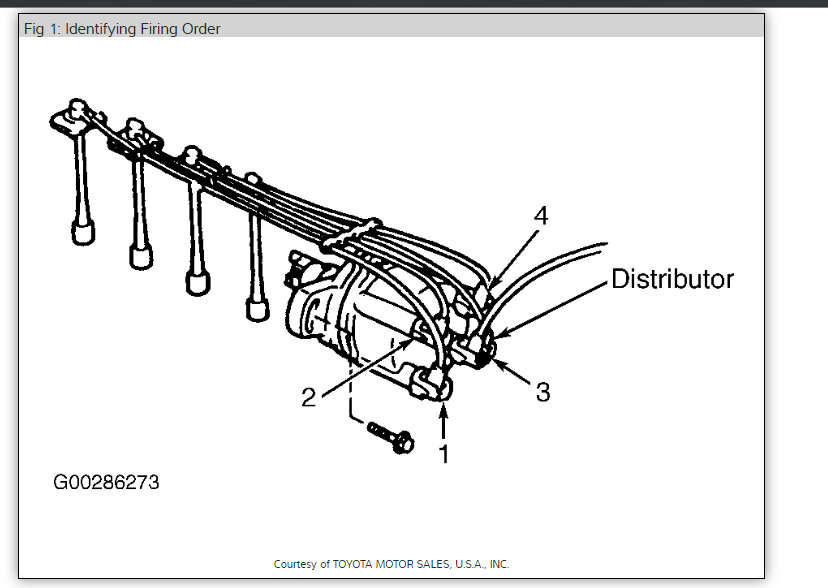

KCGJ0406
After researching I know that the firing order is 1342, but what do I do with that information? My wife had a friend replace the spark plugs, distributor cap, and rotor. It has been running rough ever since. Attaching a diagram.
Kavin C
Sep 24, 2020 at 4:57 AM (Merged)
Good afternoon.
Attached is a diagram for you to view for the cap and where all the wires go.
He may have them crossed or maybe he did not gap the plugs correctly.

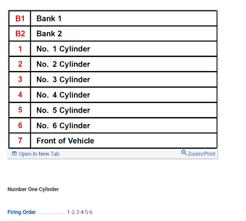

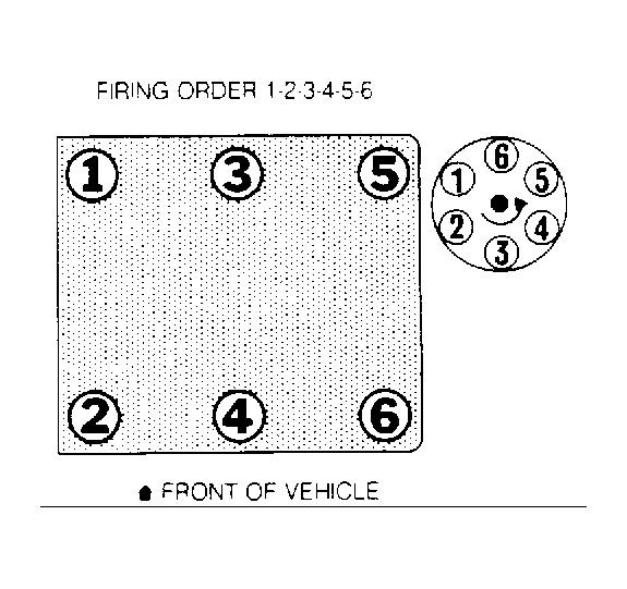

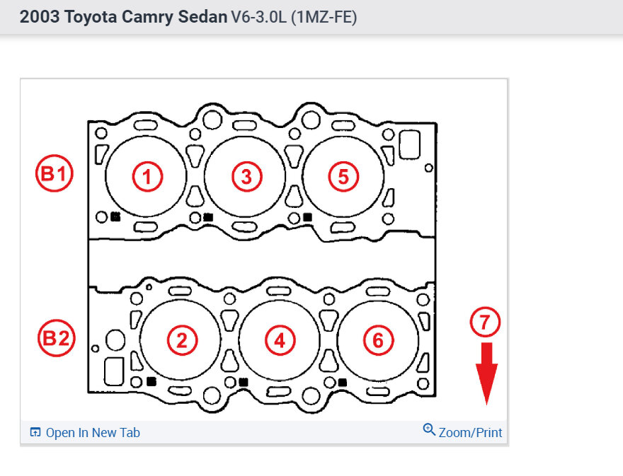

SHADIZAR
Engine Performance problem
1991 Toyota Camry 6 cyl Front Wheel Drive Automatic
could someone please tell me the firing order for a 1991 camry v6?
  • 75,992 POSTS
https://images.2carpros.com/forum/automotive_pictures/12900_fo_144.jpg

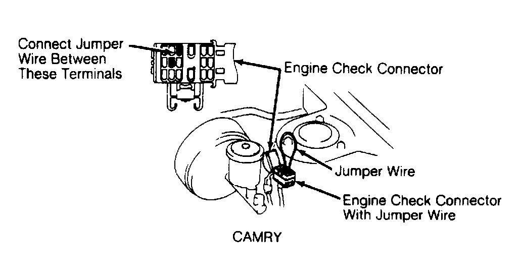

MYCARNEEDSHELP89
What is the proper timing setting for a 1989 Toyota Camry with a 3.0L V6 engine and what is the correct firing order? It is a station wagon if that makes a difference. I replaced the exhaust system from the catalytic converter to the muffler and found the timing to be ruff, I replaced the cap rotor plugs and wires with all NGK parts and it is still idling ruff.
Sep 26, 2020 at 5:51 AM (Merged)
  • 75,992 POSTS
See below for the engine firing order the timing is - Ignition timing is 10 deg BTDC Check out the diagrams (Below). Please let us know if you need anything else to get the problem fixed. Cheers
MHPAUTOS
  • 31,937 POSTS
Before you set the timing make sure that the check wire is in, see pic below.

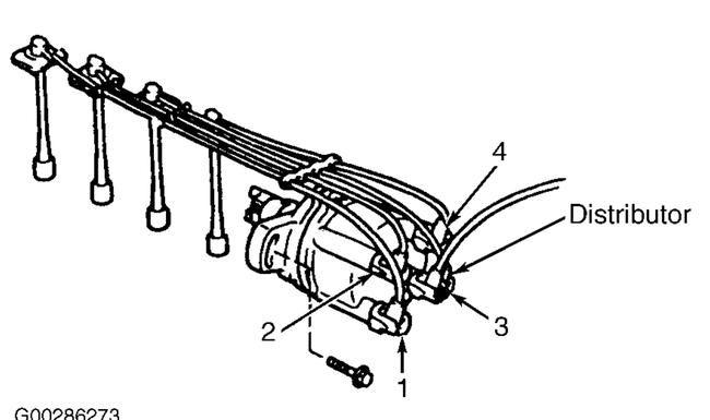

CHAPMAN06
Hi. I have a 1996 2.2L 4 cylinder. I took out the spark plug wires and forgot the replacement order.
Nov 28, 2020 at 4:11 AM
Attached is the firing order for the 2.2L. Let us know if you need more info. Thanks
