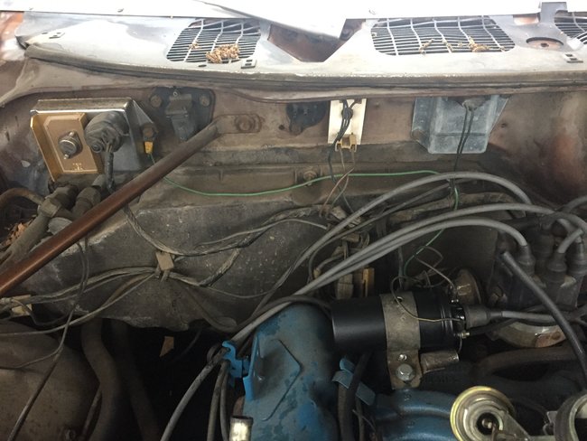

I did not. I was able to get her to fire just by turning the key so I could check the ballast. What am I looking for in the "wiggle" test?

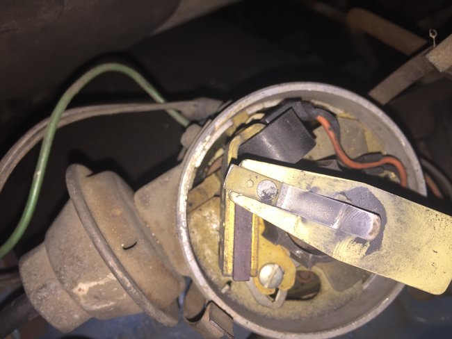

And it is a single coil. It has a little bit of play but does not seam overly loose.

The dual ballast resistor has a white two-wire connector on each end, (They can only be plugged in one way, but either plug can go on either end). One has two dark blue wires in it. Those are the two plugs to wiggle. Bad connections are not common, but we don't want to overlook the possibility.

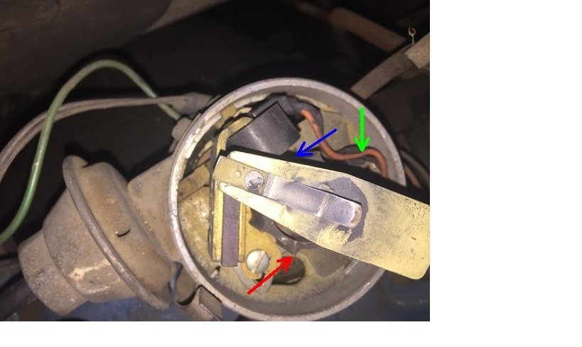

The green arrow on your dandy photo shows where the wires for the pickup coil flex repeatedly. An intermittent connection there can cause intermittent stalling, but usually at a higher road speed, like 35 - 40 mph or more.
My nifty red arrow is pointing to one of the eight points on the "reluctor". It passes a magnet on the pickup coil under the rotor by the blue arrow. If the pickup coil was worked on recently, the air gap is critical. You must use a brass feeler gauge because a regular steel one will stick to the magnet and give a false feel. As I recall from my '78 LeBaron, the gap was supposed to be 0.018", but in later years I remember reading specs of 0.008" and 0.012". Regardless, the gap is tight enough that it could be adversely affected by worn bushings causing the distributor shaft to wobble.
