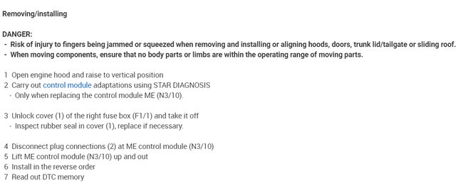

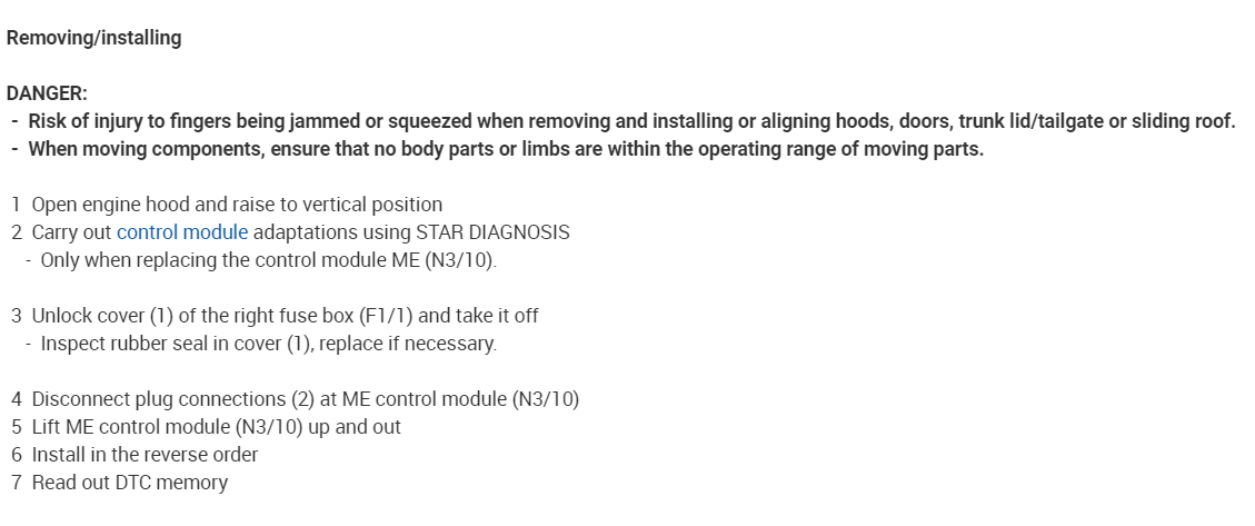

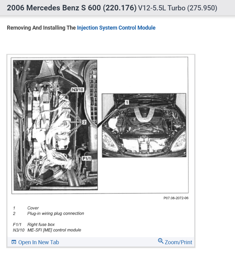

Here are instruction on how to replace the ECU in case this ends up being the issue. Check out the diagrams (below). Please let us know what you find. We are interested to see what it is.

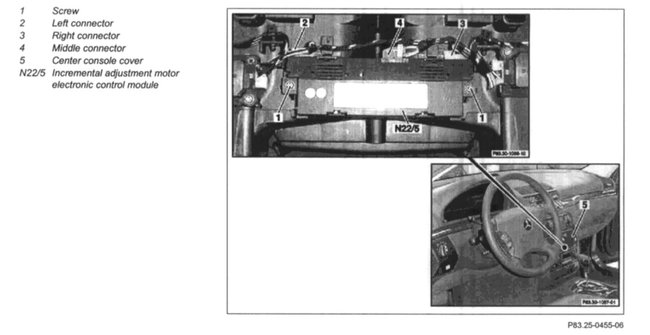

I have unhooked the ECU and still Battey drains over night. One thing I found is I can hear a click in the rear heater control valve switching every 10-15 seconds long after the car is off. What is connected to this valve that tells it to energize the coils?

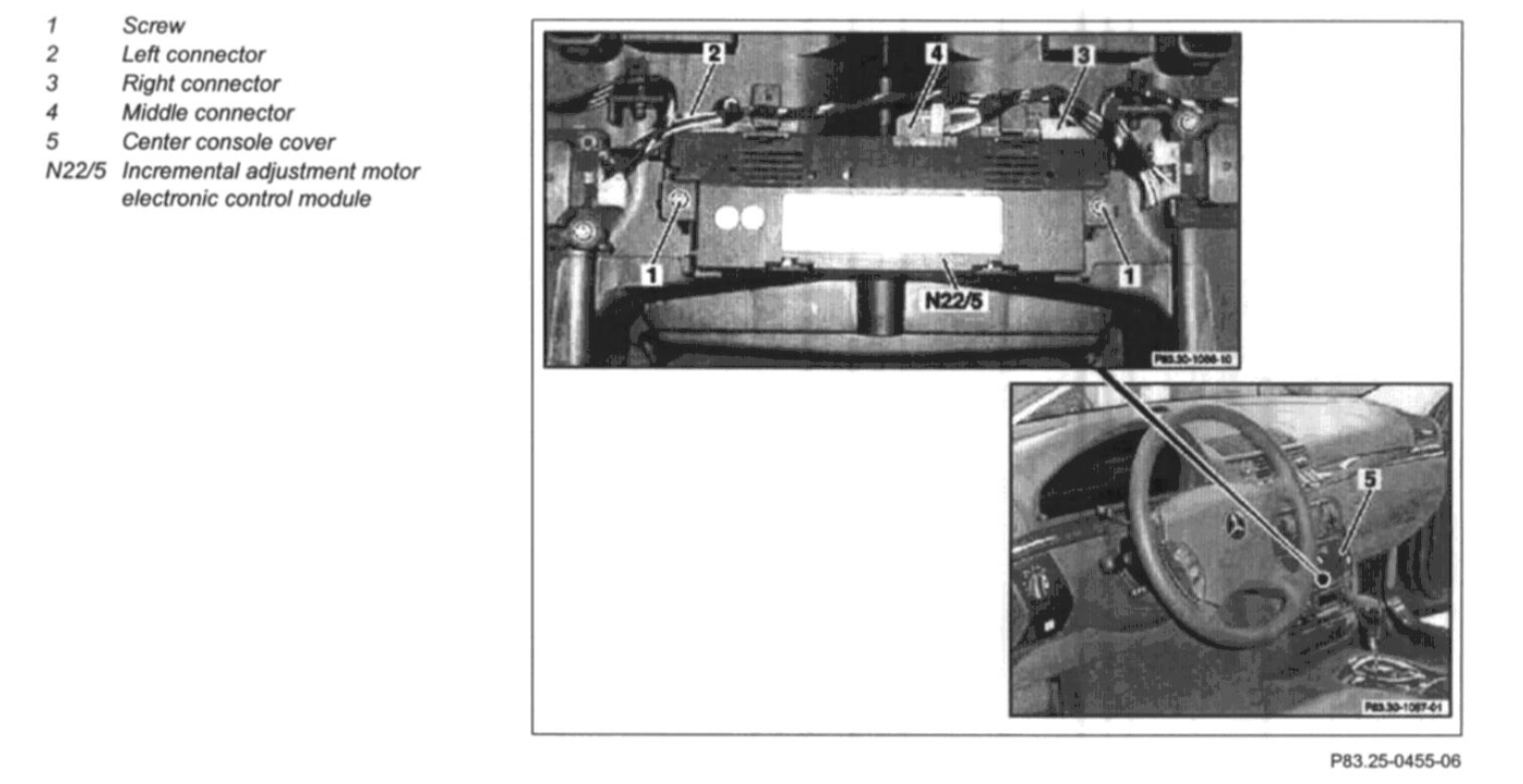

This would be the HVAC controller lets try unplugging it to see if the battery drain goes away. this guide may help as well:
https://www.2carpros.com/articles/car-battery-dead-overnight
1 Remove cover from center console (5)
2 Disconnect connectors (2, 3 and 4)
NOTE: Connection and disconnection aid.
3 Unscrew screws (1)
4 Remove incremental adjustment motor electronic control module (N22/5)
5 Install in opposite order.
6 Synchronize incremental adjustment motors.
