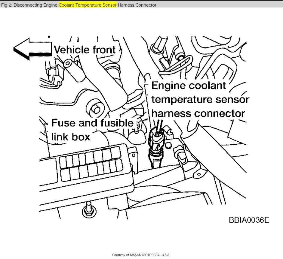

My car temperature is sometimes fluctuate up and down on highway speed 100 km/h. I changed the thermostat before original it was okay, but after one month same problem appeared again. I changed the radiator cap and while touching the hose upper and lower they do not seems to be that hot. I measured it with gun showing 85c but gauge shows higher then 85c.

Keep in mind though that the temperature sensor is located at a different location from where the hoses are and is usually screwed into the engine block or intake manifold or head where the engine coolant is located on the side of the thermostat that would be on the side before the thermostat opens.

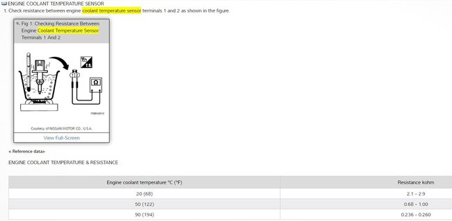

If the engine temperature and coolant is not actually fluctuating then it might just be a loose electrical connection to/from the coolant temperature sensor or the gauge and/or a faulty temperature sensor or gauge. I would move your temperature gun to where the temperature sensor is and see if you can get a reading there and compare it to the gauge and if it is not the same or close start diagnosing if it is a faulty wire. So try wiggling the wires and see if the gauge fluctuates and if not try a new temperature sensor. Maybe even read the trouble codes and see if the computer has picked up a code for the voltage on that temperature sensor circuit.
Here is a test of the ect sensor on the kitchen stove boiling a pot of water.
The code for it is a P0117 or P0118.

Both of the cooling fans work properly. I did checked just the temperature of car is bouncing up in second and coming down in second even if the fan will not work. the car temperature will not bounce quickly straight 20c ahead of 82c thermostat and then bouncing down quickly. This car's thermostat is at lower hose. No cts at engine head there are two sensor on upper radiator hose. I think one is cts and other is cluster gauge sensor and in computer no fault found. The fan I checked at idle without A/C both fan runs automatically on right temperature and shut off at right temperature.
