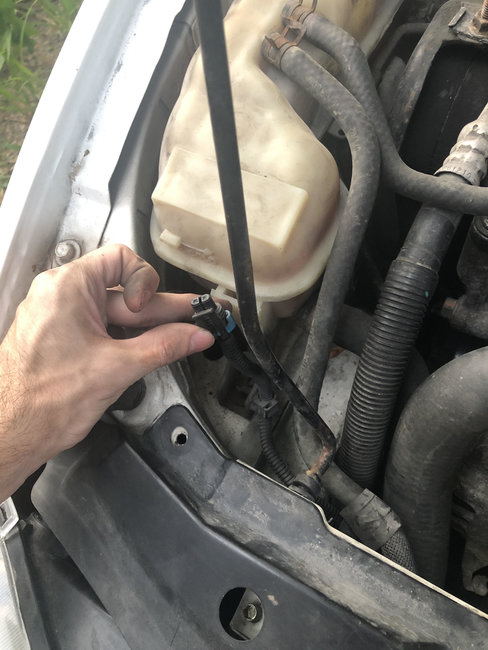

Running into an issue where the A/C is stuck on defrost mode and was told to check for a vacuum hose leak in my car.
I found this thing that isn't plugged into anything but don't see anywhere to plug it in... any ideas?

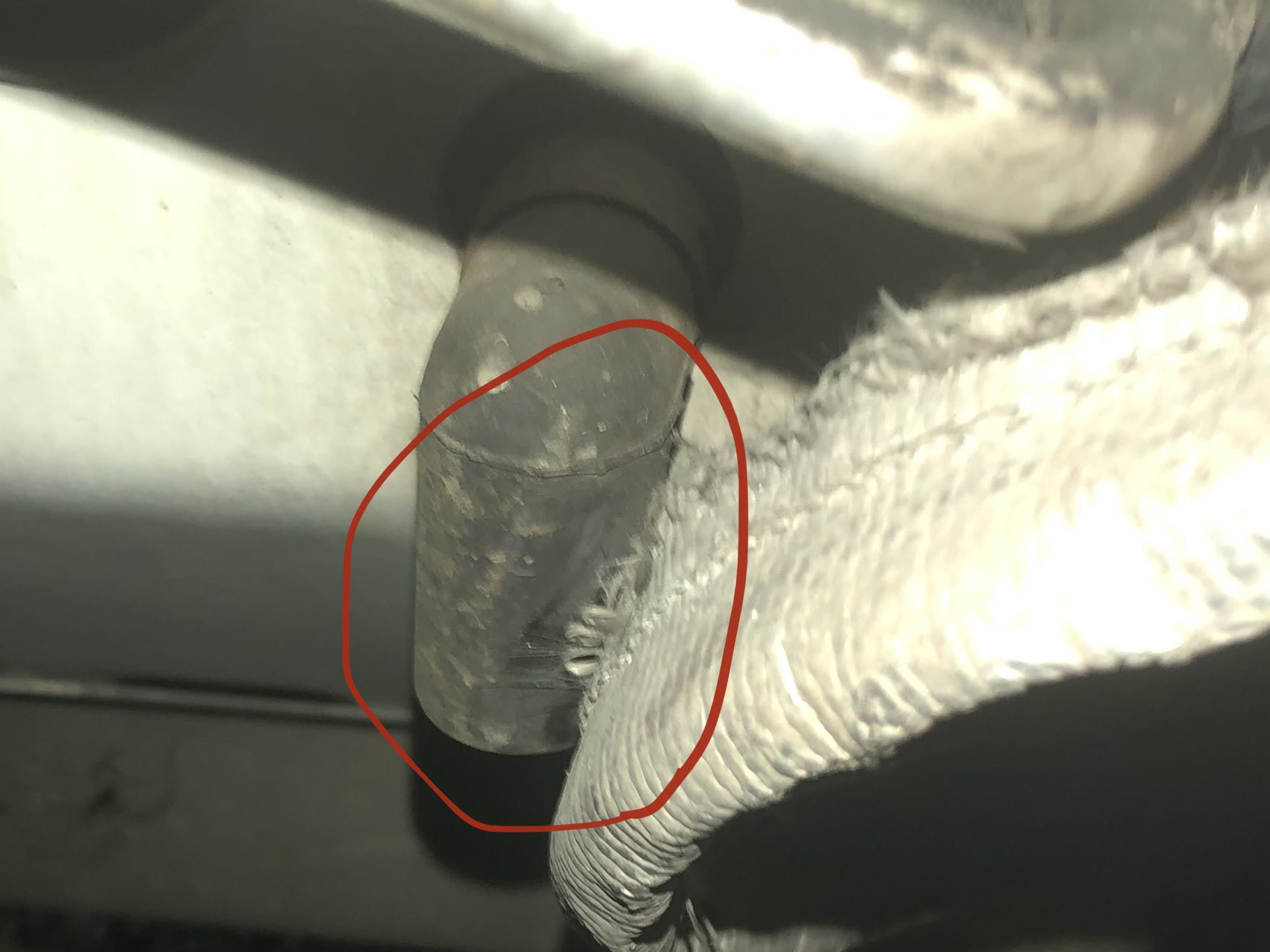

Also, I don't see any hose connected in the second picture, back by the fire wall???

Pic 1 is an electrical connector and pic 2 is the A/C drain.

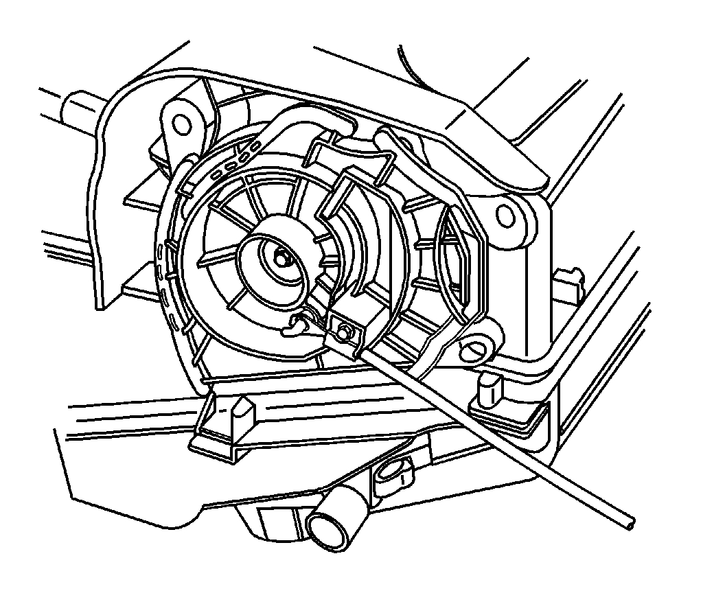

The mode door is what controls air flow direction. I looked it up and found that this one is controlled by a cable. Take a look at these directions for removal and replacement of the cable. Check the cable shown and see if it is disconnected or broken.
Take a look at this link for a better description and what to do when it is stuck in defrost mode:
https://www.2carpros.com/articles/air-vents-stay-in-the-defrost-position

2003 Chevrolet Cavalier L4-2.2L VIN F
Mode Control Cable Replacement
Vehicle Heating and Air Conditioning Air Door Air Door Cable Service and Repair Procedures Mode Control Cable Replacement

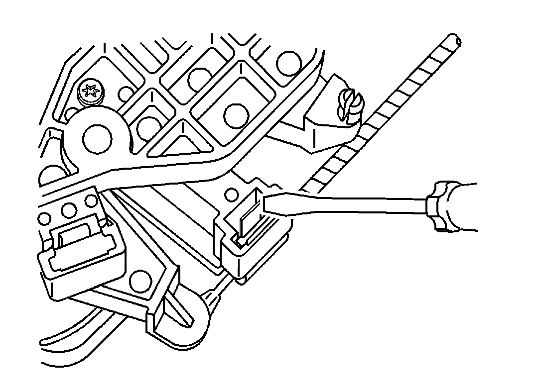

MODE CONTROL CABLE REPLACEMENT
REMOVAL PROCEDURE
pic 1
1. Remove the I/P trim plate.
2. Disconnect the mode control cable from the mode door lever.
3. Remove the cable flag retaining screw.

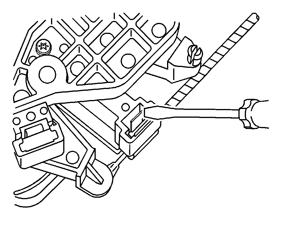

4. Remove the HVAC control assembly.
5. Release the flag from the mode base using the release tab.
pic 2
6. Remove the flag.
7. Remove the cable end form from the lever post.
8. Remove the temperature control cable.

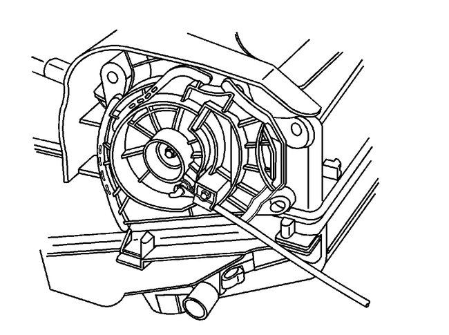

INSTALLATION PROCEDURE

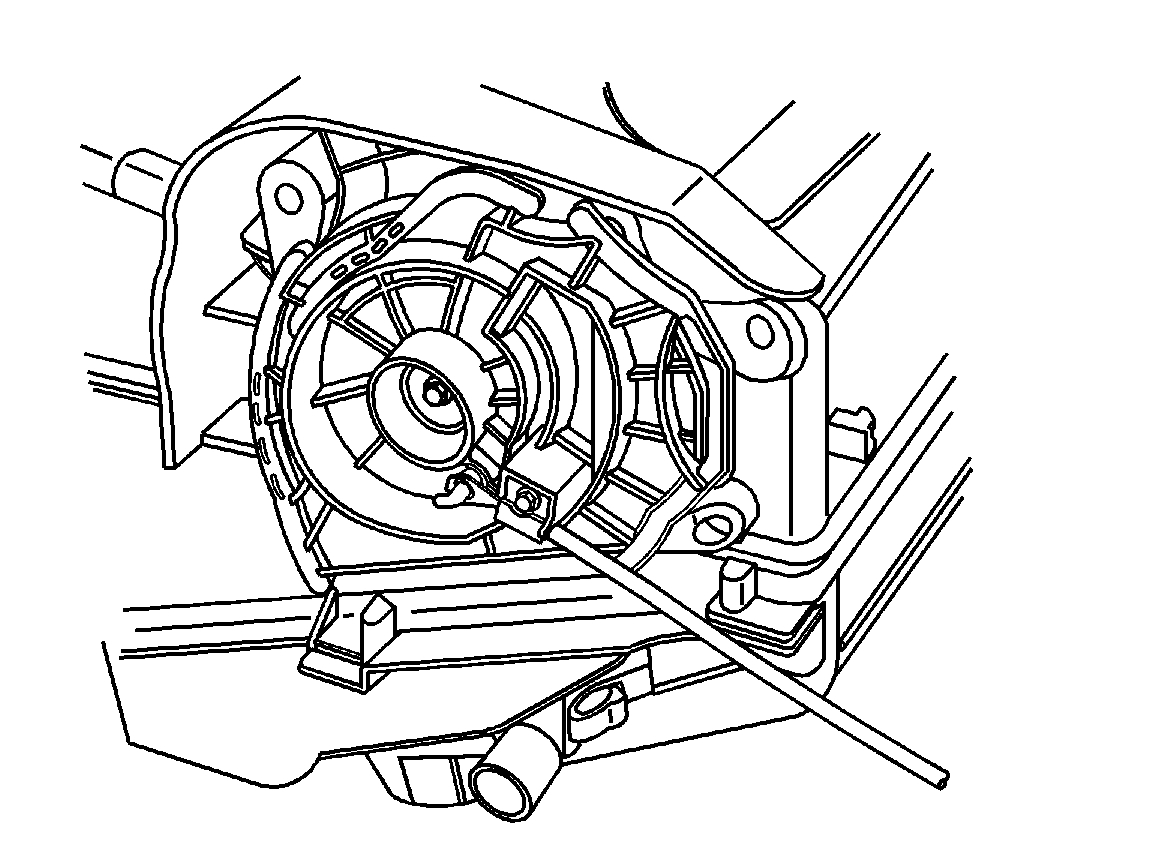

pic 3
1. Install the mode control cable to the HVAC control assembly.
2. Snap the flag into the mode base.
3. Snap the cable end form over the lever post.

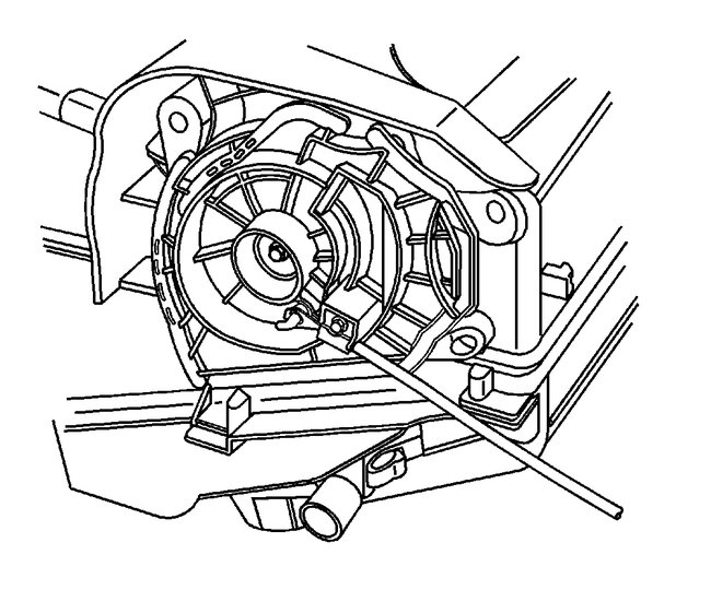

pic 4
4. Install the cable to the mode door lever/cam.
5. Install the cable flag and screw to the HVAC module assembly.
NOTE: Refer to Fastener Notice in Service Precautions.
Tighten
Tighten the screw to 2 N.m (18 lb in).
6. Install the HVAC control assembly.
7. Install the I/P trim plate.

Discovered that connector actually plugs in underneath the coolant reservoir.

Took forever but I got the cable off! That was the issue, it's extremely worn and bent at one end. In fact, it wasn't even hooked around the post!
