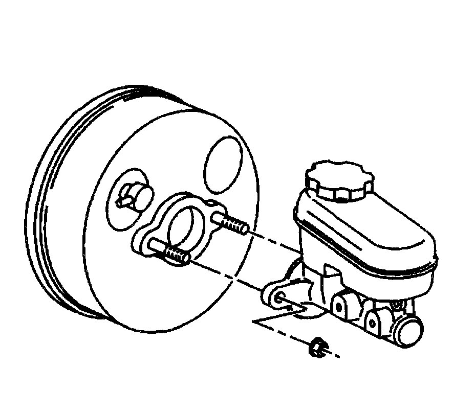

I put my foot on the brake to start the car as soon as the car starts the pedal goes to the floor. I can pump it up but it always gets soft. No leaks I can see, just put new rotors and pads on it. takes more pressure to stop the car than ever before. I think it's the master cylinder. but the pedal does not go down when the car Isn't running. Thanks, Tom
Aug 27, 2020 at 8:43 AM
  • 110,251 POSTS
Tom, chances are the master cylinder is bad. When the vehicle starts, you get a vacuum assist from the brake booster which makes it much easier to press the brakes. Try this. With the engine off, press the brake pedal and keep pressure on it for a bit. See if it slowly starts to go down.

Since there are no leaks, what I feel is happening is the brake fluid is bypassing the plungers in the master cylinder. It is just much more noticeable when the engine is running.

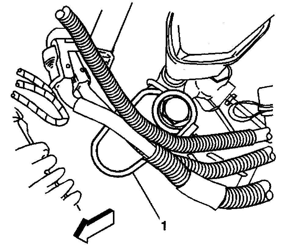

1. Disconnect the electrical connector from the brake fluid level sensor.
2. If you are performing repairs on a 3.4L, non ABS Impala, it is necessary to remove the bracket (1) from the master cylinder.
3. Disconnect the brake pipes from the master cylinder.
Important: Install a rubber cap or plug to the exposed brake pipe fitting ends in order to prevent brake fluid loss and contamination.
4. Plug the open brake pipe ends.
pic 2
5. Remove master cylinder mounting nuts.
6. Remove the master cylinder from the vehicle.
7. Drain the master cylinder reservoir of all brake fluid.

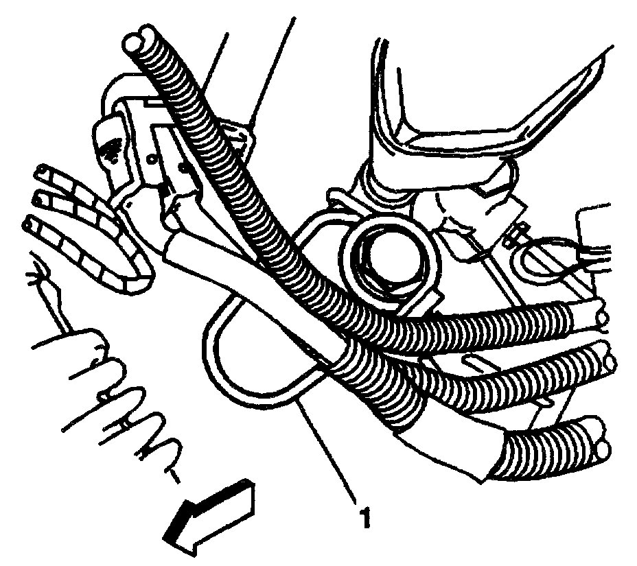

Installation Procedure
pic 3
1. Bench bleed the master cylinder.
2. Install the master cylinder to the vacuum brake booster.
Notice: Refer to Fastener Notice in Service Precautions.
3. Install the master cylinder mounting nuts.
^ Tighten the master cylinder mounting nuts to 25 Nm (18 ft. lbs.).

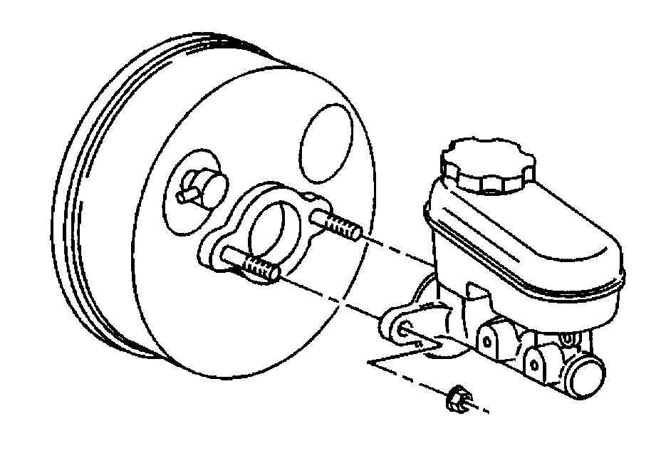

pic 4
6. If you are performing repairs on a 3.4L, non ABS Impala, it is necessary to install the bracket (1) to the master cylinder.
7. Connect the electrical connector to the brake fluid level sensor.
8. Bleed the brake system.
