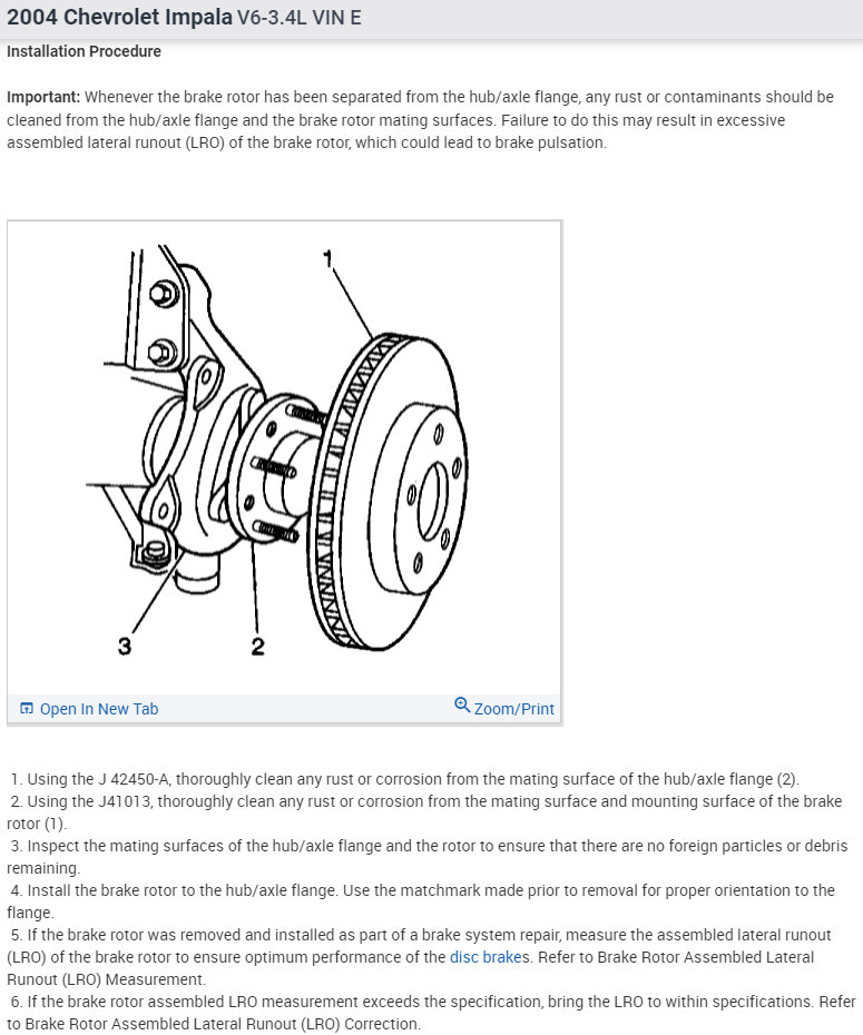

One of the causes of excess lateral run out is foreign material between mating surfaces of rotor, hub, and wheel (fig. 6). These include debris, corrosion, flaking and grease.
You need to obtain clean metal-to-metal contact to get repeatable results. Pits aren’t so much of a problem as raised surfaces.
Clean rotor to hub mating surfaces using J-42450 Wheel Hub Resurfacing Kit. The configuration of the tool permits it to fit over the mounting stud, to remove corrosion that cannot be reached by other methods (filg 7).
And, 80-grit abrasive discs and holder are available in the J-41013 Wheel Hub Cleaning Kit. This is useful in cleaning mounting surfaces in general (fig. 8).

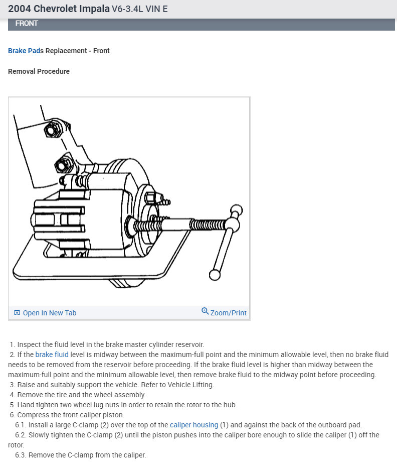

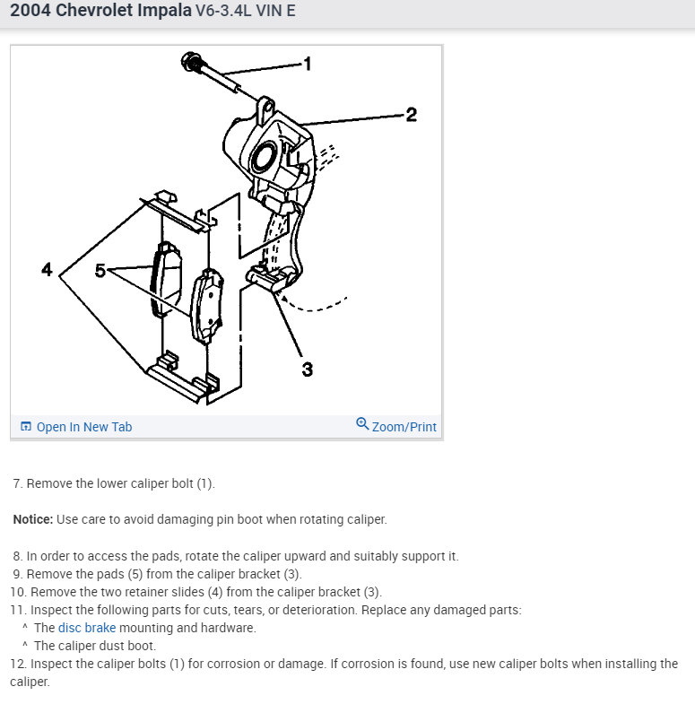

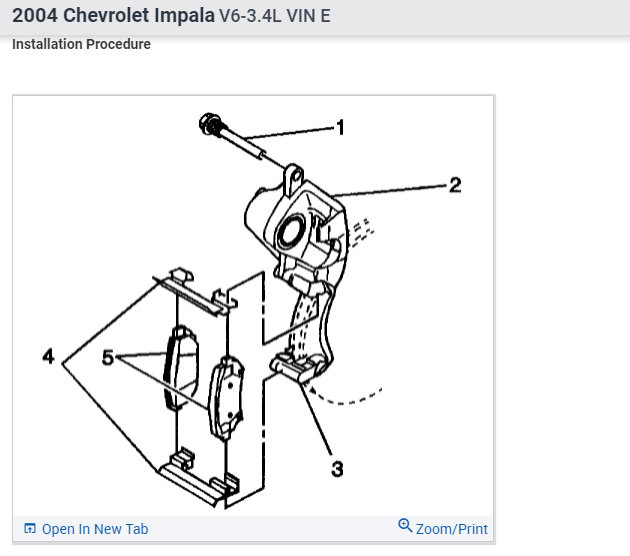

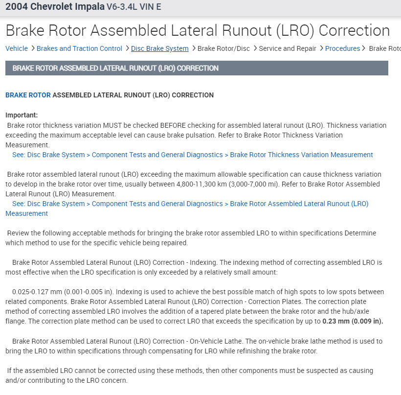

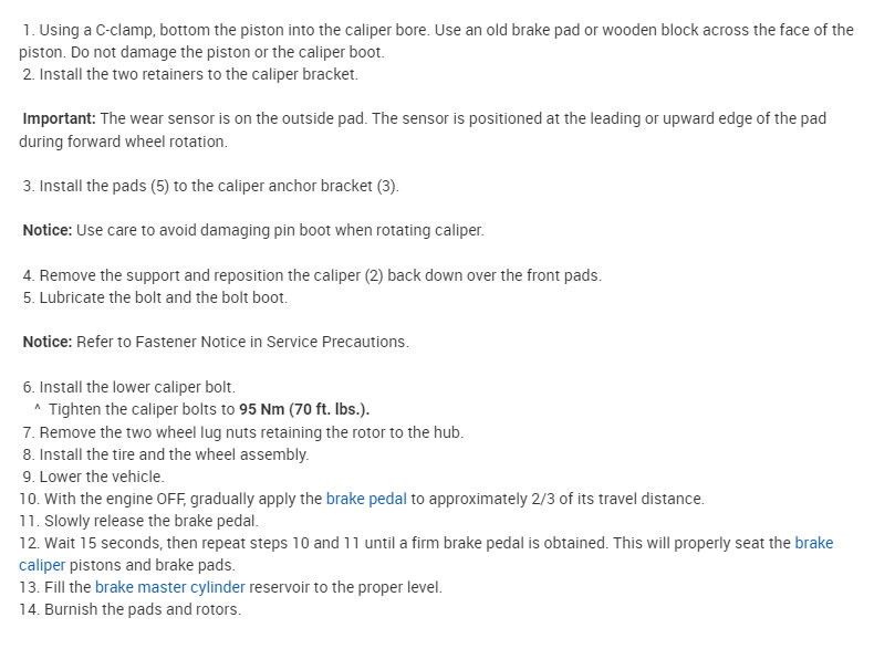

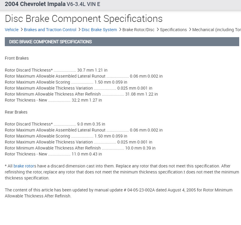

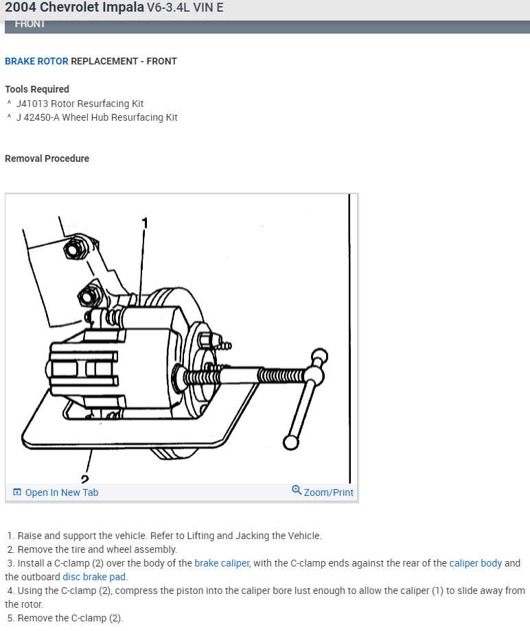

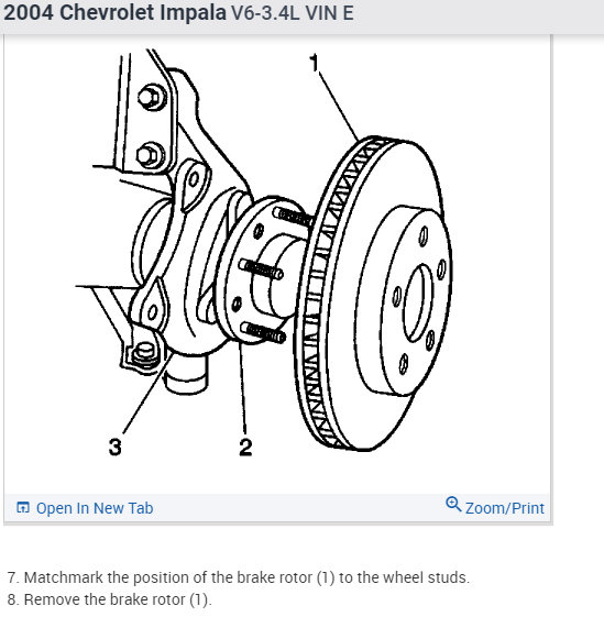

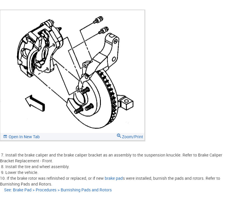

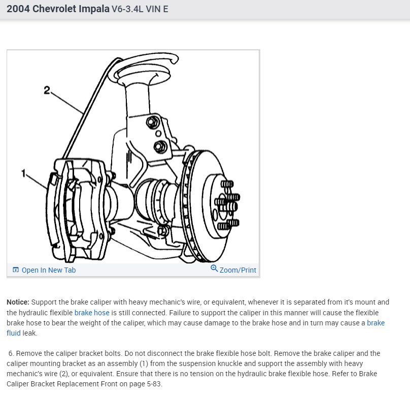

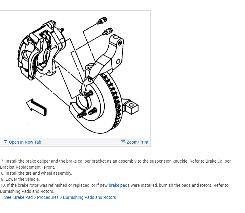

When you feel pulsation on the brake pedal, it is typically due to wrapped rotors. Depending on the quality of the replacement rotors it is possible for them to be wrapped after 10,000 miles.
Best course of action would be to perform a rotor lateral runout check. This will tell you if the rotors are wrapped. This way if they are not wrapped and the pulsation is due to another component, you are not just replacing parts.
I have attached the rotor specifications and rotor runout correction, as well as replacement procedure below.
