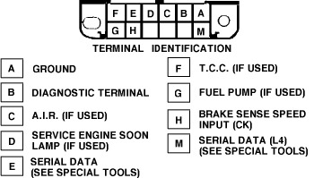

As far as checking codes, you can do that yourself. At the OBD port under the dash, use a paper clip to jump port A and B. That way you can get the codes. See the image I attached and let me know what you find.

Actually this is an obd1.5 car (as most 94 to 95 GM's are), so that trick doesn't work. I wish it did though.

There are some 1994 and 1995 models that are obd 1 but use the obd 2 style connector. Is that what you have?

Yes and the jumper wire trick will not work, sadly. Some have termed that setup as obd1.5. Has all of the disadvantages of obd1 and 2
