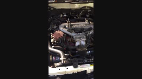

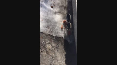

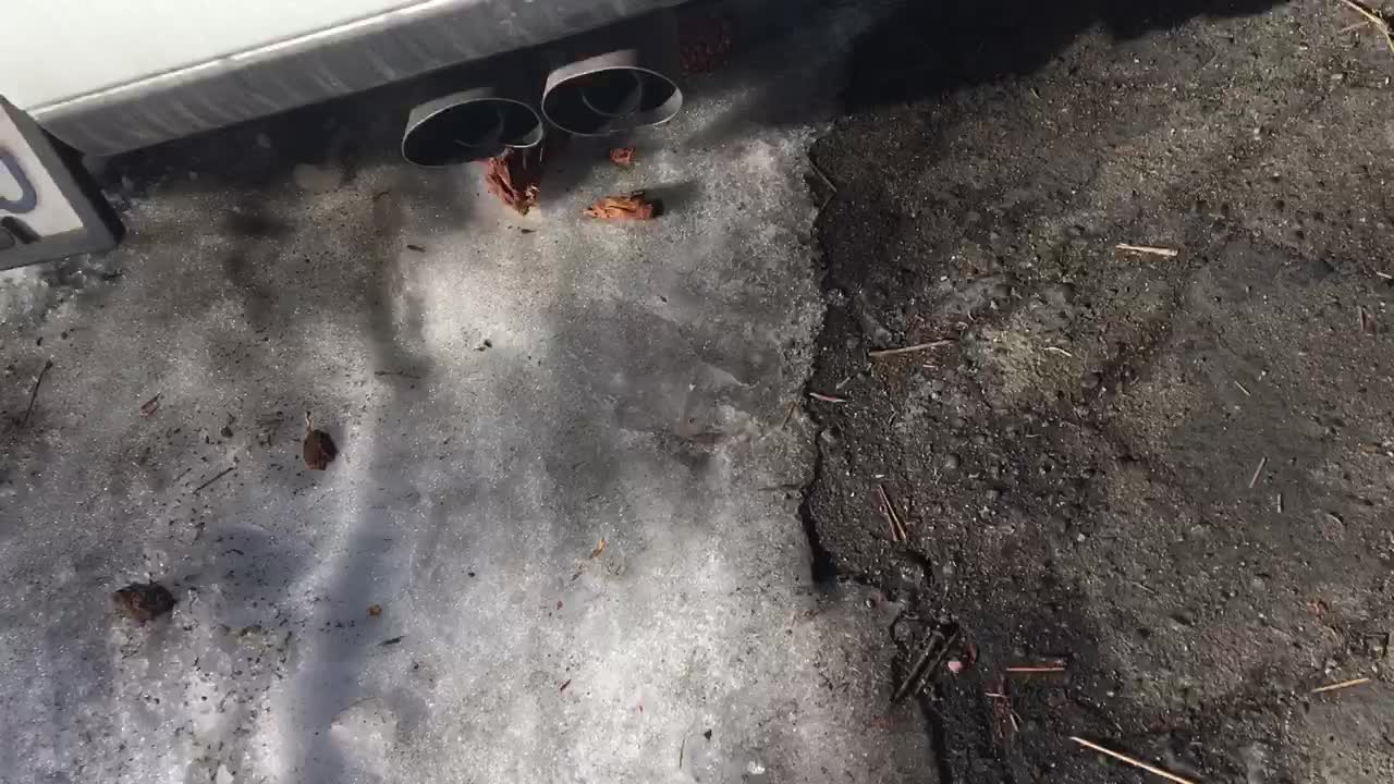

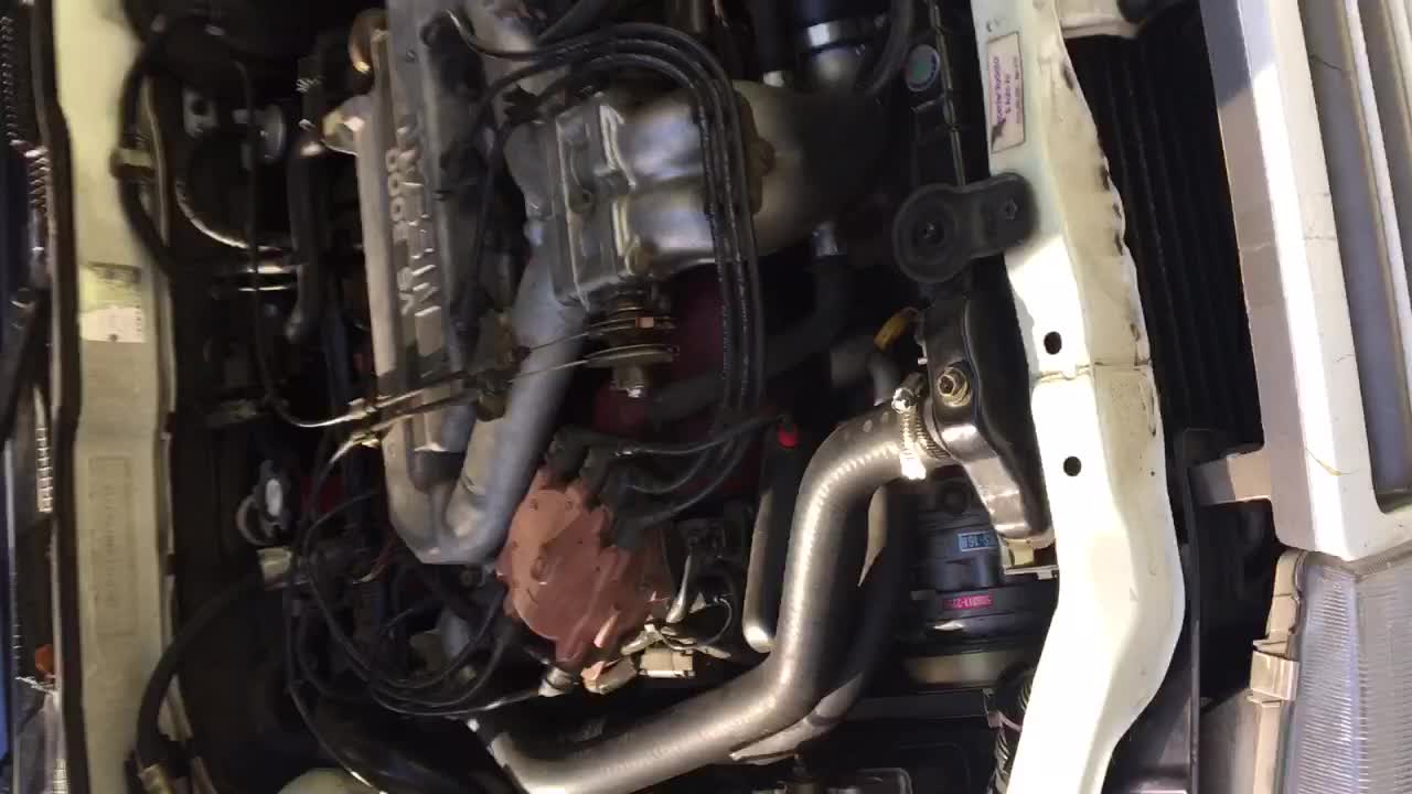

Car always smells like gas mostly on cold starts. It leaks a lot of coolant and i believe the oil is leaking too. Car runs really rough and has a loud growling sound. This car was never token care of until falling into my hands.
Engine shakes like no other.

The first thing I would do is check the fuel system for any external leaks. Raw fuel smell indicates a fuel leak.
The next thing I would do is to do a compression test to be sure the engine has the ability to produce power.
