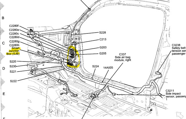

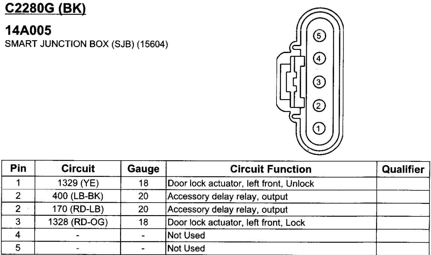

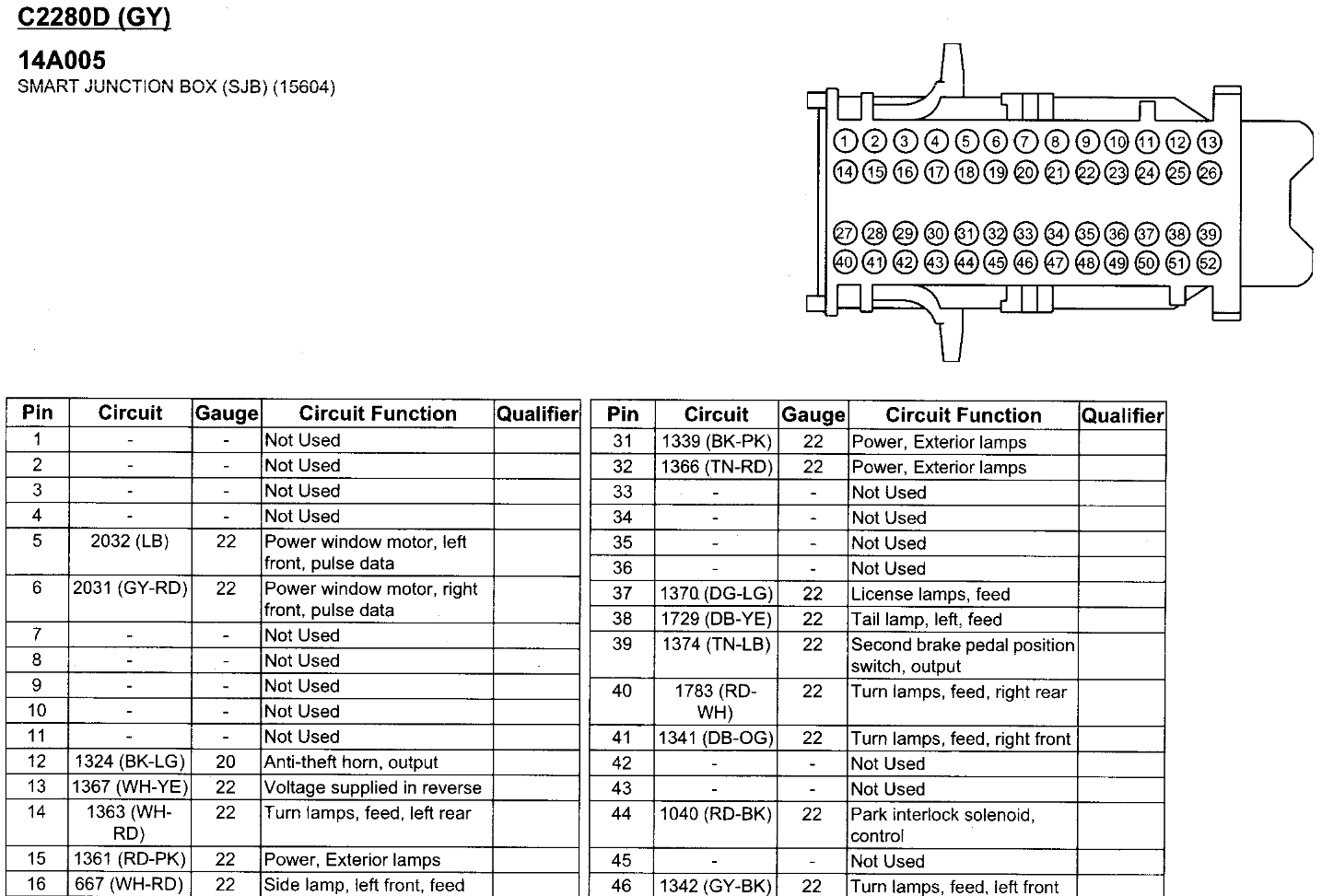

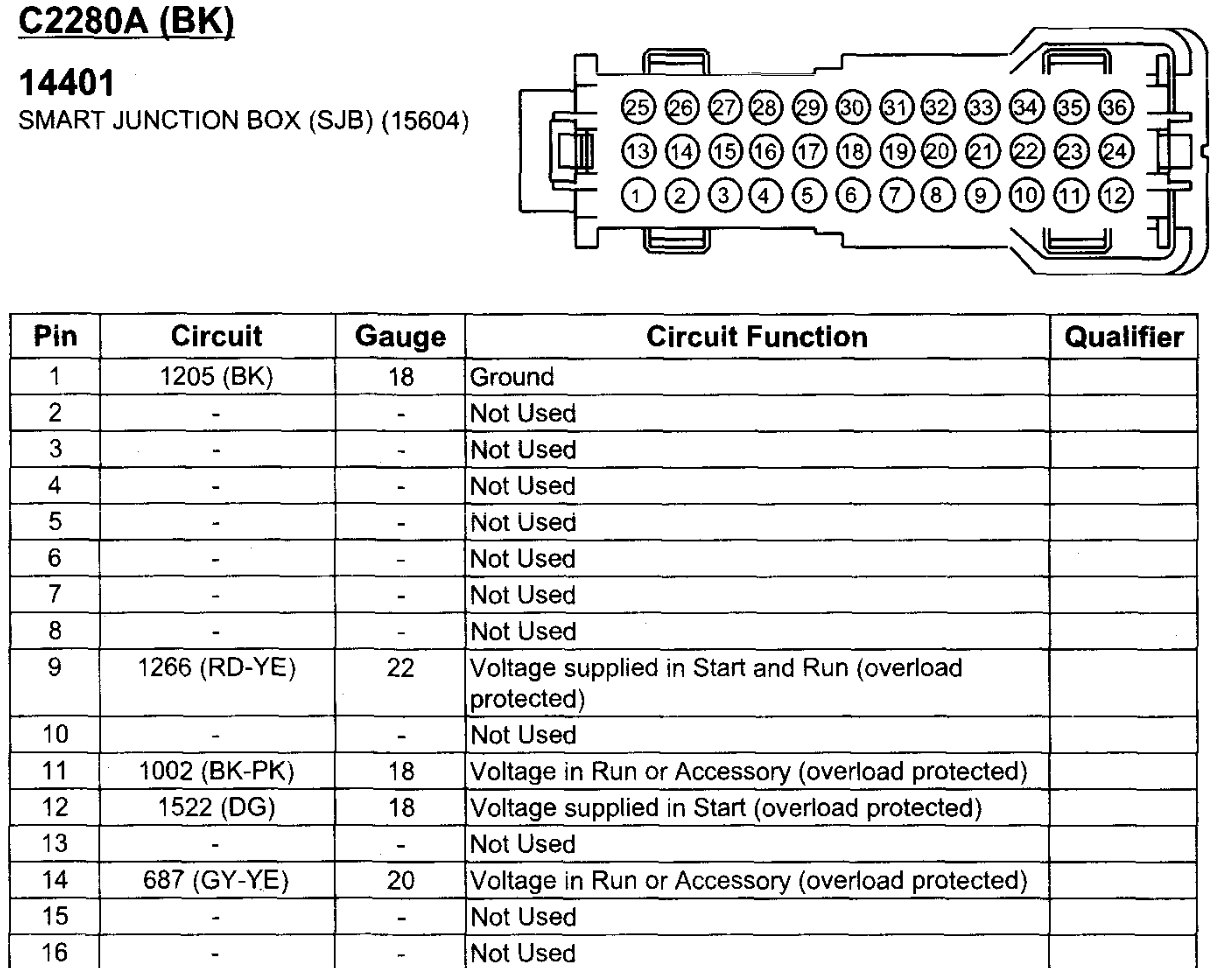

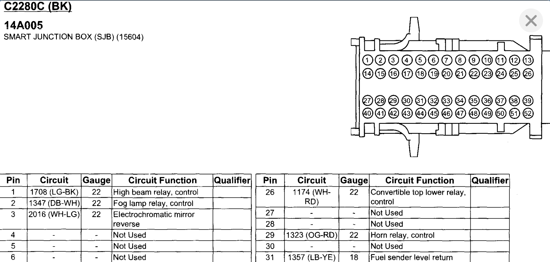

Trying to find the wiring schematics and pinouts for connectors on the sjb as well as interchangeable boxes for mine it is a 7r3t-14b476-bg and I have searched everywhere for the exact same one for over a year! Didn't know if I can get another one and program it and if so what models/revision codes I need to make sure matches???
Apr 24, 2023 at 5:43 PM
AL514
  • 5,639 POSTS

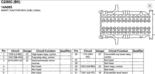

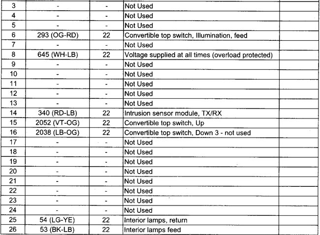

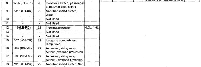

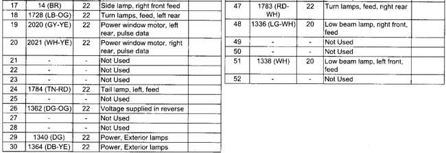

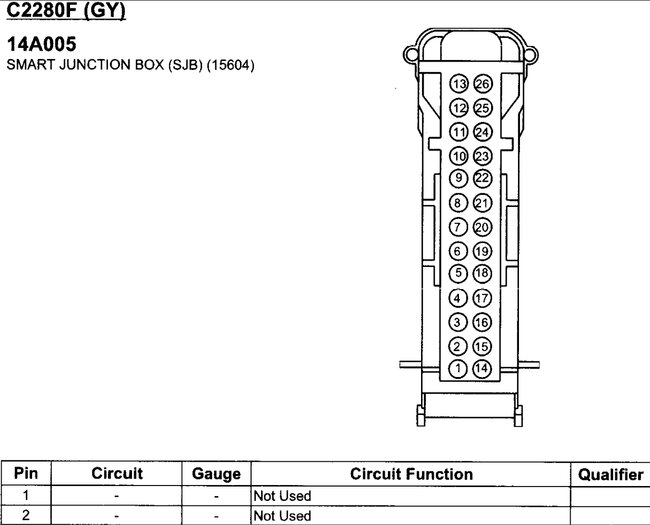

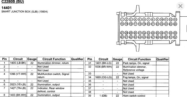

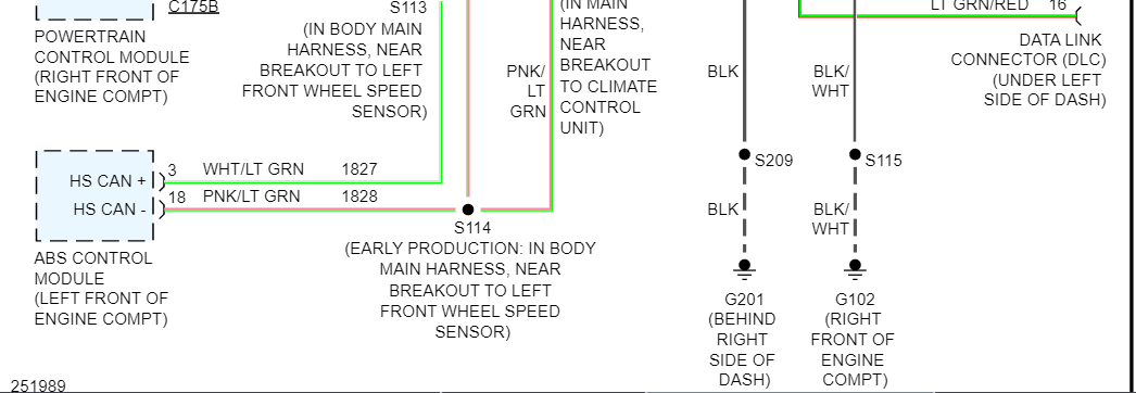

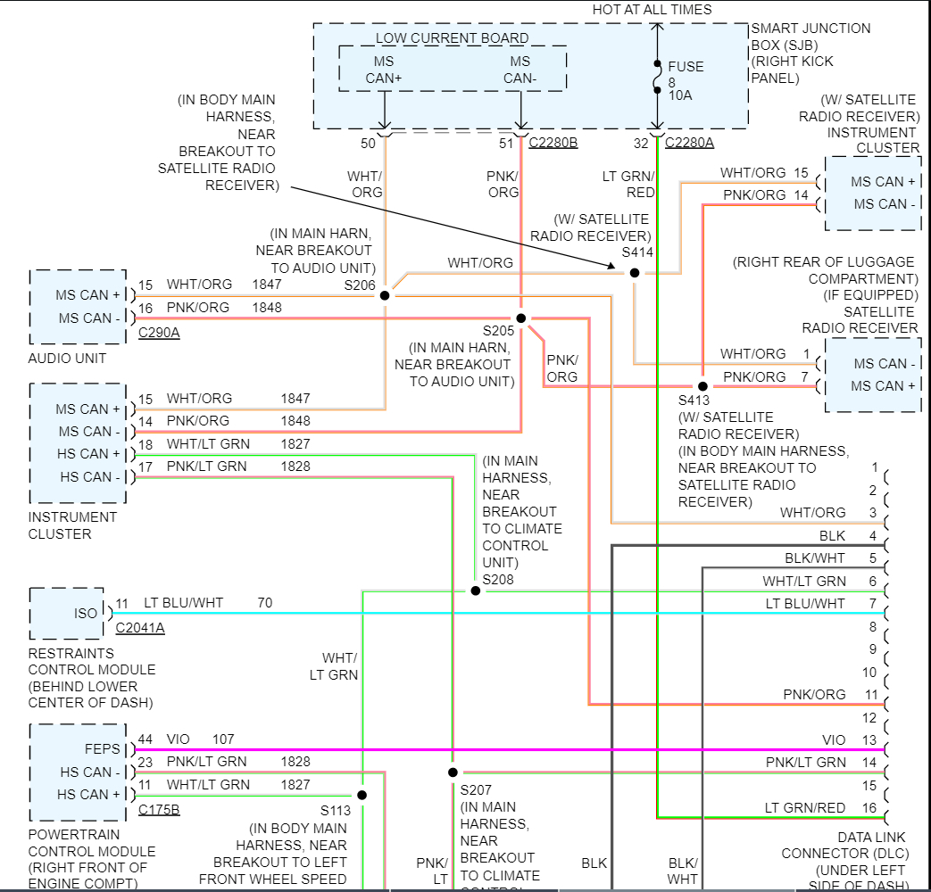

Hello, we do have access to the connector diagrams and pinouts, it looks like there are 8 connectors for this module, labelled as a Smart Junction box, but it's really a BCM. Going through the diagrams, this thing looks to control much of the vehicle and communicates on the medium speed CAN bus network. I don't see a part number listed anywhere, even just doing some random searches for used modules, I haven't seen your particular part number yet. But what type of issue are you having with this module? The list of DTCs is a mile long because they are all listed per system. Or are you having a No Communication with the module? I'll get the connector diagrams ready for you, but if it's a certain specific issue maybe we can help you figure out what is going on. Since this looks to have the security system integrated into it, programming can get complicated sometimes. But let's start with what issue is going on.

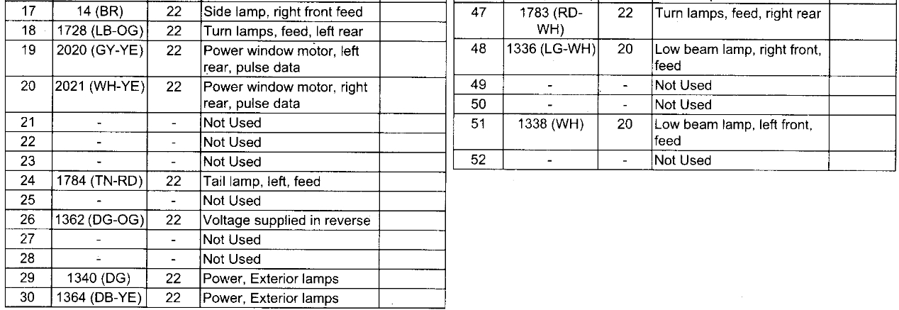

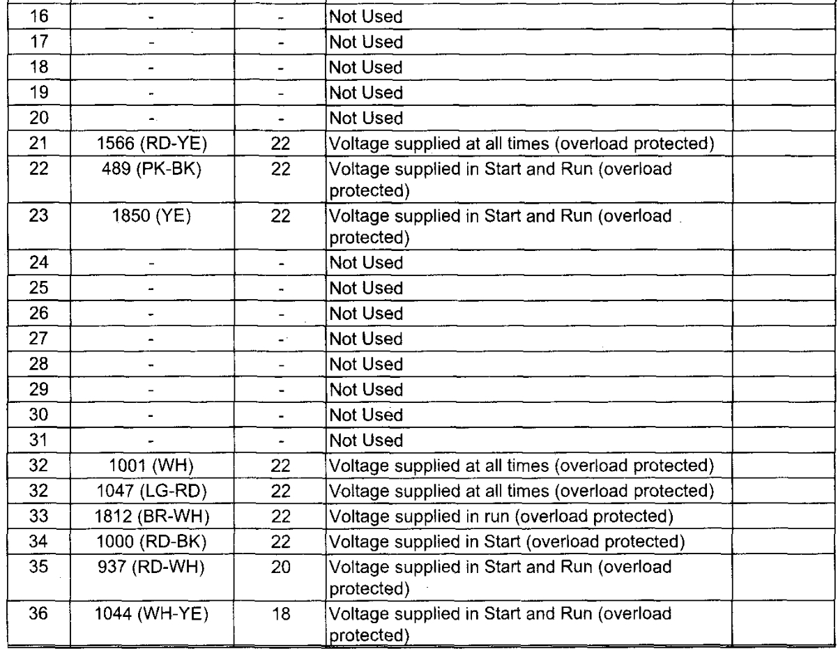

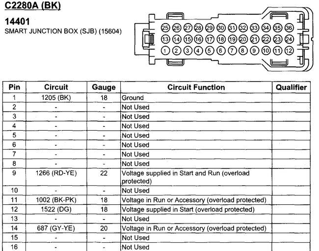

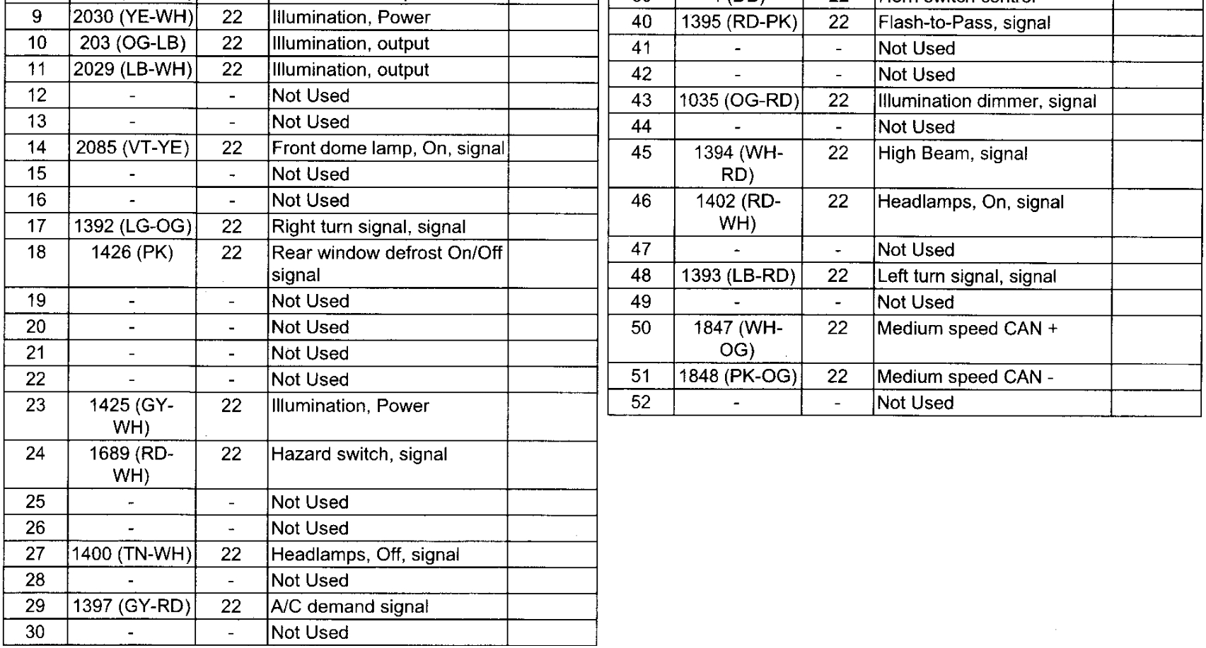

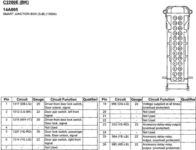

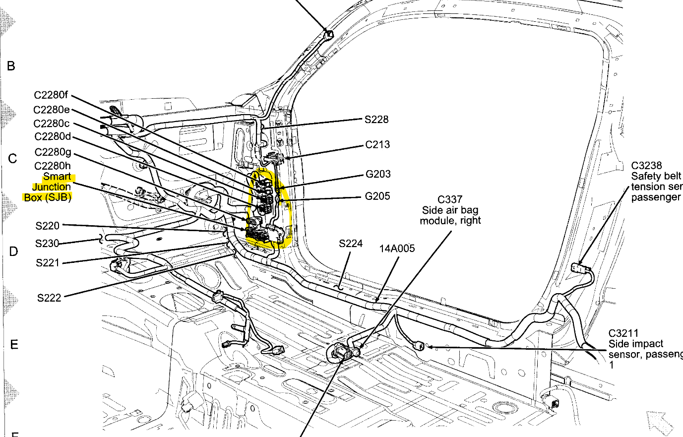

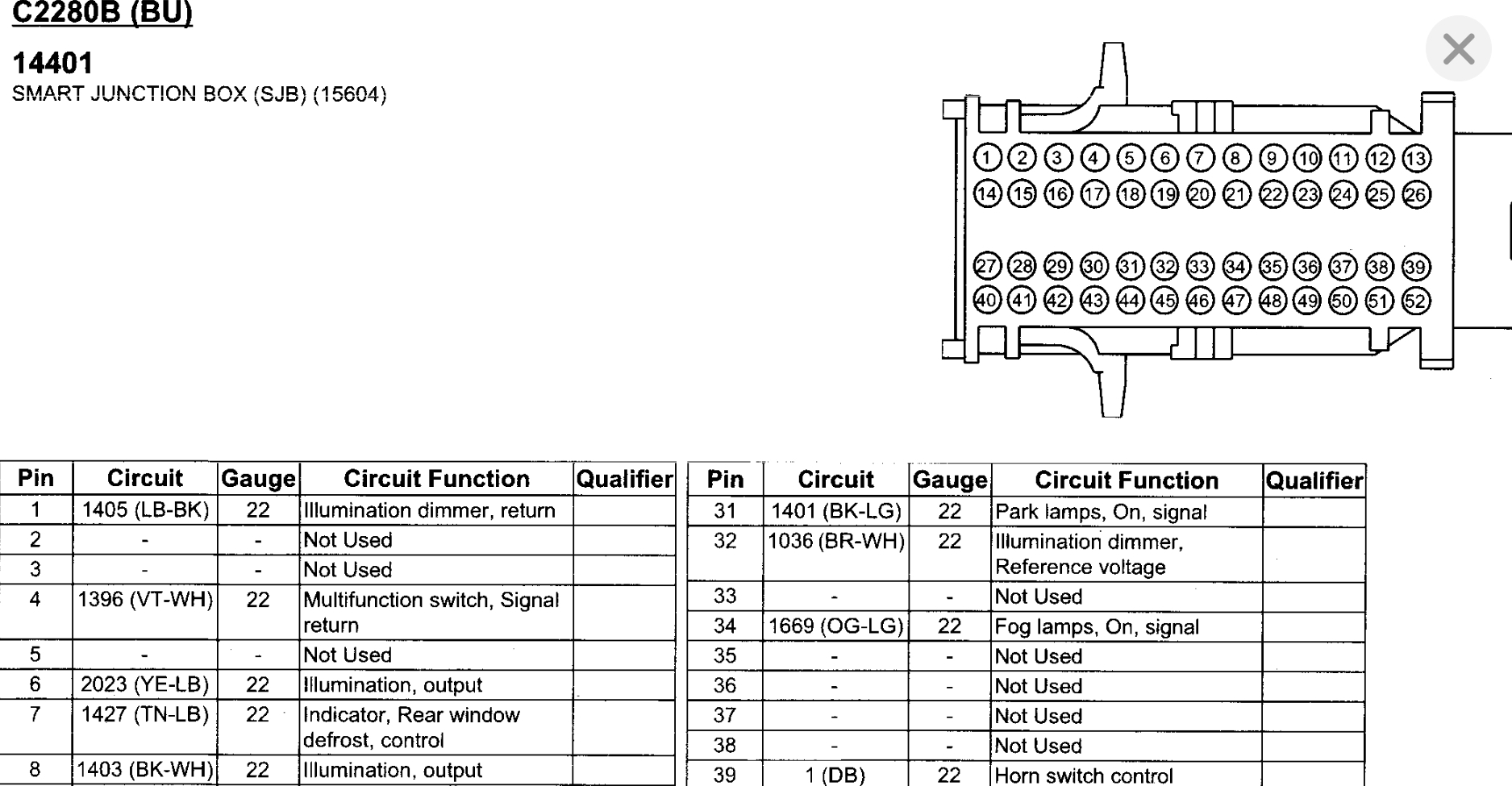

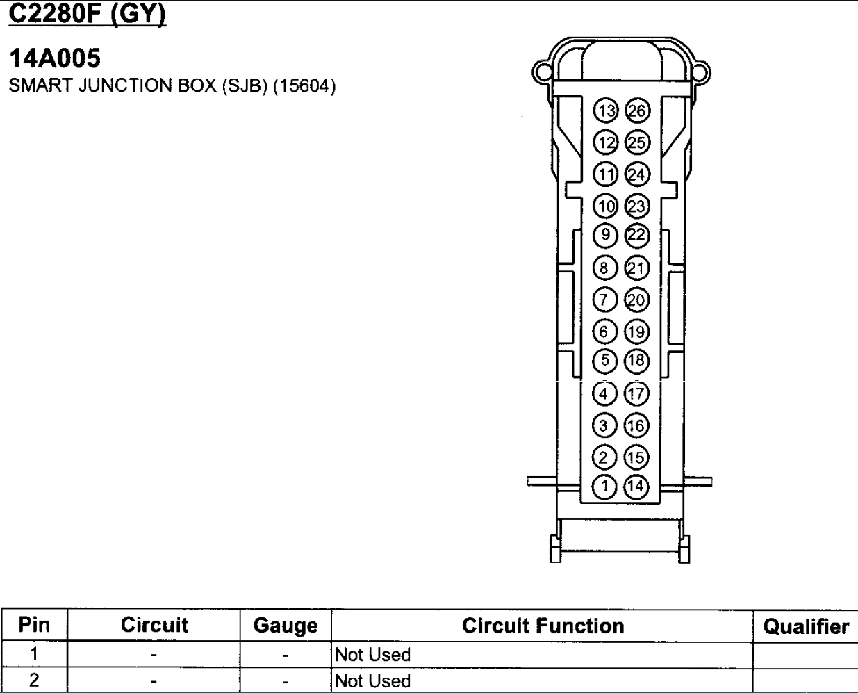

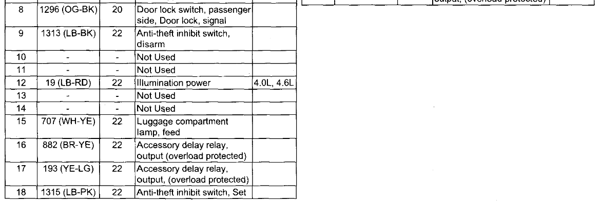

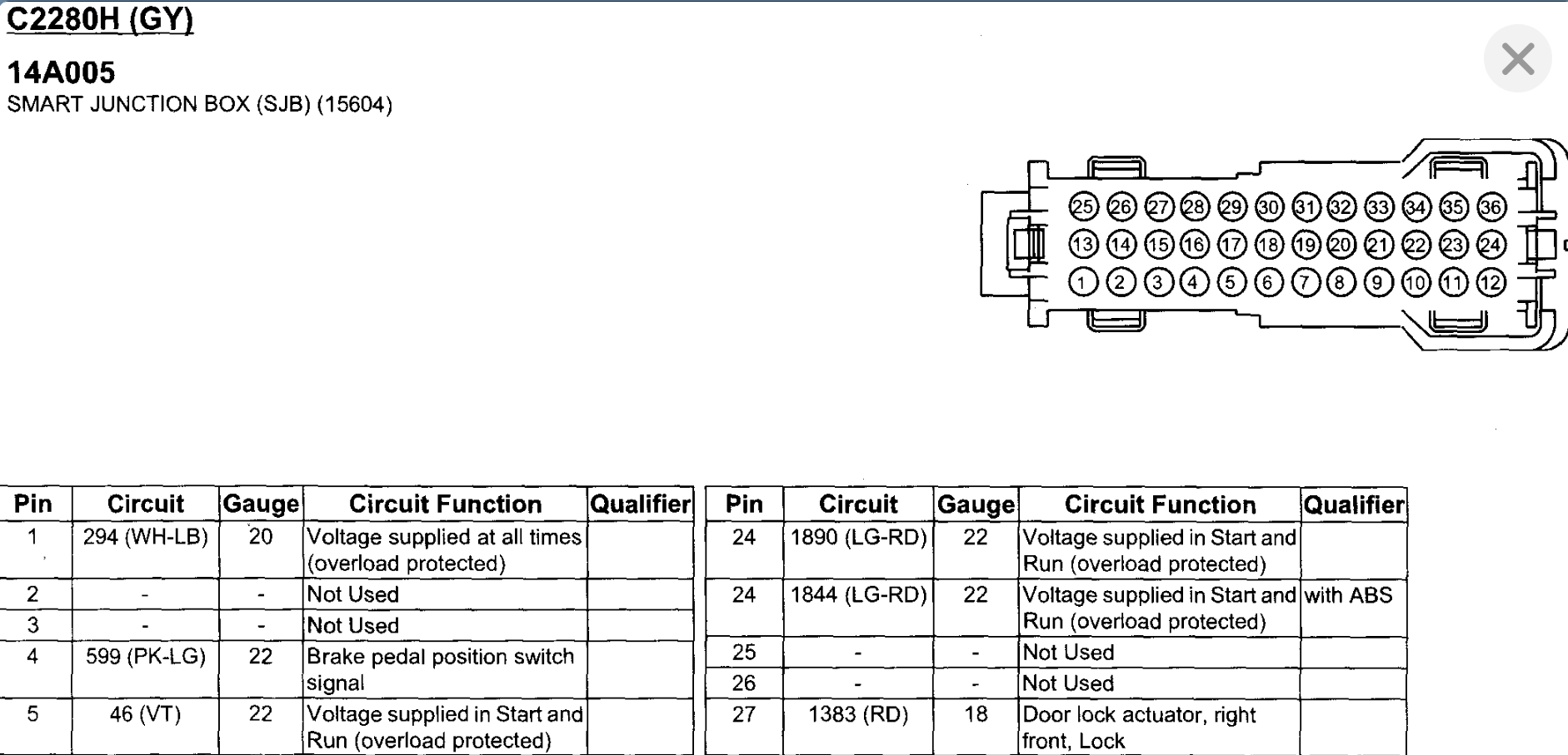

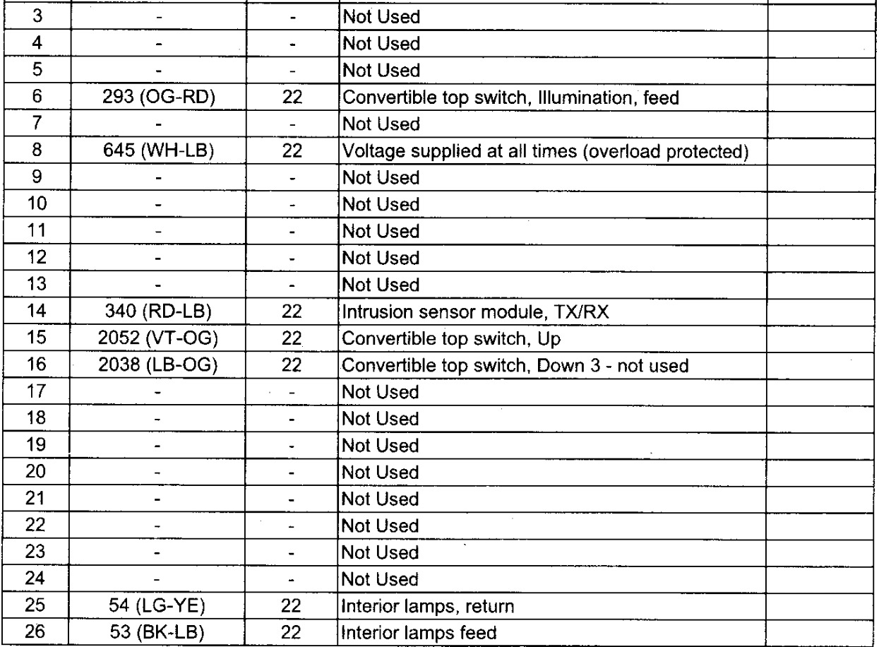

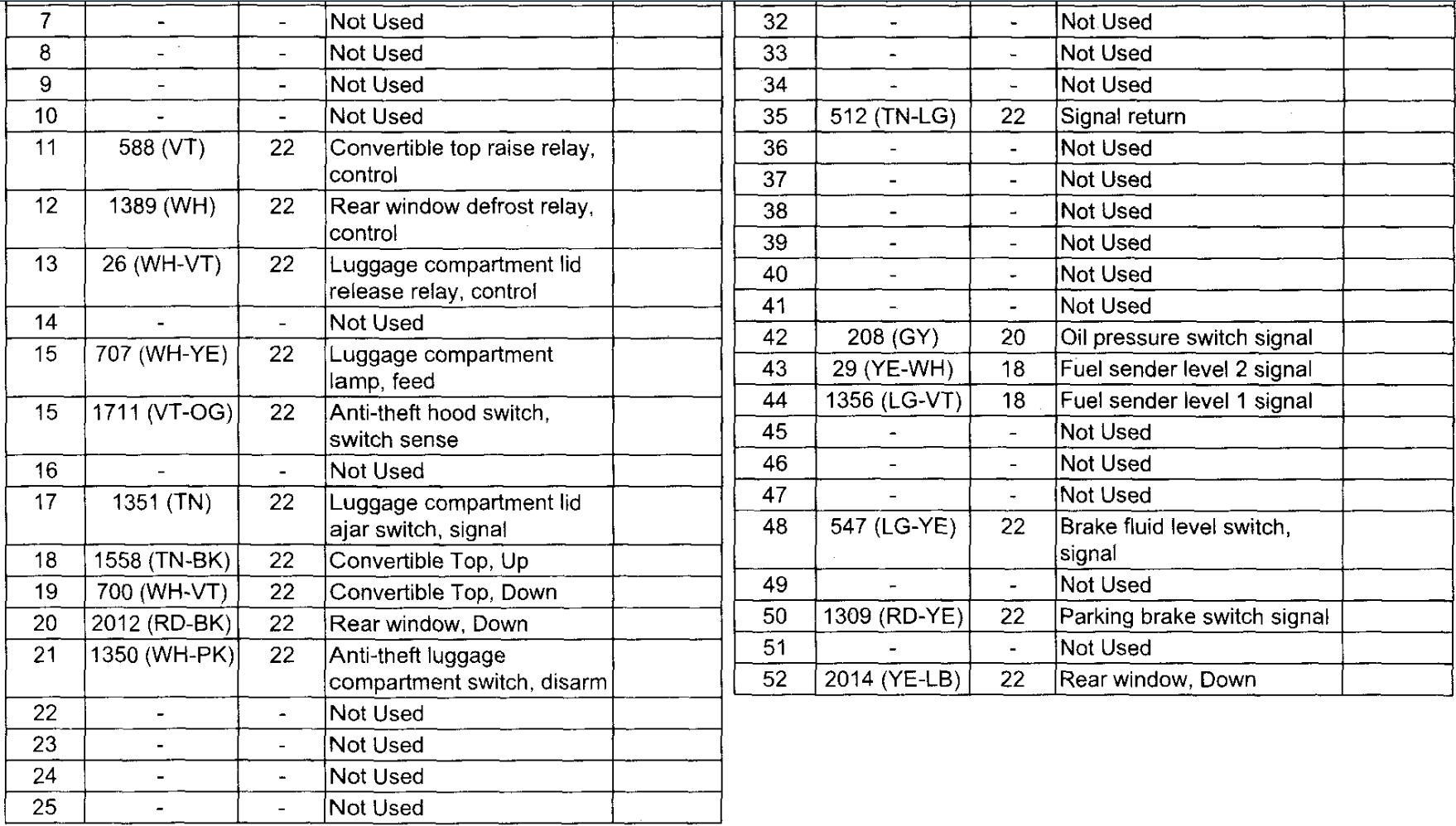

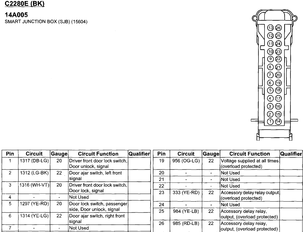

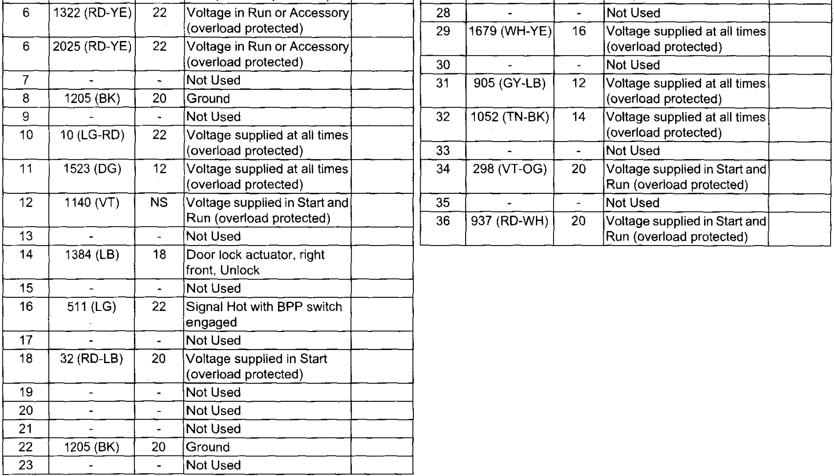

These are all 8 connectors, diagrams (1,2connector A) go together- (3,4connector B)- (5,6connector C)- (7,8connector D)- (9,10connector E)- (11,12connector F)- (13connector G) - (14,15connector H)
There is a diagnostic Flow Chart if there the SJB has no communication with a scan tool.

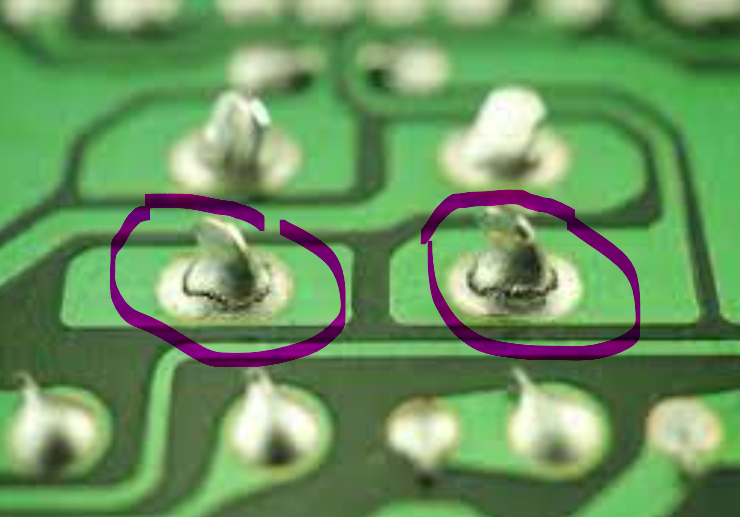

Okay, I posted the connectors on my last post, so refresh this page and they are there. If you're having to put pressure on the connectors to get things to function, you should check the pin fitment and make sure there are no loose pins in the connectors. If a wiggle test is showing the issue is right at the connectors. Sounds like you're dealing with either pin fitment issues or cracked solder joints on the inside of the board where the connectors are. If you take the SJB out of its case and inspect the solder joints with a magnifying glass for the connector pins, look around on the back side where the pins are soldered, and check that there are no cracks around the joint. Here is a picture of how the joints crack. Or you might find corrosion on the board. But cracks like this can be repaired.

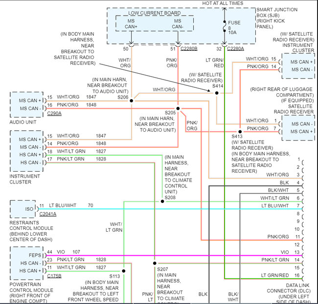

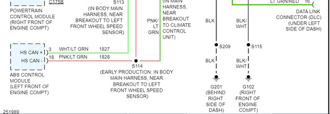

Here's the network topology just in case you need it.
Do you have comms with the SJB?
