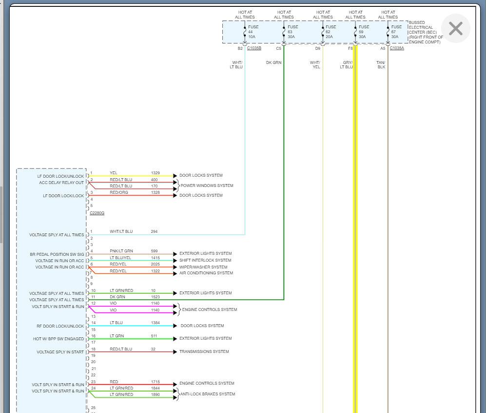

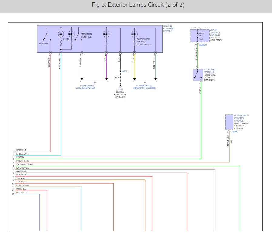

However, when you say fuse 59 is draining your battery, can you give a little more detail on that? How have you found that this is an issue?
The only reason I ask is because this fuse is one of the B+ supply for the SJB and it should be hot at all times.
So, if you are checking for voltage when the ignition is off then that would be expected.

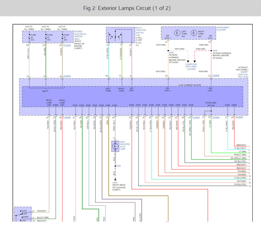

I am attaching the wiring diagram below that will show this but basically if we are finding the SJB is shorted then that is likely the issue.

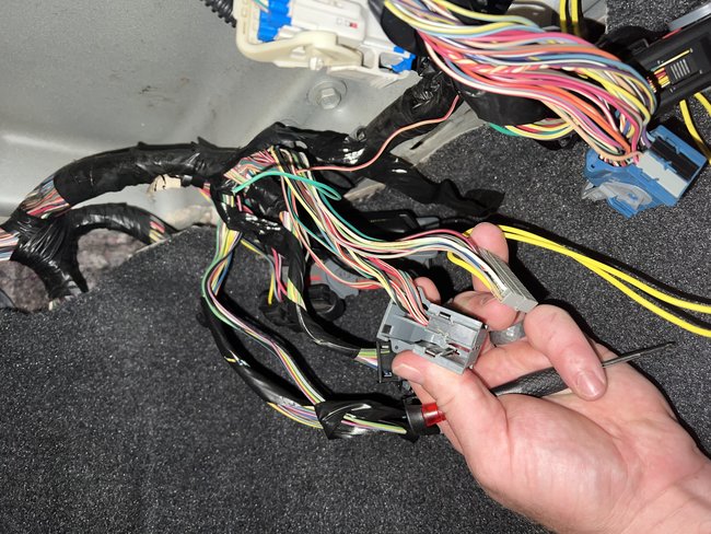

It was replaced and had problems right away with it and found burned up wires after the SKb on passenger side. Tan/red, red/white and also dark green/light green somehow was snipped coming out of the connector. I really just need the rest of the diagram showing the wiring and what it goes to find out what the dark green/ light green go to. This box was very clean and not corroded. I think that the short in wiring is causing the drain at the box. But I’m no expert either so any help would be appreciated.

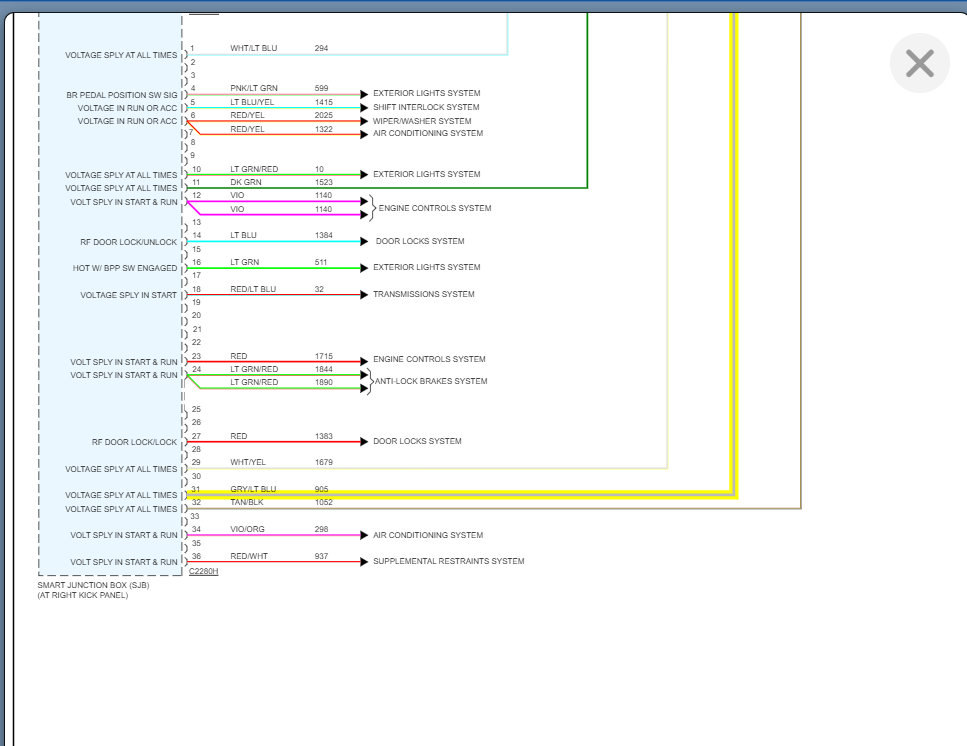

If can get a little more detail, then I can get that circuit info. Unfortunately, the SJB diagrams are extremely large as they power just about everything in the vehicle, so we are going to have to narrow this down a little.
Can you tell me which connector the wires are in? What color is the connector?

It’s this where the connector is grey and so are both the slide out ports inside. For some reason that green wire and tan/red are cut and gone. I assume that’s why there are two yellow wires now running in their place.

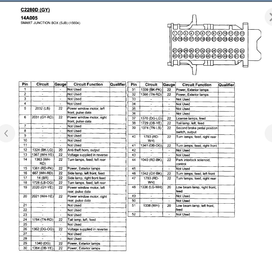

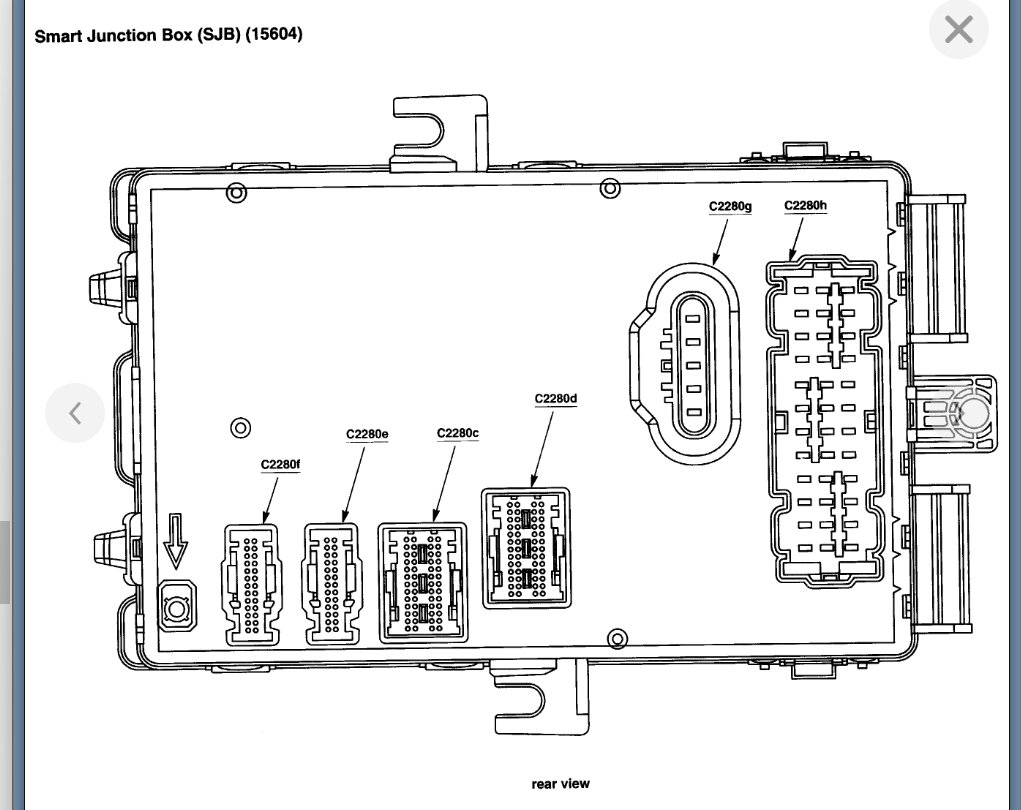

Okay. That did not help as much as I thought it would. There are a couple grey connectors, but I thought I would be able to find the wires in there.
I attached the pinout chart of the connector it appears to be. However, I also attached the back of the SJB. Can you tell me which number this connector is?

sorry for the late response. Holiday weekend has me busy. Its the C2280d connector. If you have the info on where those wires need to go to from there, that would be an amazing help! I just want to fix this so I can finally sell the car. Thanks!

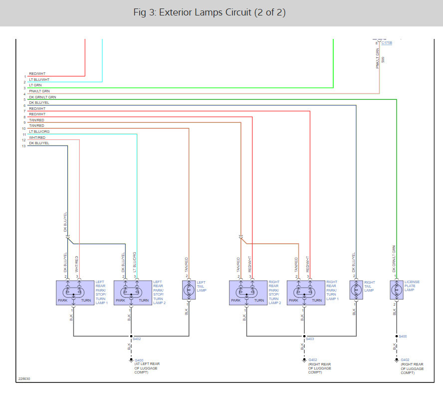

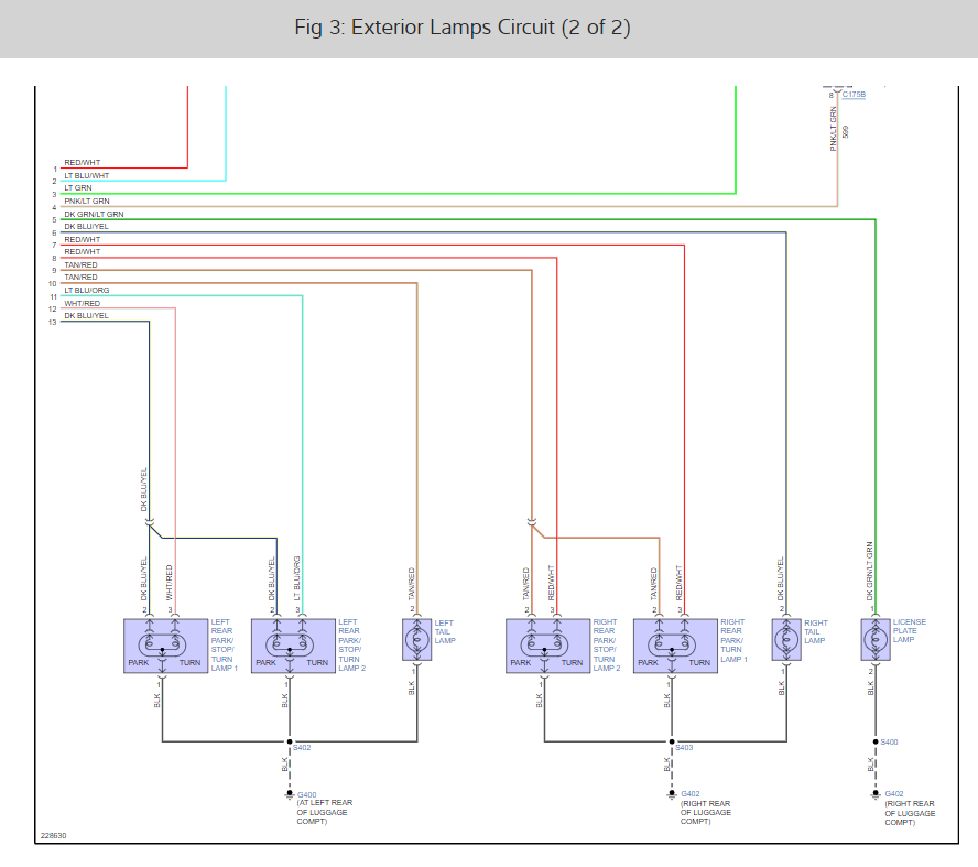

Basically, I need to know where the wires go to the rear right taillight because where the problem started was the aftermarket taillights, I think. The wires that all burned up went to that R rear taillight connector.
Jul 3, 2022 at 1:13 AM
  • 55,433 POSTS

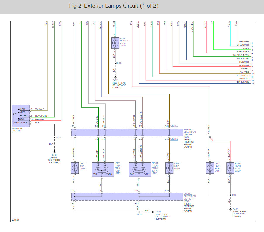

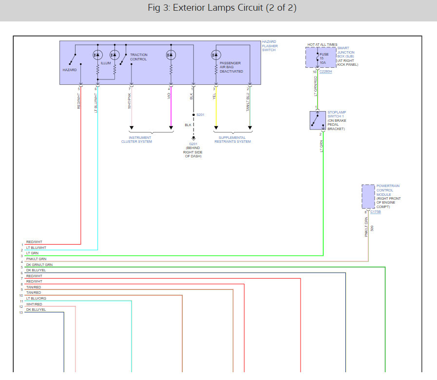

No problem, sorry for the delay. Here are the exterior lighting wiring diagrams so you can see how the system works. Check out the diagrams (below). Please let us know what happens.
