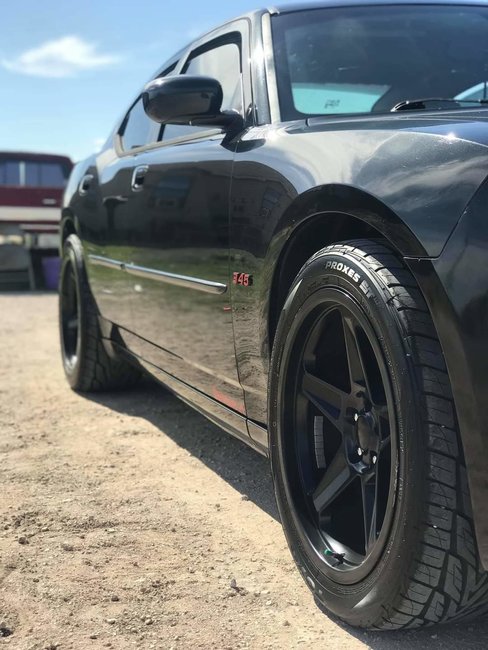

I got the right size tires on them now, I got a good deal for a matching set of Michelin's, the rims are just temporary until I can find the originals because the offset isn't correct, they're incredibly hard to find and I look everywhere, even junk yards only have 1 or 2 at a time. the rims I'm wanting to put on later are demon replicas, the picture below isn't my charger but one I saw on Facebook and it's what they would look like on mine. the problem with those is that the smallest is 20", if I were to get these would they be okay? if I made the overall wheel size close to factory size? Thank you Steve!
Sep 7, 2020 at 11:03 PM
STEVE W.
  • 15,345 POSTS
The biggest thing to match it the overall diameter. Then the offset. The diameter doesn't need to be perfect but you want it real close. The OEM tire diameter is 30 inches. If you look at Tire Rack they have the Sport Muscle SM73 which is a twin to the rim in the picture. A 255/50-20 tire on that rim would match the diameter of the factory set up.
