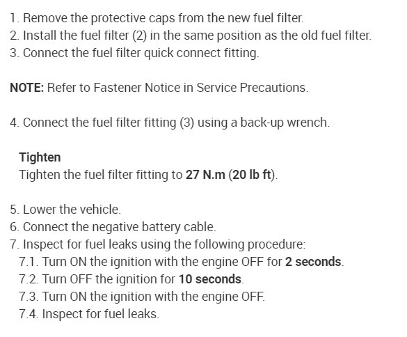

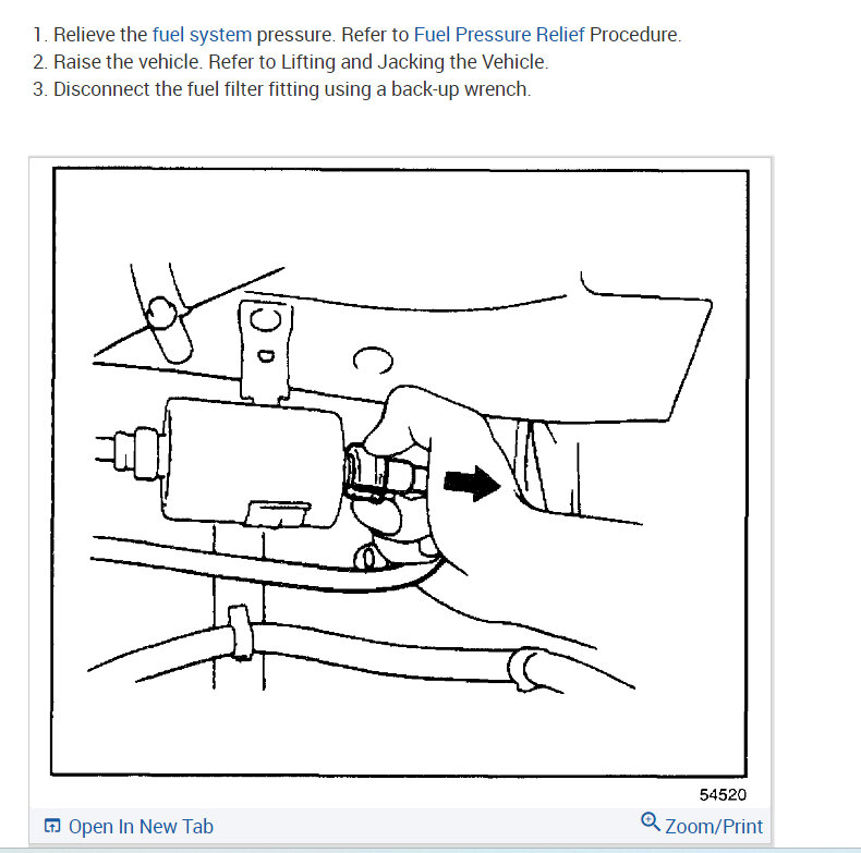

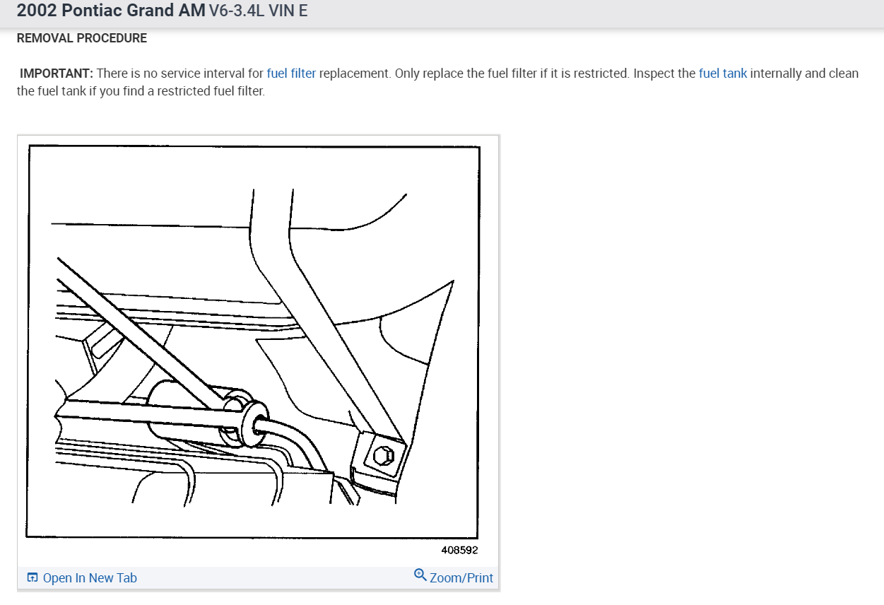

Yep, thanks for the video this will be either a clogged fuel filter or catalytic converter. I would go with the fuel filter first since it is a normal service item. here is a generic guide to help walk you through the steps and the instructions and location of the fuel filter in the images below.
https://www.2carpros.com/articles/how-to-change-a-fuel-filter
This guide helps as well:
