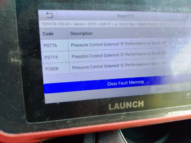

Good morning,

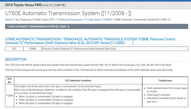

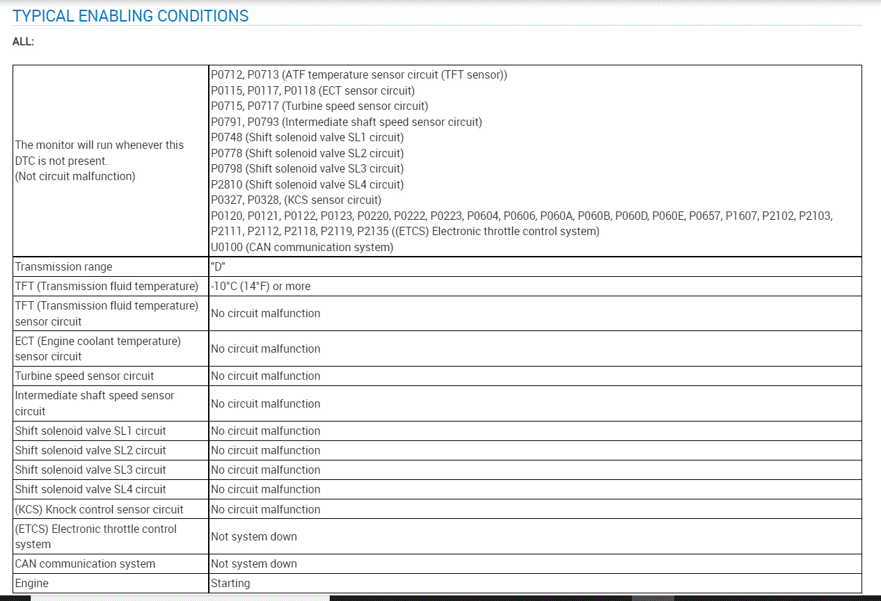

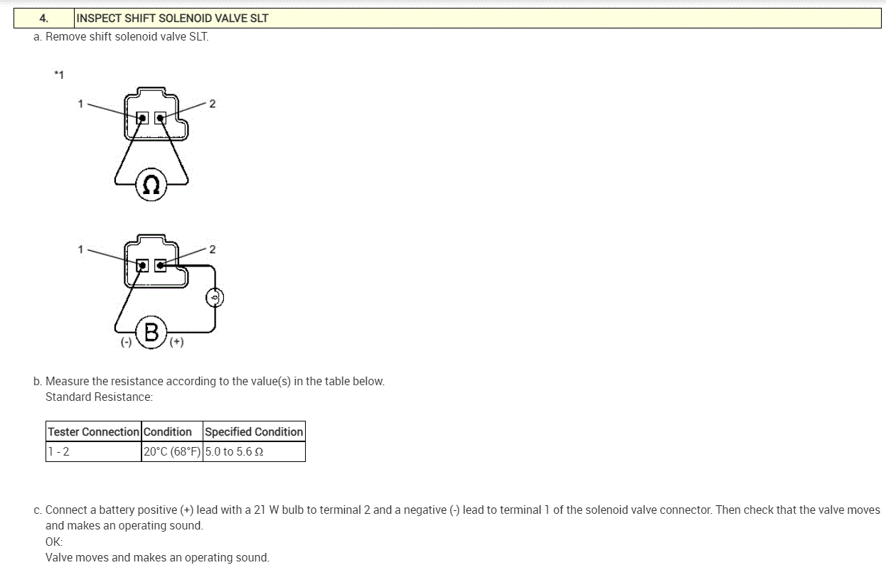

Actually, the vehicle model Is Venza not Camry. I selected Camry because I couldn't find Venza. The vehicle has slow response while accelerating and sometimes the transmission won't shift properly. Checking it with the scan tool, the code displayed is shown in the image and I also replaced the transmission fluid.
Jan 27, 2022 at 9:54 AM
  • 110,244 POSTS

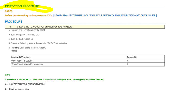

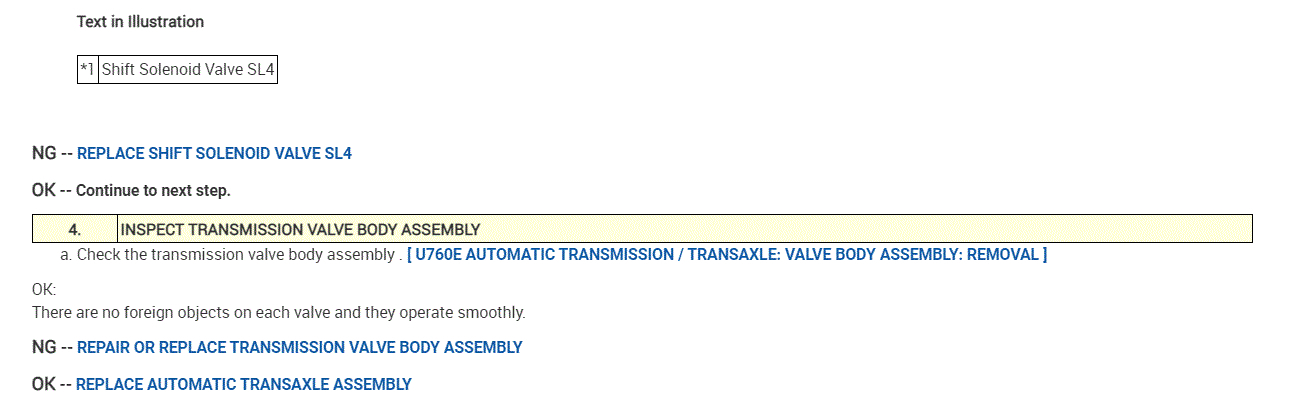

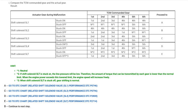

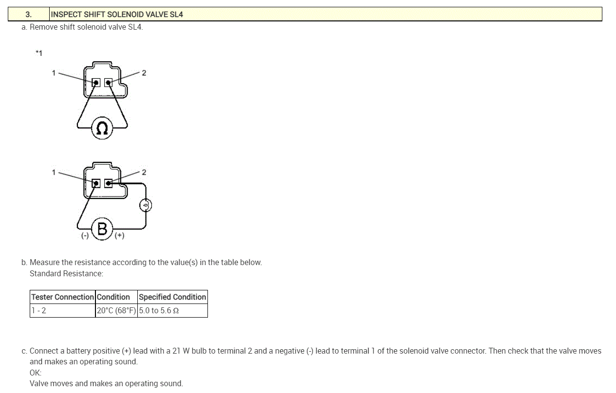

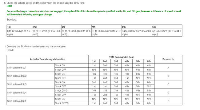

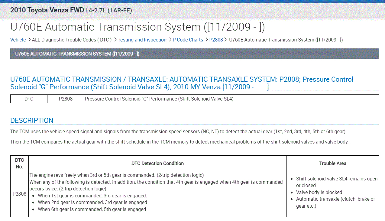

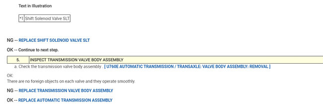

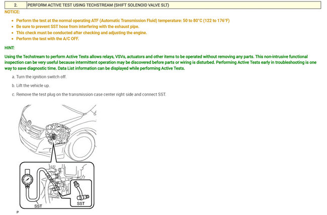

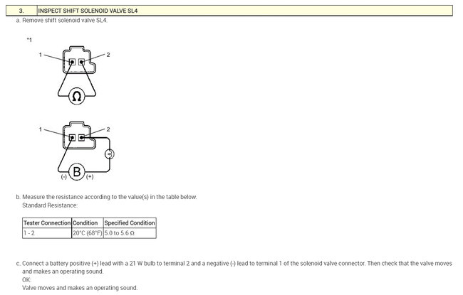

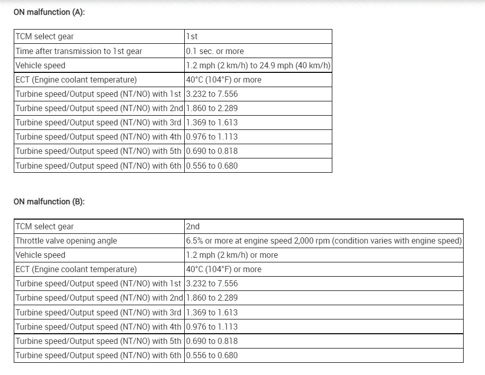

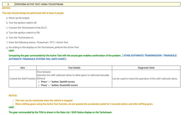

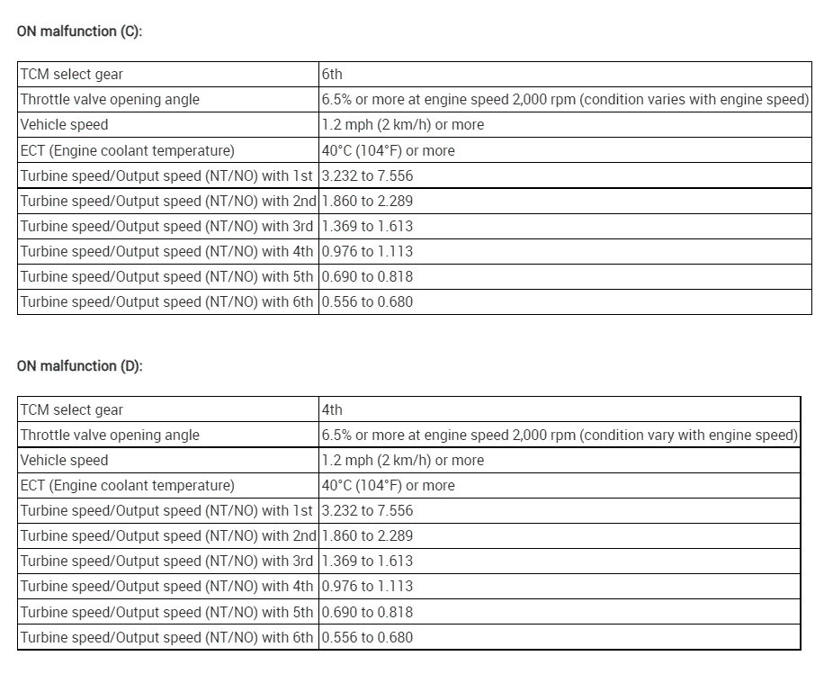

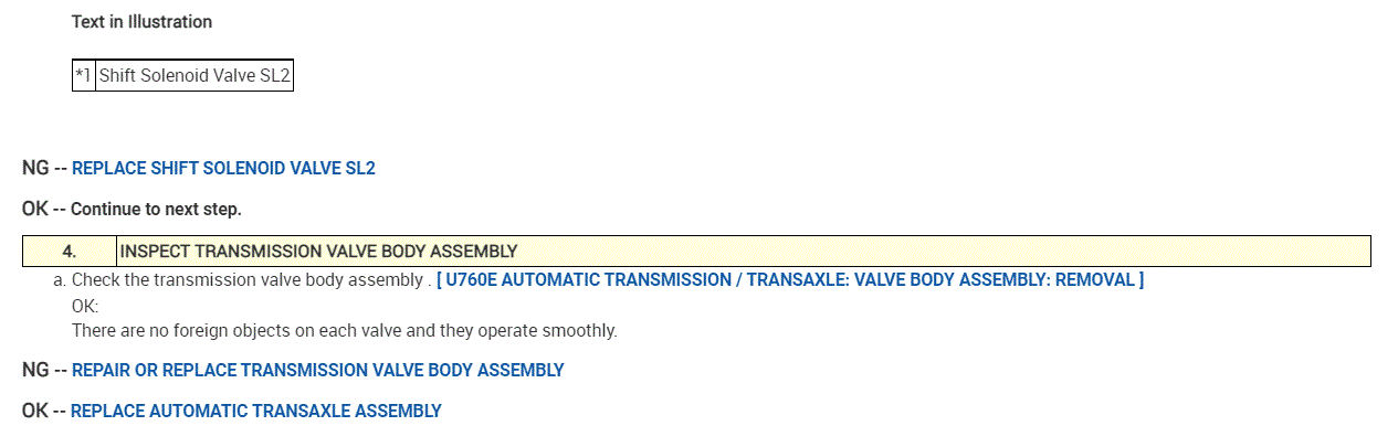

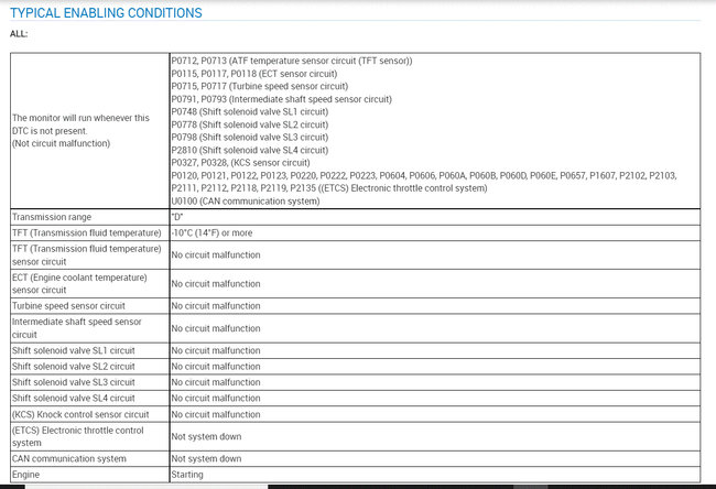

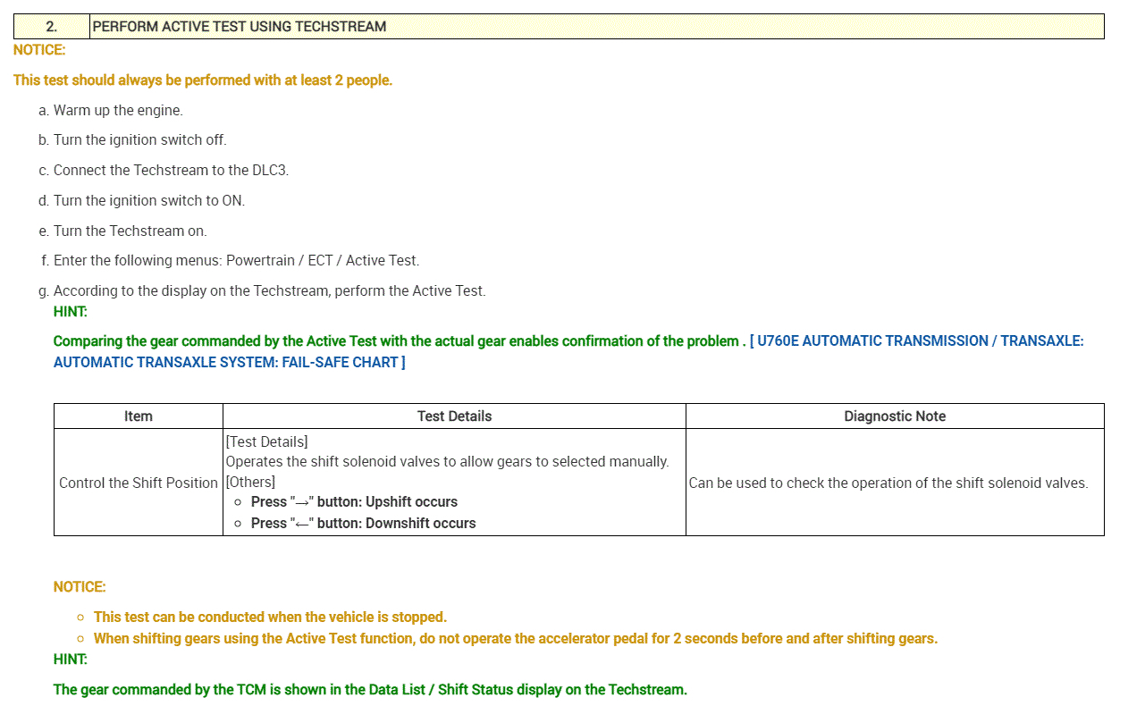

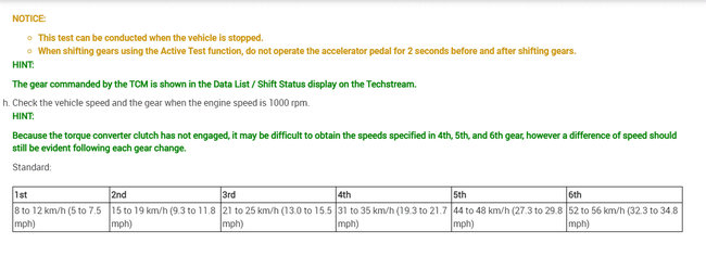

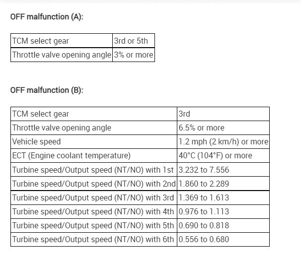

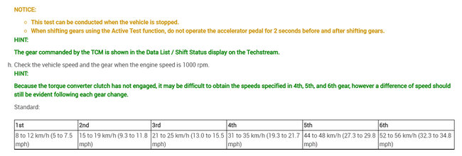

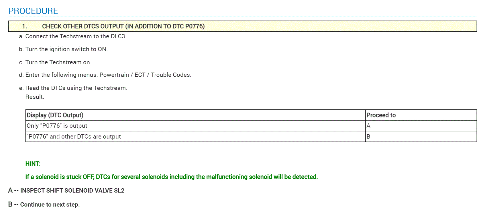

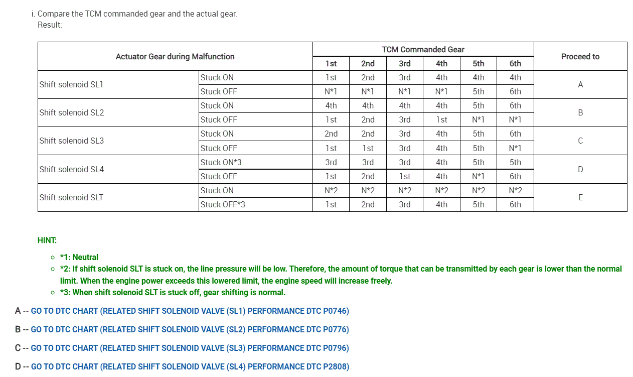

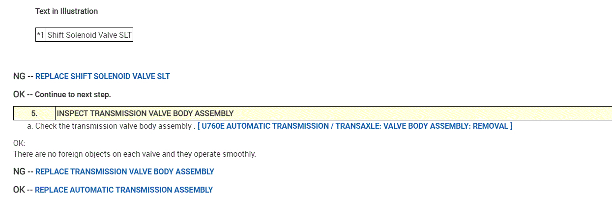

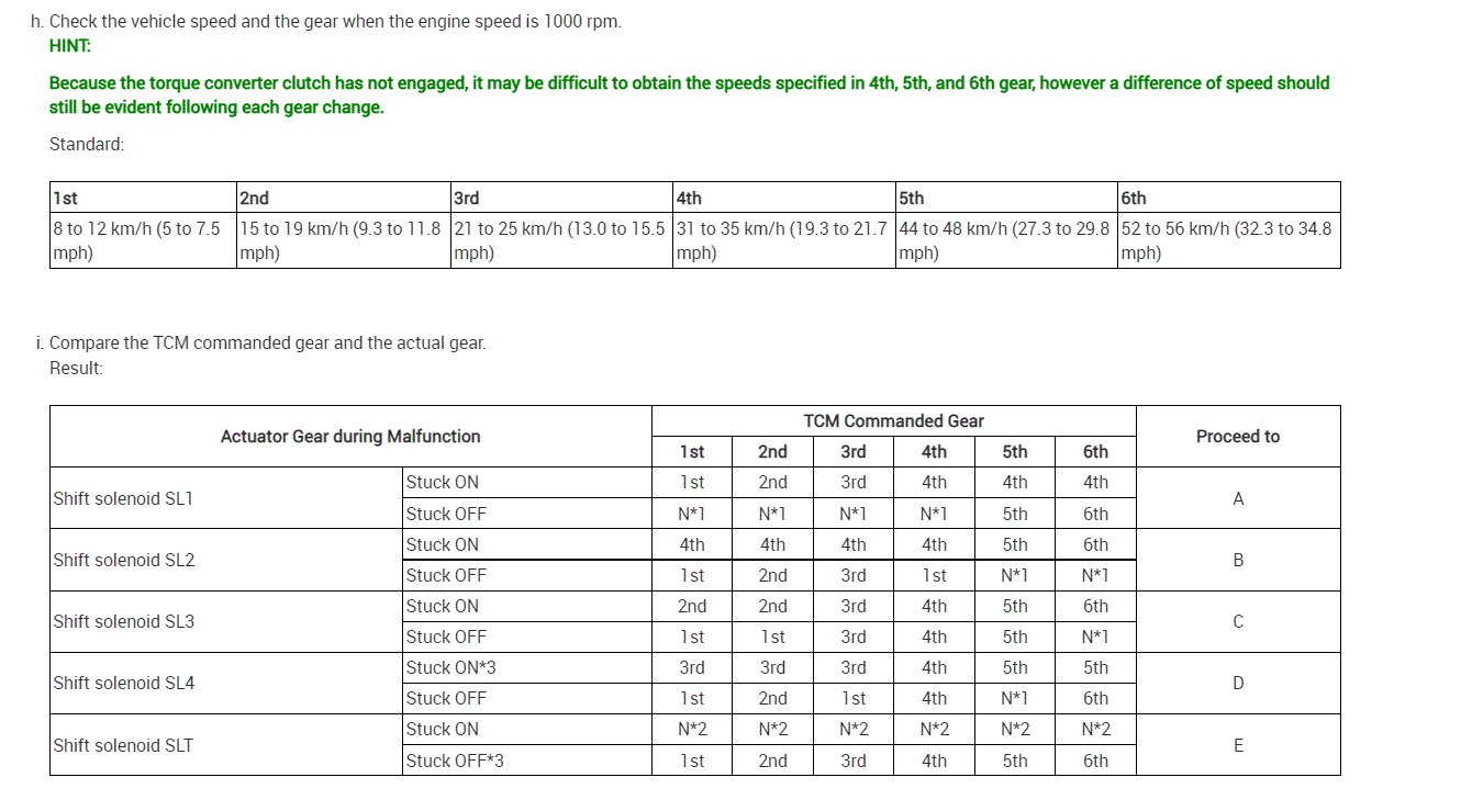

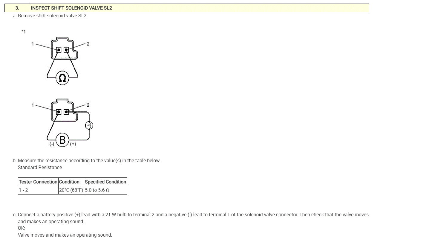

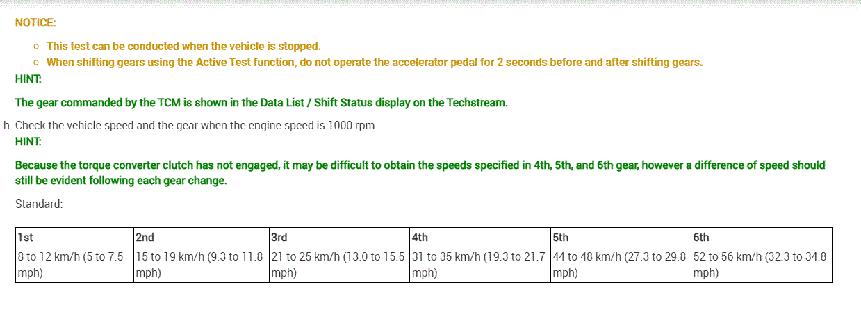

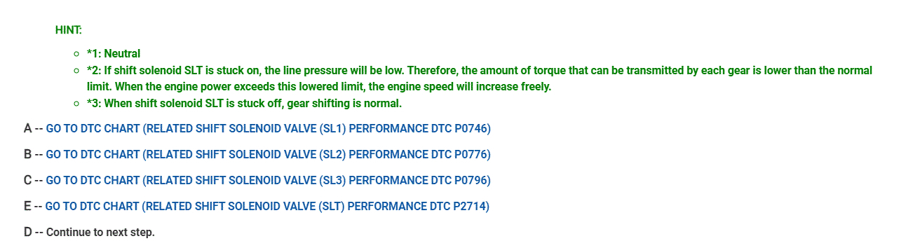

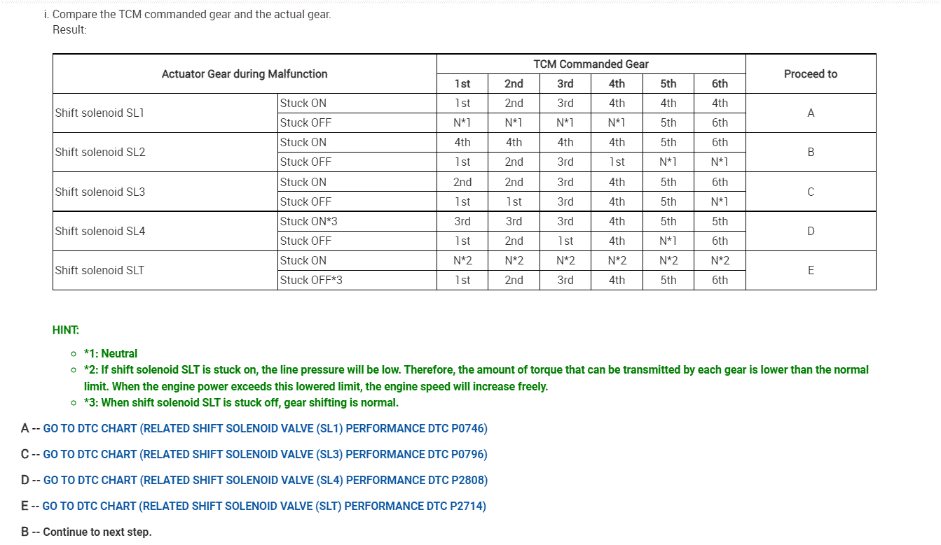

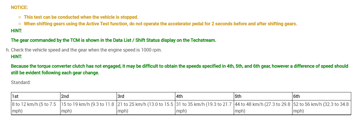

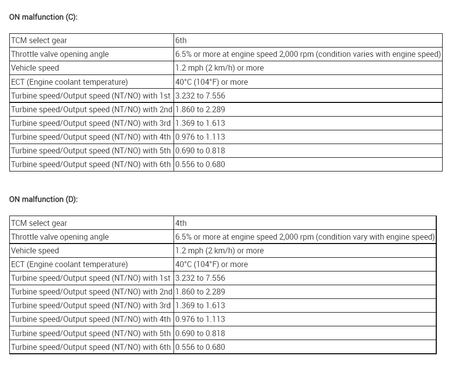

I haven't heard from you for some time. It looks like you have another tough one. I have a question. How dirty was the transmission fluid that you removed? When the pan was off, was there a lot of debris?

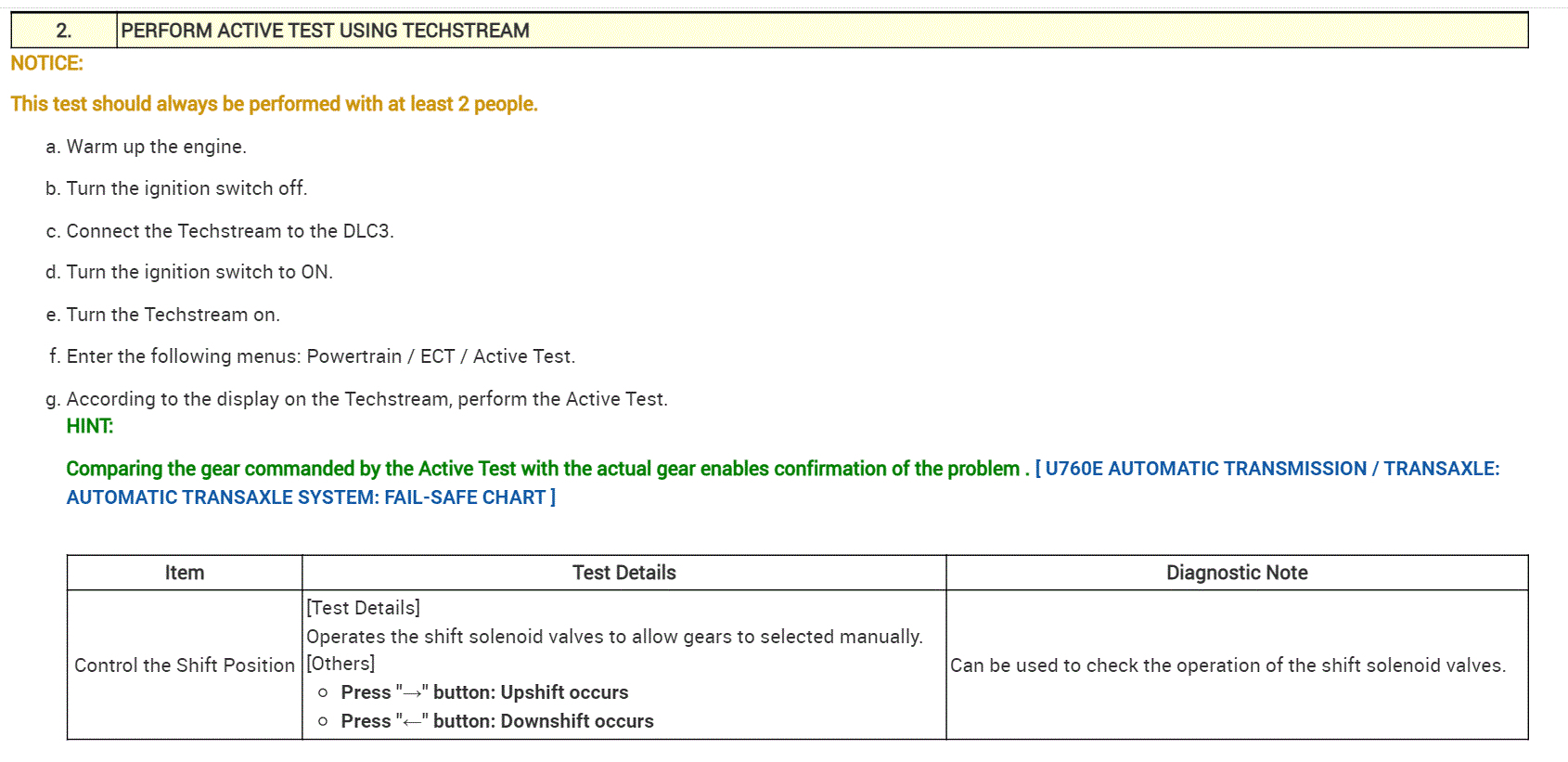

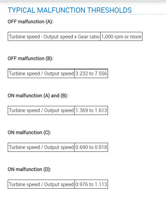

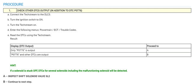

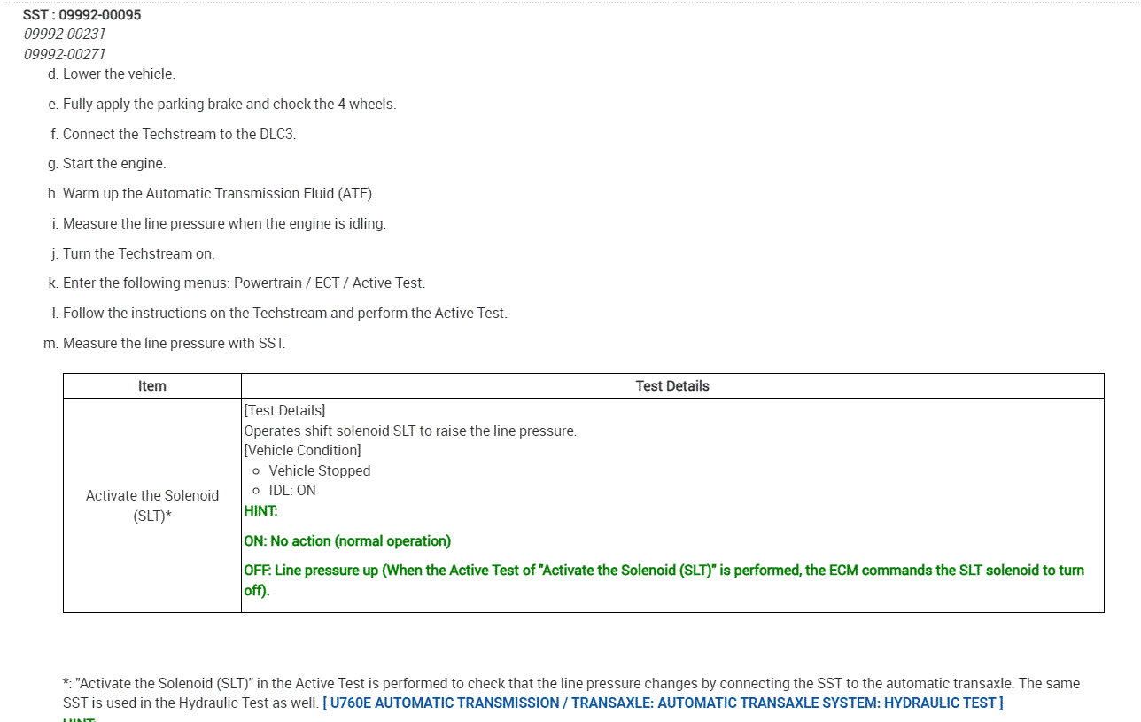

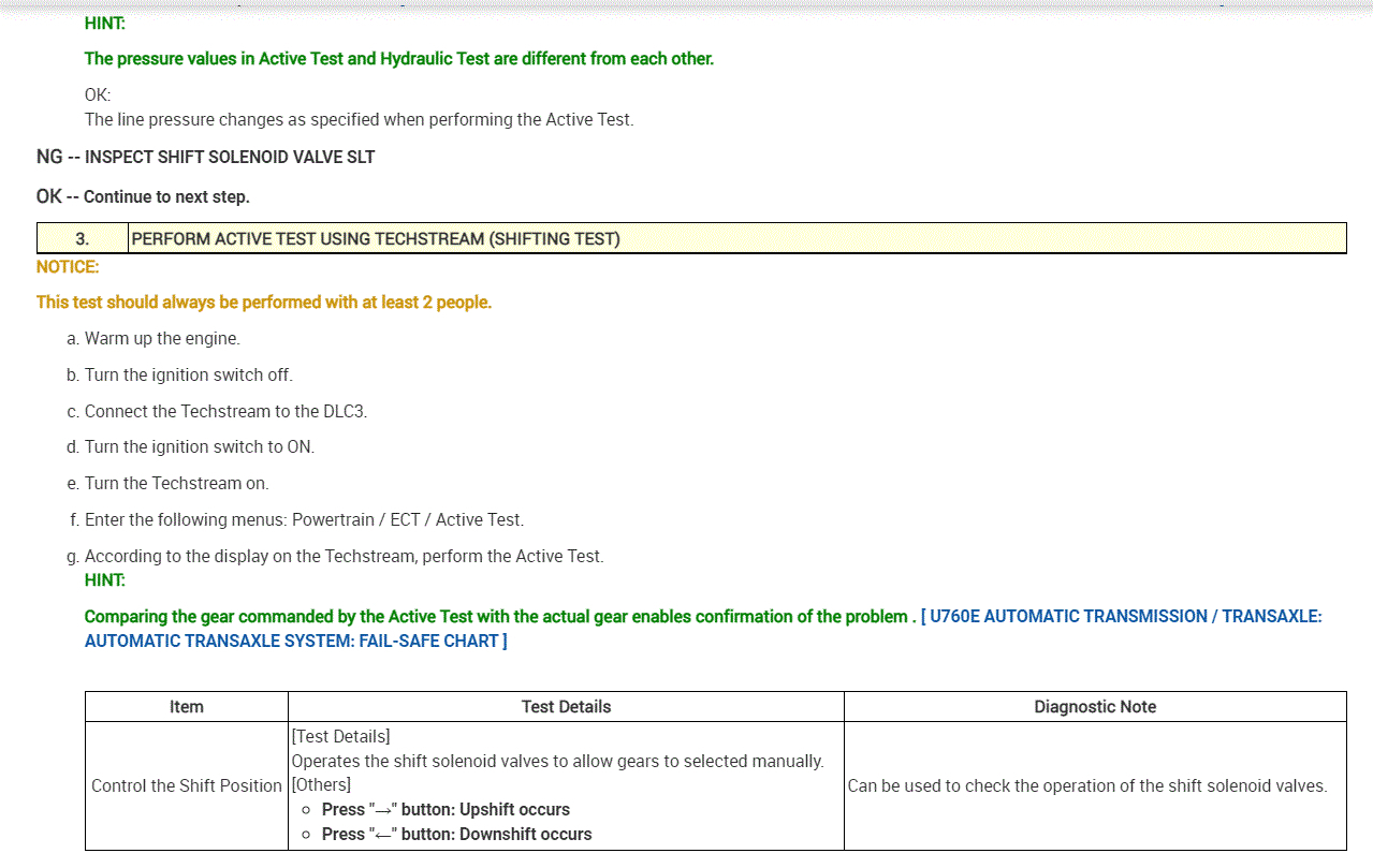

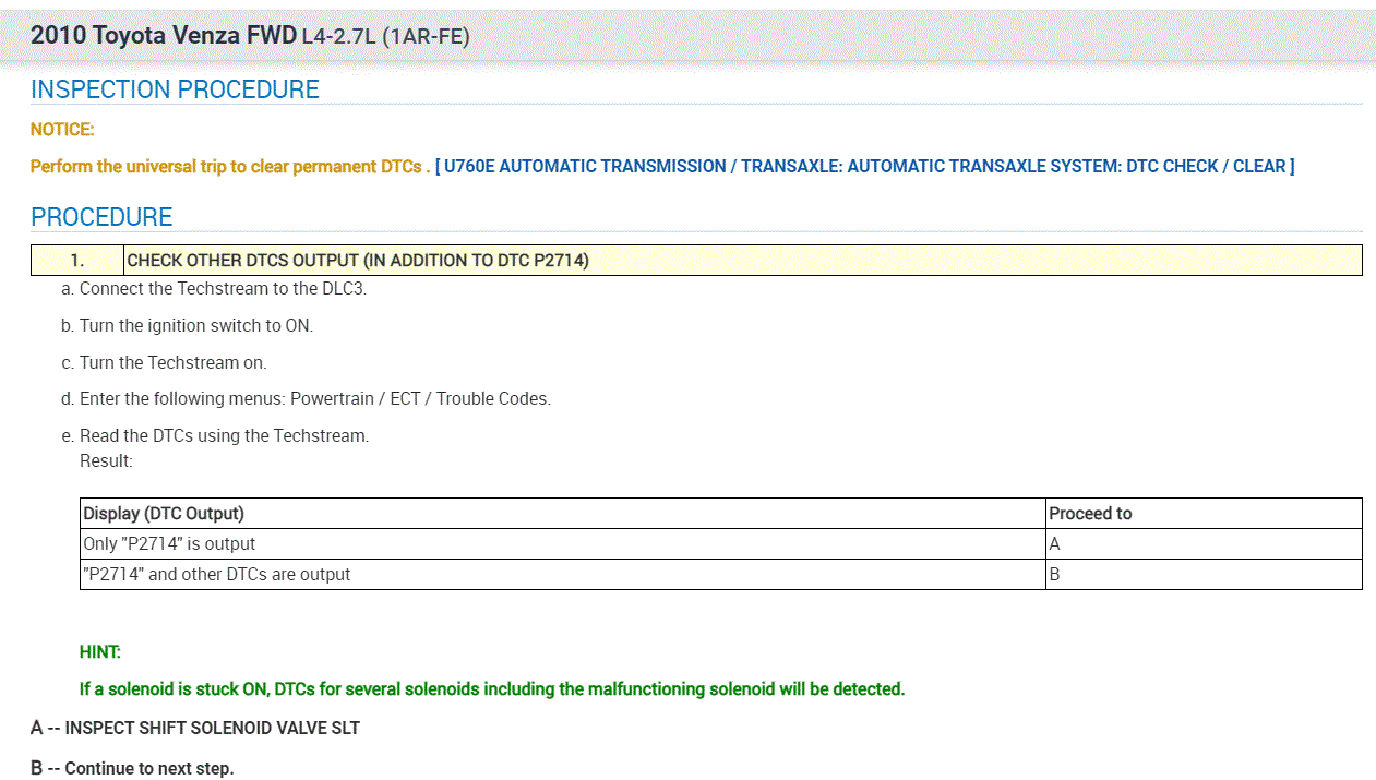

There is a chance you will be replacing the valve body if the fluid was bad enough. However, I attached the diagnostics below for all three codes. Take a look through them and let me know if you have questions.

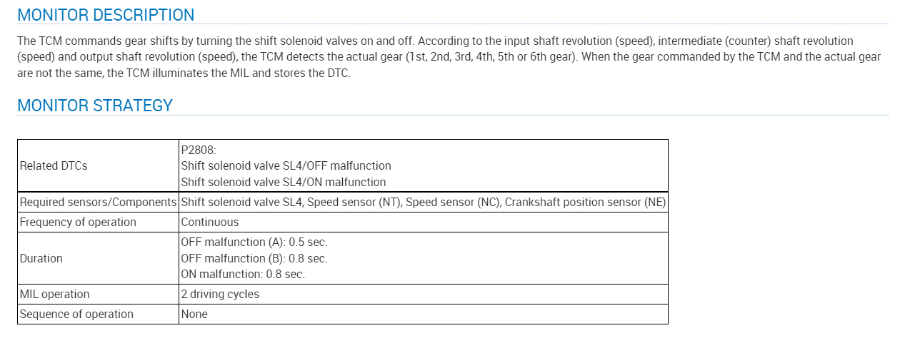

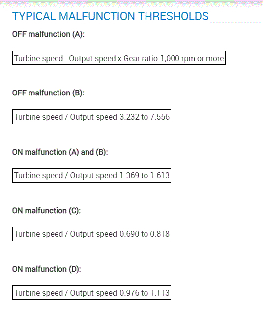

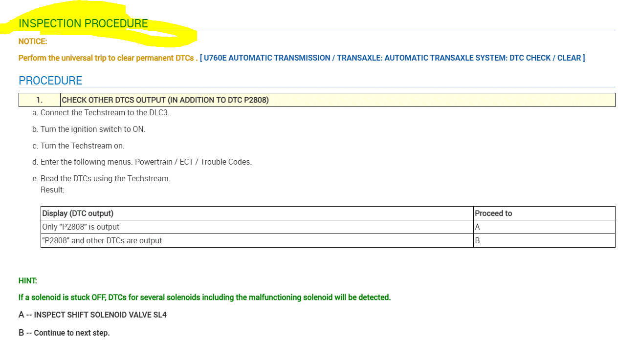

Also, the P2808 code is last below. I included the description with that one because I personally would start with those tests. I highlighted where the diagnostics start for that code. The two other codes just include the diagnostics.

The test to be carried out, is it only techstream that can be used or another scanner can be used?
Jan 30, 2022 at 3:06 PM
  • 110,244 POSTS
I'm not sure what you mean by "how will you know if the fluid is dirty". If it's darker in color, smells burnt, and so on. As far as replacing the valve body, that is a possibility. Chances are you will be able to locate the issue based on the diagnostics above.
And yes, you can use any scan tool that can communicate with the control module and perform the tests.

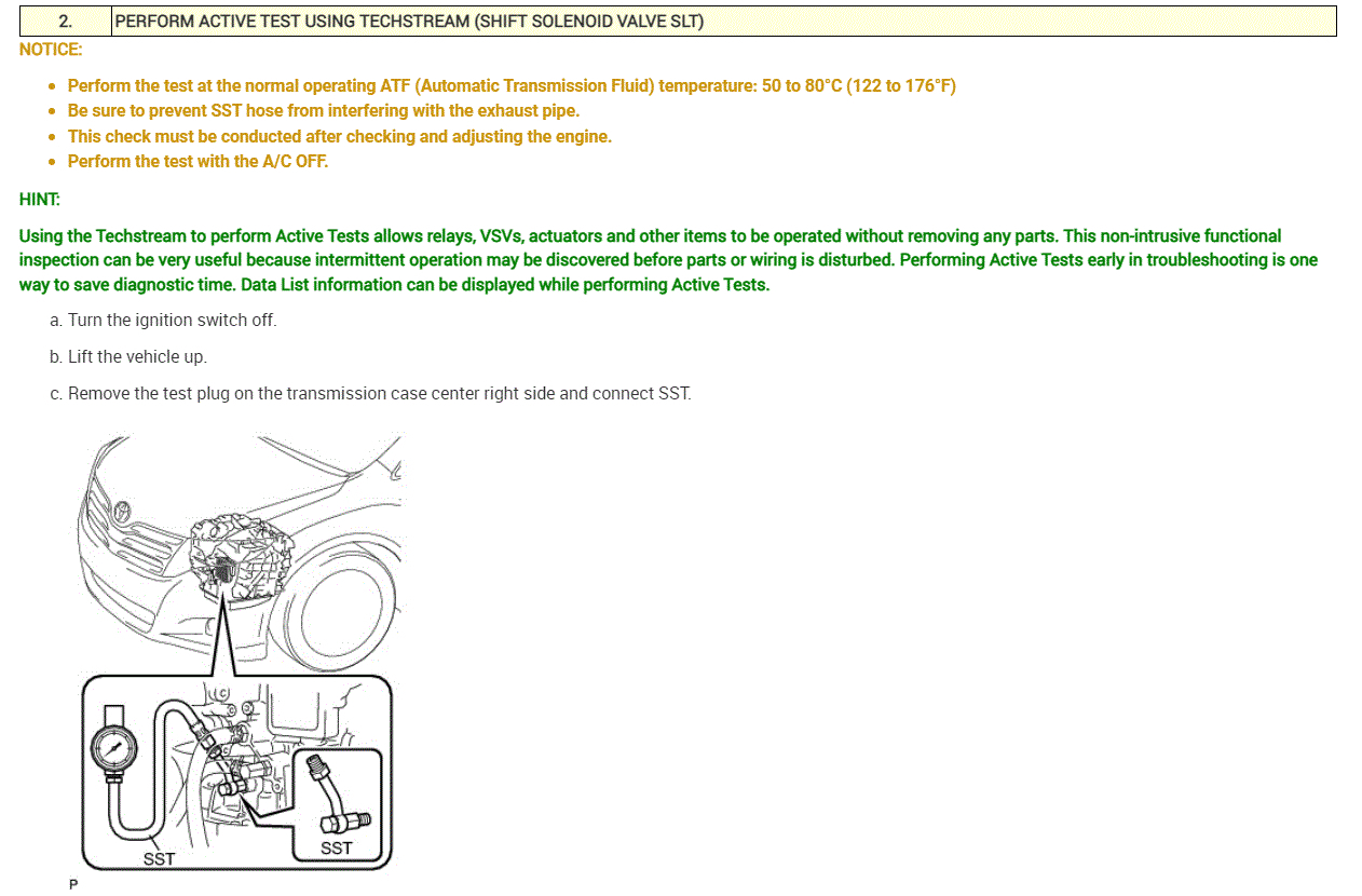

If you plan to work on them often, I recommend getting one that provides live data (active data). That will help you in many ways. For example, it can provide fuel trims, oxygen sensor info, fuel pressures, and so on. It is really helpful.
As far as the gauges, just get ones that will read 300 PSI +. Pressure can get high.

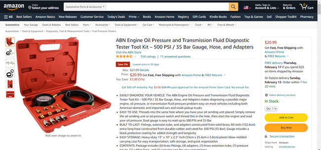

That is correct. The A/C gauges are for a gas and not liquid. I attached a pic below showing what you need. Isn't there anything online you can purchase? I'm sorry, I have no idea what you are able to get there. This is not an uncommon tool here. The pic I attached is from Amazon, but I have no idea if they will ship to you.
Where are you located again? I would be willing to get one and send it to you, but I have no idea what the cost would be to ship.

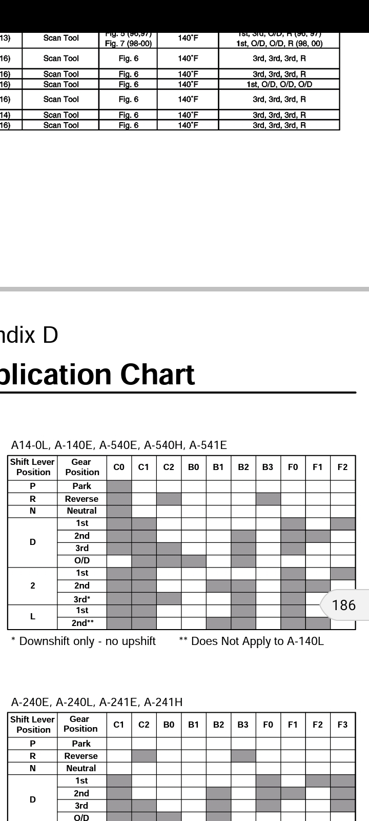

Good afternoon, sir, l sincerely apologize for posting these here, I am not supposed. I would love to diagnose components or systems the way they are supposed. I was studying a book and saw the question below, I thought about it several times, but I could not figure it out. I don't know if you could be of help.

As far as an oscilloscope, they range in price from inexpensive to very expensive. I attached a pic below of one that should do what you need and it isn't too expensive.
Take a look at it and let me know if that would work for you.
See pic below
