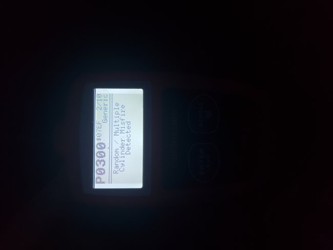

Theirs much to explain so I'll just start at the beginning. So my car started to accelerate very slowly almost as if a fuel filter or something was clogged and making a loud exhaust sound as if the exhaust had a hole or something. Come to find out my catalytic converter bank two was clogged. So i ended up just cleaning it out myself to save money. It was 100% full/clogged with whatever the dark silver stuff is. Anyways, that seemed to help some but still slow accelerate and also when i use the A/C while driving it takes a lot of power almost to where i can't accelerate and will shut off if idling. Also going up hills is almost impossible. And if there is extra weight in car, it barley makes it up the smallest incline. I ran ob2 meter and said i had some misfires so i replaced all the spark plugs, did a fuel filter change and inspected the fuel pump which is good (there is no fuel filter, i think it's part of the fuel pump because I can't find one and the fuel pump has a mesh type thing on bottom of it). I also checked the exhaust manifold/catalytic converter bank 1 and it's clear. I'm about to replace the spark plug engine coils and spark plugs again since i didn't replace the coils the 1st time. I also used a long screwdriver to put on the fuel injectors to listen for the clicking sound it makes to ensure they are working and they are. So what could be my issue?

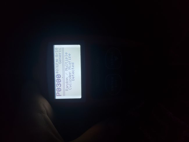

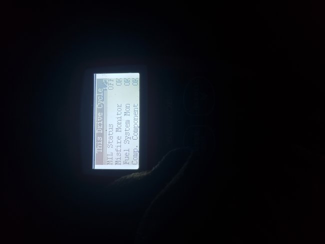

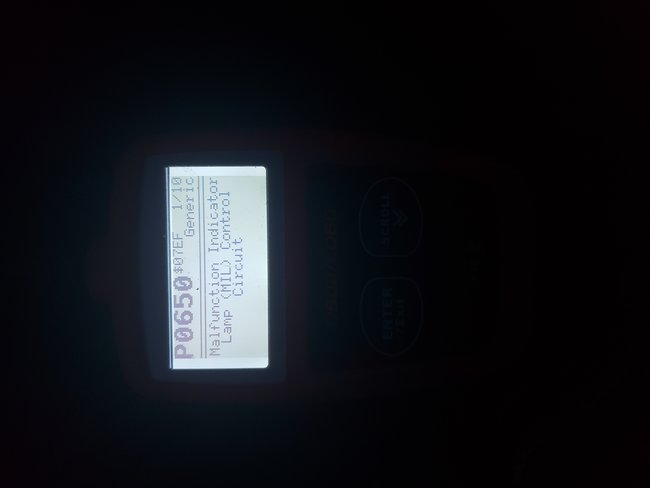

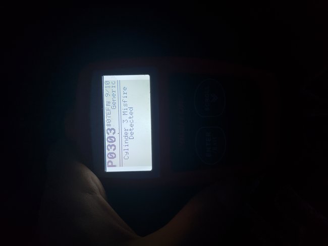

I thought I'd send you all the codes the ob2 is giving me. It not a fancy one, but hope it helps.

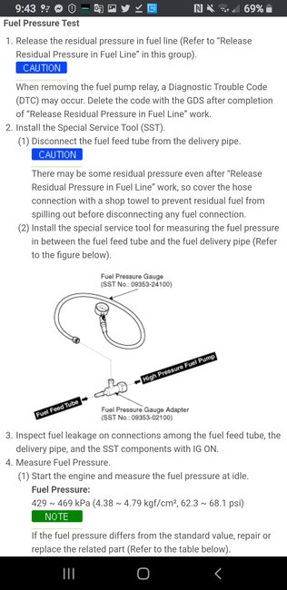

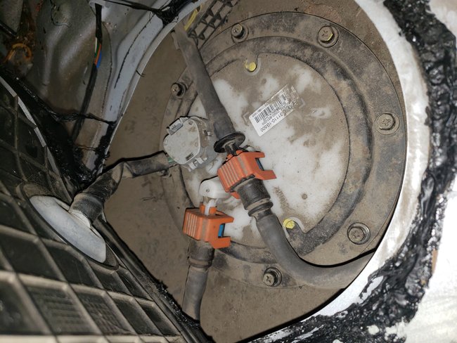

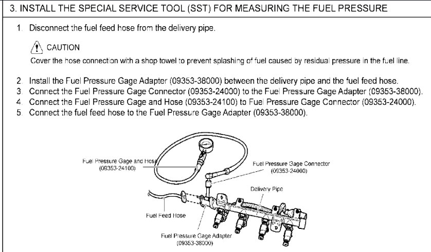

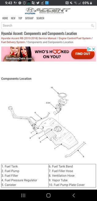

I did a little research. Is this how i need to check the fuel pressure for my Hyundai as shown in the pictures by using an adapter for the fuel tester i rented?
Let me know if i got this right please: Basically remove backseat to get to the fuel pump to remove the fuel feed line on it and connect it to the adapter for the fuel pressure gauge tester, and the other part of the adapter to the fuel pump itself?

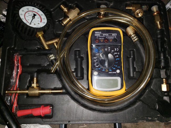

Here is a picture of the fuel kit i got from O'Reilly's for a $150.00 refunded deposit:
Jul 25, 2020 at 2:58 PM
DERRICKT2020
  • 24 POSTS
No clue which tube to disconnect and connect to the pressure tester. Please help.

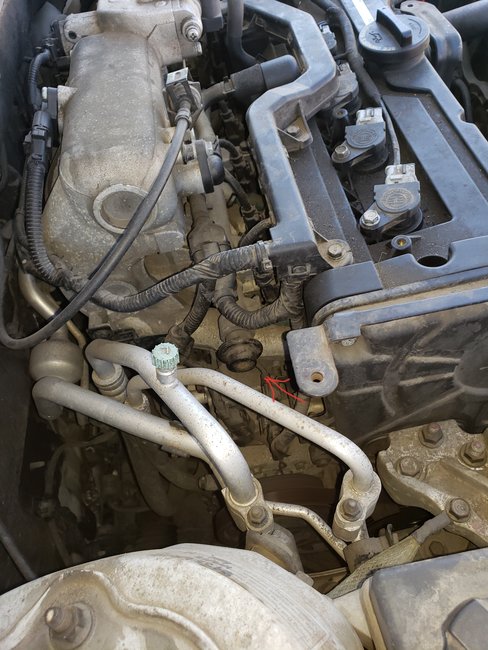

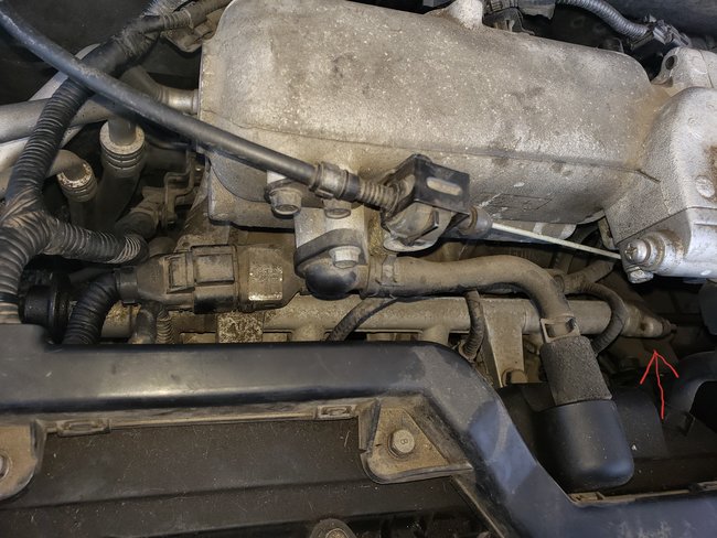

I noticed my fuel rail for the injectors has a bolt type thingy on one end, the left side. I marked it with an arrow. Is that where I hook up the fuel pressure tester? Let me know please soon today.

Actually never mind. I believe i found out how to hook up the fuel pressure tester. On the right side of the fuel rail (In the picture i marked it with a arrow) i would hook up the attachment shown in picture. But I'll try what Ken said first.
Jul 27, 2020 at 11:45 AM
DANNY L
  • 5,648 POSTS
Hello again.
Okay, that looks like the correct adapt to hook up the tester.Keep us updated after you perform the fuel pressure and catalytic converter test.Hope this helps and thanks again for using 2CarPros.

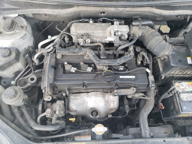

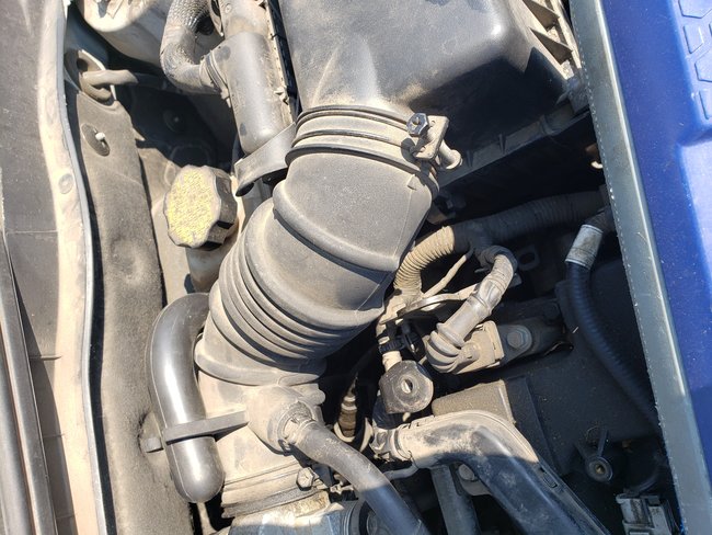

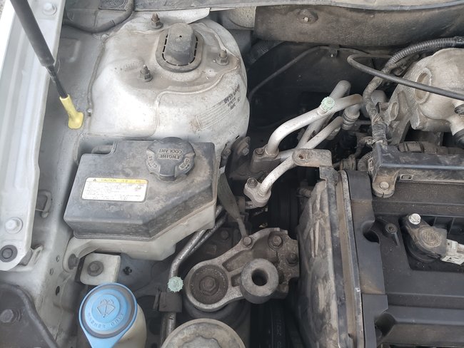

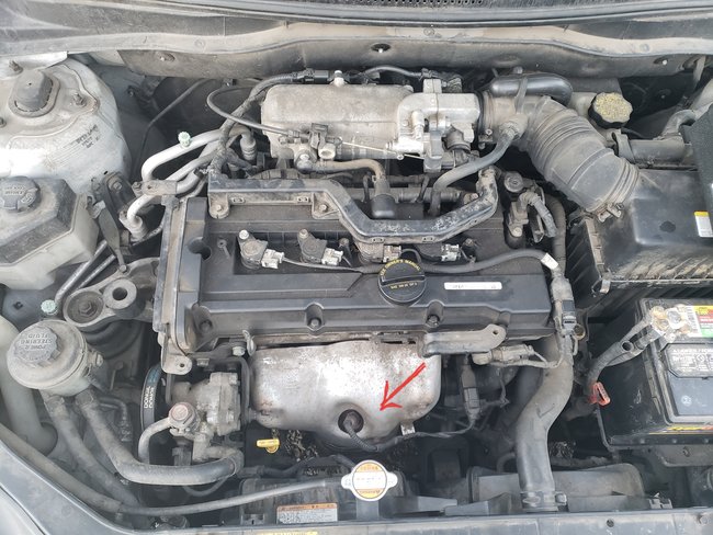

Is that the upstream o2 oxygen sensor I marked in the picture with an arrow that i connect the pressure tester to?
Also, i did take off the exhaust manifold entirely to make sure it wasn't clogged because the catalytic converter was stuffed, i couldn't believe how 100% full/clogged it was. Another note m, when i changed the spark plugs the 4th one was pretty dirty with sludge.
Jul 27, 2020 at 8:55 PM

Having the catalytic converter plugged like that would definitely cause a sluggishness or hesitation issue. Glad you were able to find the issue.Thanks again for using 2CarPros.

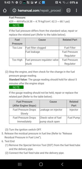

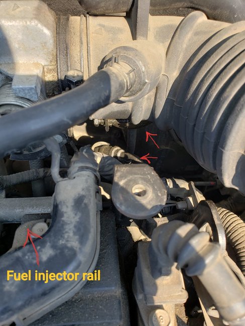

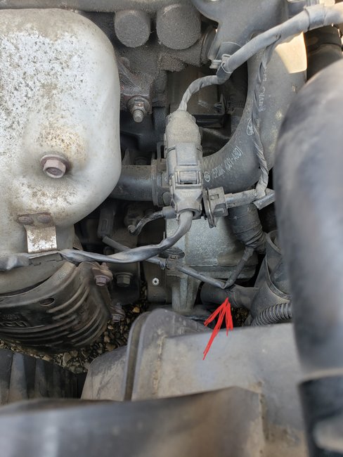

I finally got the fuel pressure test. I ended up having to buy 2 feet of rubber fuel pressure hose because that adapter i need isn't at any auto store or kit unfortunately. $84.99 to order online from a specialty store.
Results: I turn the key over a few times to build pressure but not starting it. It does go to 50psi and slowly decrease. However, when i start it it'll build pressure to 50psi and stay their. Eveb when I press on the gas while parked/idling the psi stays constantly at 50psi. Even when i shift into every other gear it stays at 50psi and doesn't move at all. And shouldn't it drop 5psi once i shift into reverse and press on the accelerator? Oh and when i turn car off and remove key the psi slowly decreases.
Furthermore, I attached pictures marked with 2 red arrows of a possible fuel leak. The fuel pressure line( Not sure what that piece is but I know it the fuel line) you see is wet and it runs directly into the right end of the fuel injector rail and above it you can see more signs of a wet surface also marked with red arrow.
Lastly, I have one off subject question. I noticed a wire of some type i marked with a red arrow in the 3rd last picture( Seems hollow honestly) bent pretty bad and was wondering if that would cause any issues or future issues? Not sure what it even does.

Okay, 49 is the spec. You are good.
It will not drop running. That is okay.
It should or may drop about 5 pounds after it is turned off.
You are good with the pressure.

And regarding the fuel tests, I think the performance of the fuel pump isn't good. What do you guys think? It said in the instructions that when i start the engine it should decrease 5psi and when i put it into reverse and accelerate or drive it the psi should increase 5psi but nothing happens, it stays constantly at 50psi as it did when engine was off and key on. And it said if no change than to check the regulator vacuum feed line( Which i think is the fuel line going into the right side of the fuel rail which is also the part that is wet that i showed you in the last pictures) for leaks and if all good. Than it's my fuel pressure regulator if equipped.
Excerpt from instructions provided in 2nd reply:
"Now start the engine so we can test the performance of the pump. While the engine is running, the fuel pressure should drop about 5 psi, from the static prime pressure (DPI) then snap the throttle, the fuel system pressure should jump up about 5 psi. this means the fuel pump and pressure regulator is working correctly. If the system fuel pressure does not respond inspect the regulator vacuum feed line and if okay the fuel pressure regulator has failed (if equipped)."
Jul 29, 2020 at 11:12 AM
The fuel system is working fine. Your pressure is on the button.
There are no concerns for the system pressure at all. You are holding pressure and not low or bleeding off.

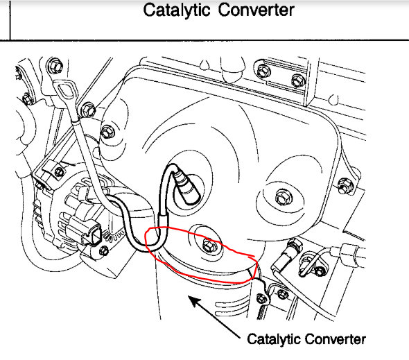

I'm not sure if your catalytic converter is a one-piece design combined with the exhaust manifold. I've attached a picture below and circled in red where it might unbolt and separate. After removing the 3 bolts remove the heat shield. If the catalytic converter unbolts from the exhaust manifold then just unbolt from there.If not you can remove the whole manifold and converter assembly.Like we've stated earlier if the unit is blocked and plugged up once unbolted and you start the engine it will run better and stay running.Hope this helps.Let us know if you have any further questions about this and thanks again for using 2CarPros.
Danny-
Jul 29, 2020 at 12:18 PM
DERRICKT2020
  • 24 POSTS
I was just about to ask you that. But no their is also a bank 2 catalytic converter that sits between the thing you circled in the picture, and the muffler. The 2nd converter is about half way down the exhaust, about where the drivers seat is. That's the one that was clogged entirely. I'm removing the 3 bolts from the catalytic converter manifold you circled right now.

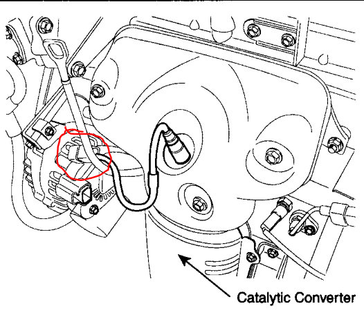

So i need to get a o2 sensor removal tool because i can't get the heat shield off to get to the manifold. So going to be tomorrow morning until i can get to Auto store. But i attached a picture of exactly what mine looks like. Because i have taken it off to check if it's clogged etc and it wasn't. I've heard it's called bank 1 catalytic converter manifold and the other catalytic converter half way down the exhaust is bank 2 which was the clogged one.
Jul 29, 2020 at 1:38 PM
DANNY L
  • 5,648 POSTS
Hello again.
Just an FYI; I've attached the same picture below.Where I've circled in red is the o2 connector to the wiring harness.Use fingers to depress tab and disconnect.You can then pull the heat shield off by pushing the harness through the hole.You don't have to remove the o2 sensor.Hope this helps.
Danny-
Jul 29, 2020 at 1:50 PM

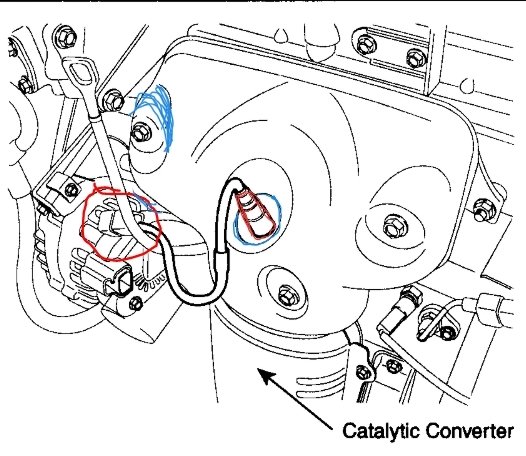

Good information. What concerns me is that some of the stuff you cleaned out from the one converter may have traveled down the system and lodged in the muffler. That will cause a restriction and low power.
By opening up the fron for it to breathe, it will eliminate that possibility.
Jul 29, 2020 at 8:17 PM
DERRICKT2020
  • 24 POSTS
Well, in the picture where i circled in blue around the 02, it gets caught on the red part of the 02. i circled since it a solid piece sticking out because i can't just simply lift it due to the fact the left side of the heat shield. i marked in blue has parts in the way stopping it from just lifting straight up. No worries, I'll get it done. Just thought id share their information.

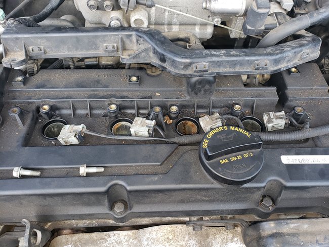

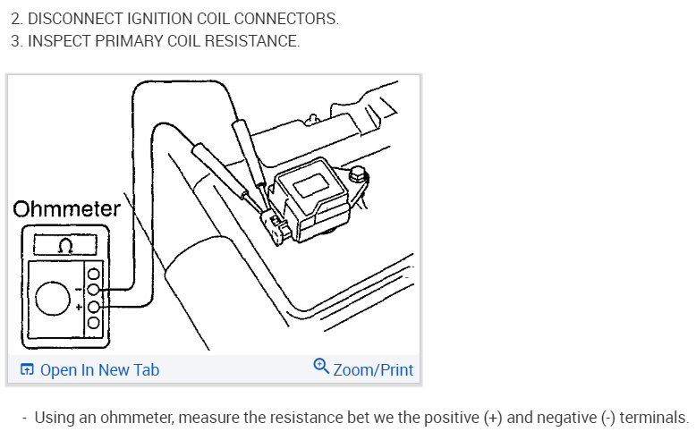

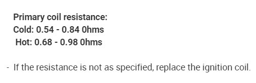

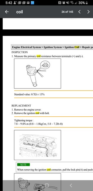

Hey guys, so as I was doing the cylinder pressure test, I decided to test the coils too. They never been replaced to my knowledge. Also, can't find a back exhaust pressure tester but a buddy's cousin might so waiting to hear back. Also, I have not unbolted the exhaust manifold yet because need to get a tool to remove the 02 sensor to remove heat shield.. so anyways, upon check the spark plug/ignition coils with a multi-meter. I get no reading. I'm supposed to get .7 I think. But when I go to test it, it'll show some numbers for a half a second and then it goes to zero. So I think I have bad coils. Attached a screenshot of what my coil looks like etc.
Aug 5, 2020 at 10:50 AM

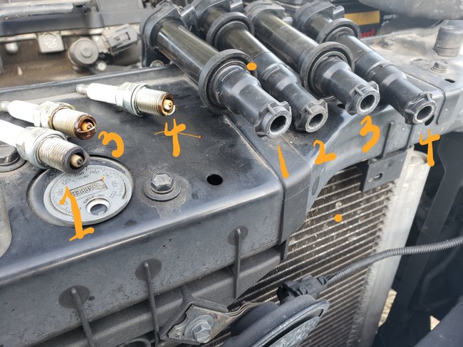

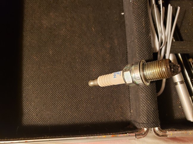

So the spark plug marked one I took out of the far left cylinder. If notice 3 and 4 have oil and 1 is burnt dry. Also the ends of the coils the spark plug go into have a white residue. Multi-meter tests tell me the coils are bad.
Thoughts?

The white residue on the ignition coils is normal.It was hard to tell from your video how much oil was in the spark plug tubes due to the video being cut off at the bottom and didn't show.It's kind of hard to believe that all 4 coils would fail at the same time. I've attached the testing procedure and specifications below.Let me know if the coils are within the specifications and we'll go from there.Hope this helps and thanks again for using 2CarPros.
Danny-
Aug 5, 2020 at 3:31 PM
Okay, the oil is from the seals for the tube from the valve cover gasket.
What check told you the coils were bad? What were your readings that make you think the coils are bad?

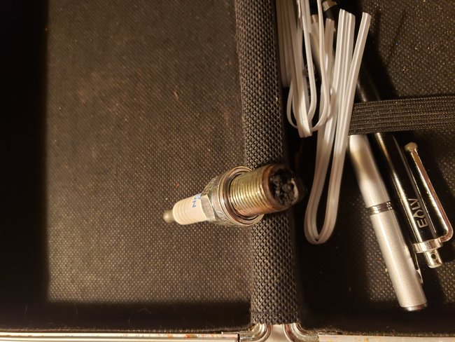

I cam across the spark plug I originally pulled out when car started having problems and had to clear out the catalytic converter, but that didn't entirely fix the problem so I went and replaced the spark plugs. I got the car from my cousin and it's never had a tune up. But thought I'd share how bad it was when I pulled this one out of the cylinder all the way to the right.
Aug 9, 2020 at 8:37 PM
They are really bad. Good that you replaced them.
