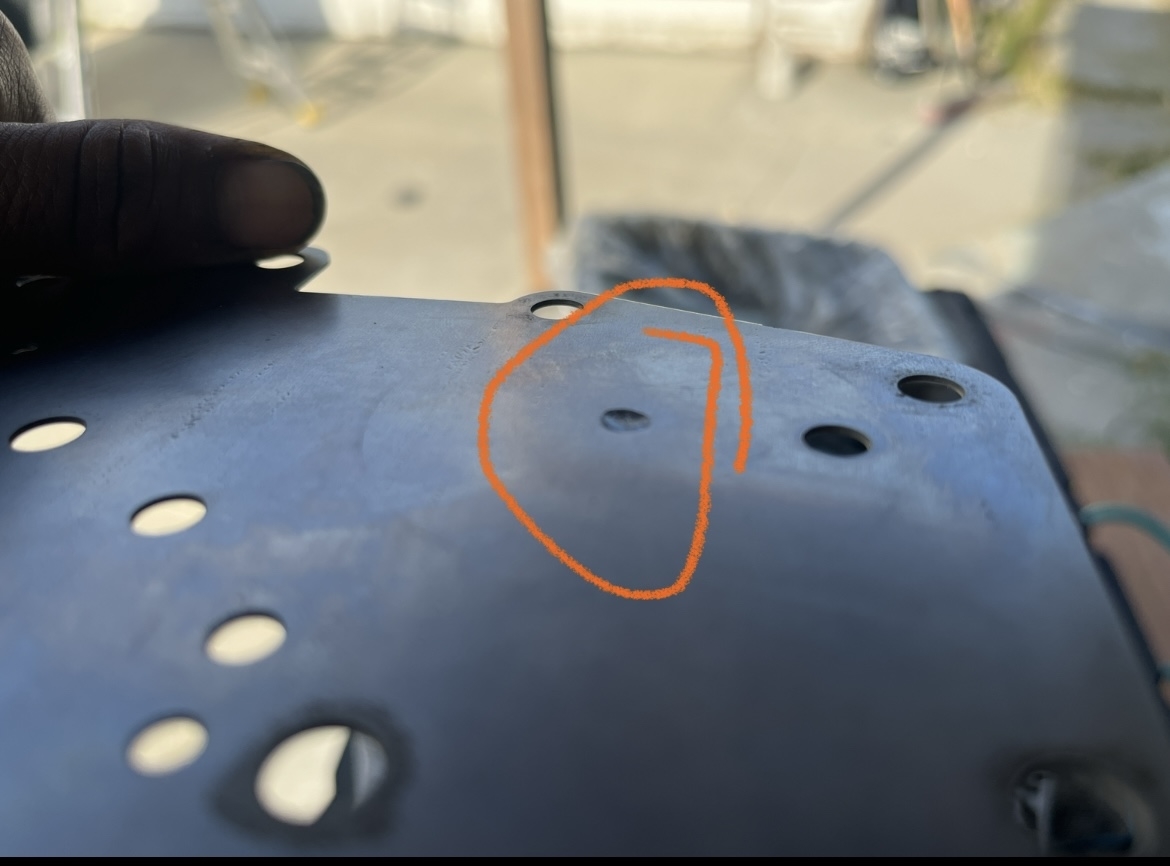

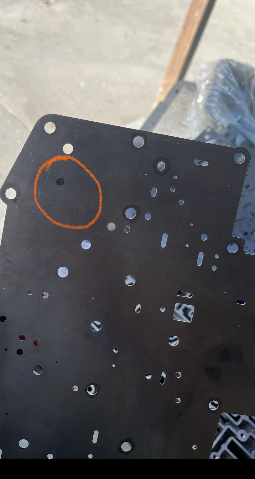

What about this? This is where one of the circular plates go. I took pics at two different angles so that hopefully you can see that it’s indented slightly.
Wednesday, June 8th, 2022 AT 5:47 PM
Yeah. I have seen that before and never known it to cause an issue.
If you would sleep better at night, then I would replace it but otherwise I think it is fine.

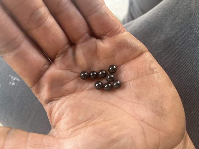

Can I reuse the check balls? None of them look like they’re worn. They’re all the same size.

I think I found out what that indent was that’s located near where the small circular plate goes. It’s made by the manufacturer to keep the plate from flexing and cracking. It’s only located in that spot, on models 2000 and up according to a video I watched of a mechanic rebuilding the valve body. He said if there are small pressure cracks right there then you need to replace the plate because eventually with more pressure the cracks will get larger.
Wednesday, June 8th, 2022 AT 8:57 PM

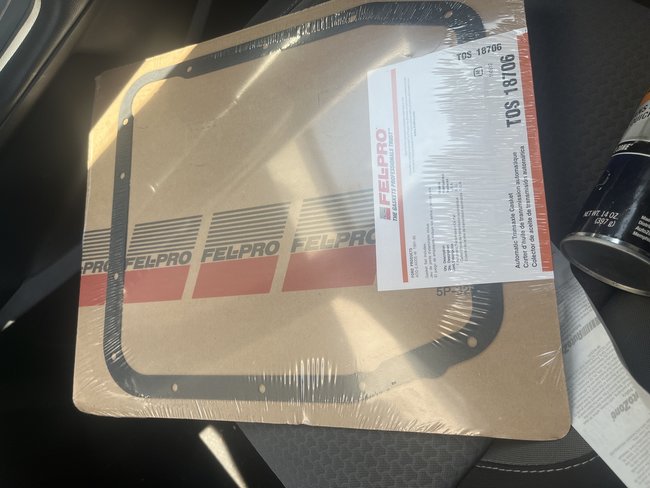

Can I use this on the transmission oil pan? It’s what came up when I input the vehicle info, but it looks a lot different than the original. Holes line up though.

Okay. That is great info. Thanks for sharing that which explains why I have seen them before, but I didn't know that. Thanks
As for the check balls. Yes, you can absolutely reuse them.

Or is the original reusable?
Thursday, June 9th, 2022 AT 12:27 PM
You mean is the oil pan gasket reusable?
The only reusable gaskets are the hard rubber/plastic ones that are in good condition. Cork, paper, bendable rubber gaskets are not able to be reused.
I don't think this pan came with the hard plastic/rubber ones, so you need to use a new one.
You can get a gasket in any type of material for most any pan so you can pick the one you want to use.
Thursday, June 9th, 2022 AT 2:04 PM
ARIANADANIELLE5345
  • 323 POSTS
The original is hard rubber, but I can't tell if it’s in the best condition. The new gasket is way thinner, but is it still okay to use? Okay cool. That works for me, lol.
