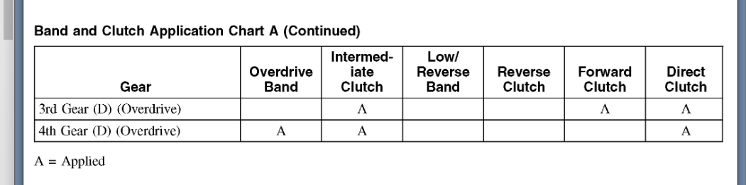

This could be the overdrive band, but we need to find out a little more info as to when this slips.

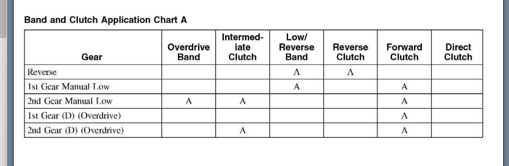

Can you put it in manual 2 and leave the OD on and see if it slips.
If it still slips, then this could be the intermediate clutch or the overdrive. So that means we need to put it in drive with OD still on and see if when in 2nd gear at this RPM it slips. If it does in 2nd with OD on, then this is most likely the intermediate clutch that is slipping.
Also, we should check the fluid level and condition before we do anything just to be sure that is correct.
https://www.2carpros.com/articles/how-to-check-and-add-transmission-fluid
If you look at the attached info, the overdrive band is only applied in 2 manual and 4 overdrive.
So, we need to try and find out if the slipping only occurs in these gears to narrow down what this could be.

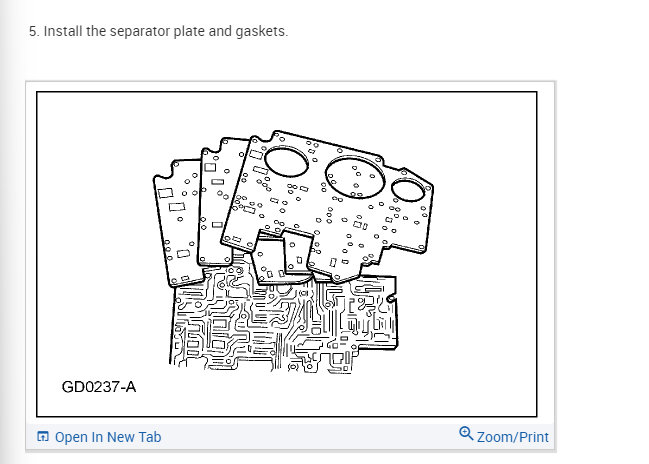

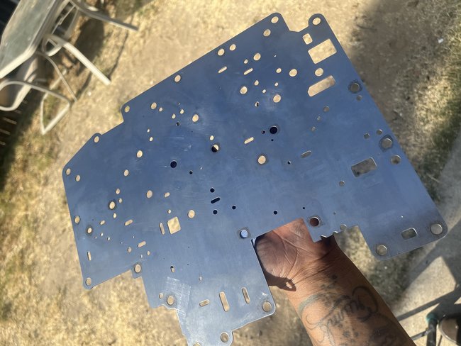

Can you get a picture of the separator plate if you have not already put it back together? I think I know what you are talking about and that is most likely fine but seeing it will help.

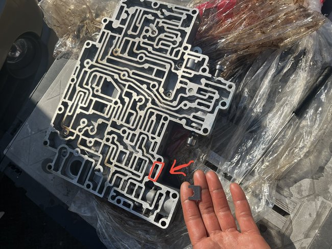

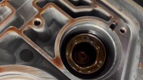

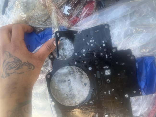

The red arrow is the one that’s sticking and not springing back out and the red rectangle is where the thing in my hand came out of.

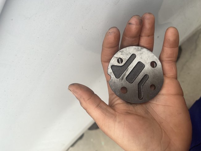

And the second pic is the black stuff that chipped off. Actually, when I went to pick it up to take the pic it started peeling off.

Got it. Yeah, that black plate needs to be replaced if it is that bad.
Sometimes the edges start to chip but if there is a crack in it then it needs to be replaced or you can have a fluid leak that will bleed off pressure. That black part is actually the separator plate gasket. There should be one on either side. See below for details.

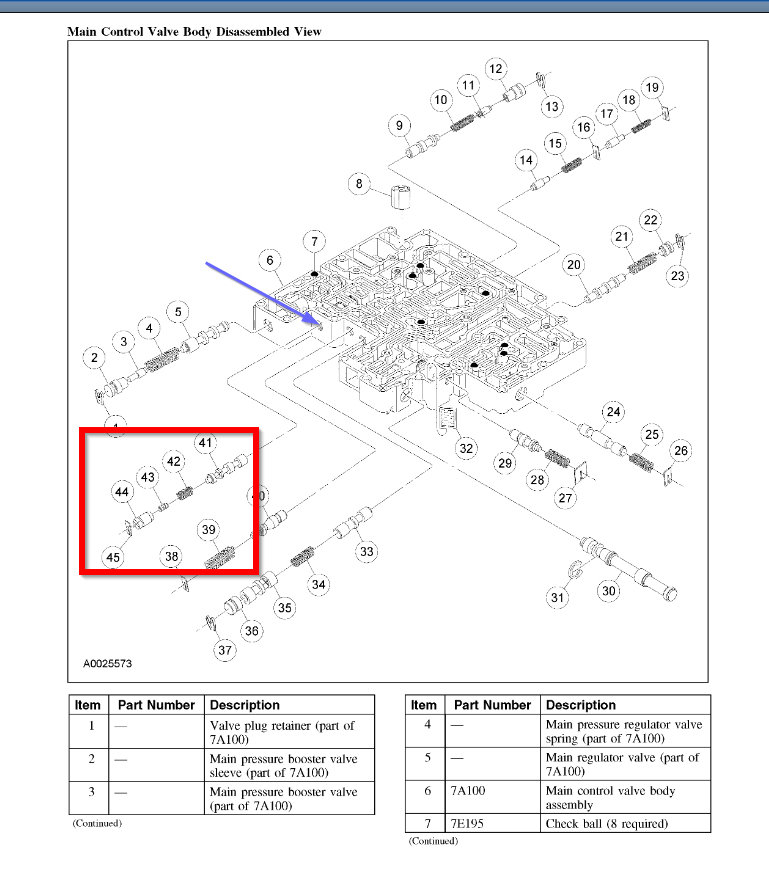

If that valve is stuck then that could be the issue. That is the bypass valve and is used to control pressure and fluid flow. I am attaching info below on that.
Basically, there is either debris or build up on the valve or in the bore. So, take some Emory Cloth or steel wool and lightly sand it down so that the valve slides in and out smoothly.
The piece in your hand is the control valve plate that holds the valve in.
Let me know if you have questions with this.

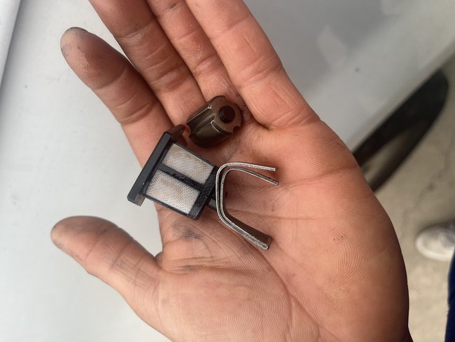

Actually, I do have a couple more questions. The first picture is of what fell out of my transmission onto the floor when I pulled the valve body off. Is it bad that that stuff fell out? If not, then what are those where do they go? Also, the second picture is of one of the little circular plates that goes on the valve body. I was told since I took them off, I would have to replace them or else they would leak. Is that true?

Also, I don’t need a new separator plate, right? Just the gaskets?
Jun 7, 2022 at 1:57 AM
Yes. The separator plate can be reused. Gaskets need to be replaced.

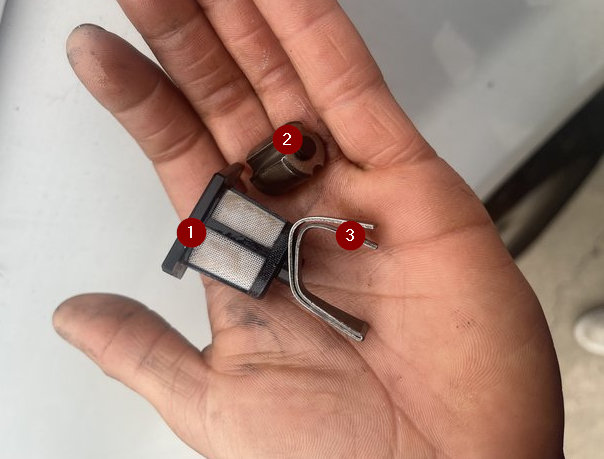

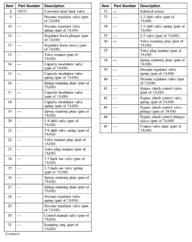

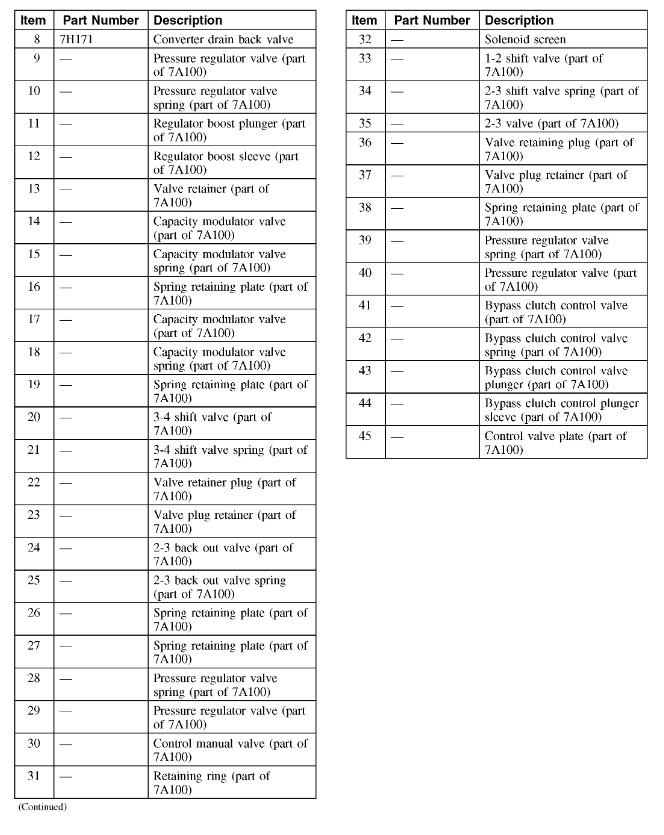

If you take a look at the picture below. Number 1 is the solenoid screen
Number 2 is a converter drain back valve.
Number 3 I am not sure about. That looks like a cotter pin, but I am not sure where that goes.
Take a look at the attachments above of the exploded view of the valve body to show where they go.

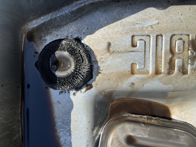

The fluid was really dark and this is what the magnet looked like:

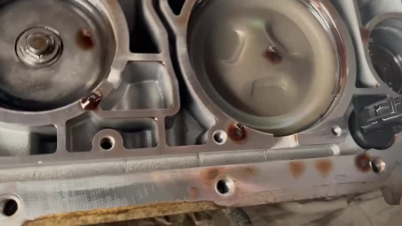

Are these spots, okay? I can’t get them off.
Jun 7, 2022 at 10:00 AM
Sorry for the delay. The spots are fine. That is pretty typical on those.
You can clean everything with parts cleaner spray. Just make sure you give everything time to evaporate.
Then soak any rubber seals in transmission fluid if you are replacing them. This just prevents any tearing when installing them into a bore. However, I am not sure you have any of these because you are just dropping the valve body.
I cannot think of any other parts that you will have to replace at this point, but we are going to have to test drive it once it is back together.
If the fluid was really dark and that much metal on the magnet then when you put new fluid in it, the clutches may not like it.

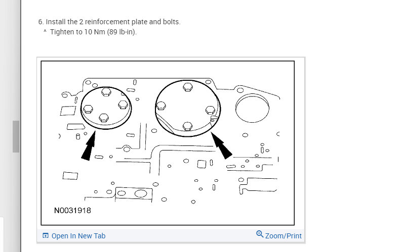

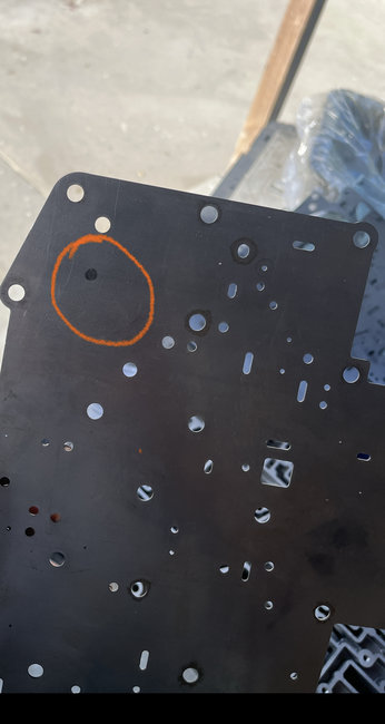

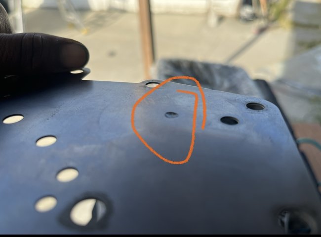

What about this? This is where one of the circular plates go. I took pics at two different angles so that hopefully you can see that it’s indented slightly.
Jun 8, 2022 at 10:47 AM
Yeah. I have seen that before and never known it to cause an issue.
If you would sleep better at night, then I would replace it but otherwise I think it is fine.
Jun 8, 2022 at 11:32 AM

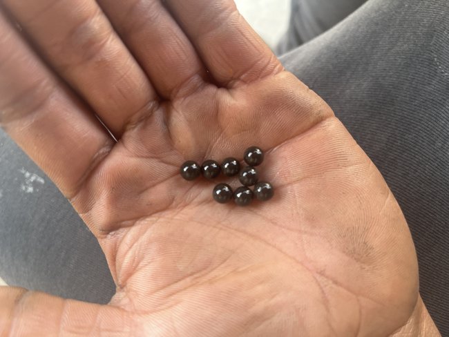

Can I reuse the check balls? None of them look like they’re worn. They’re all the same size.
Jun 8, 2022 at 11:40 AM

I think I found out what that indent was that’s located near where the small circular plate goes. It’s made by the manufacturer to keep the plate from flexing and cracking. It’s only located in that spot, on models 2000 and up according to a video I watched of a mechanic rebuilding the valve body. He said if there are small pressure cracks right there then you need to replace the plate because eventually with more pressure the cracks will get larger.

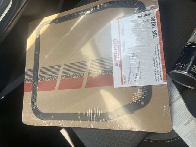

Can I use this on the transmission oil pan? It’s what came up when I input the vehicle info, but it looks a lot different than the original. Holes line up though.

Okay. That is great info. Thanks for sharing that which explains why I have seen them before, but I didn't know that. Thanks
As for the check balls. Yes, you can absolutely reuse them.

You mean is the oil pan gasket reusable?
The only reusable gaskets are the hard rubber/plastic ones that are in good condition. Cork, paper, bendable rubber gaskets are not able to be reused.
I don't think this pan came with the hard plastic/rubber ones, so you need to use a new one.
You can get a gasket in any type of material for most any pan so you can pick the one you want to use.

Okay, so change of plans. I went to the Ford dealership to ask the service guys some questions. They told me that the cotter pin looking thing goes in between teeth on clutches or something like that and without it it’s going to clunk really loud, and it’s caused by a worn transfer case. And they also said all that sludge on the magnet means the torque converter is going bad so that means a rebuild. Complete rebuild. So, would you happen to have the instructions on that along with a complete parts list? And will I need any special tools? Or should I ask this stuff in a new question?
Jun 9, 2022 at 10:15 AM
While you may have been okay, I think this is the best course of action. Especially now that you know where that piece of metal came from.
Yes. Let's get a new post started asking for rebuild instructions. That is really good info that we want to make sure all others in the future are able to find.
