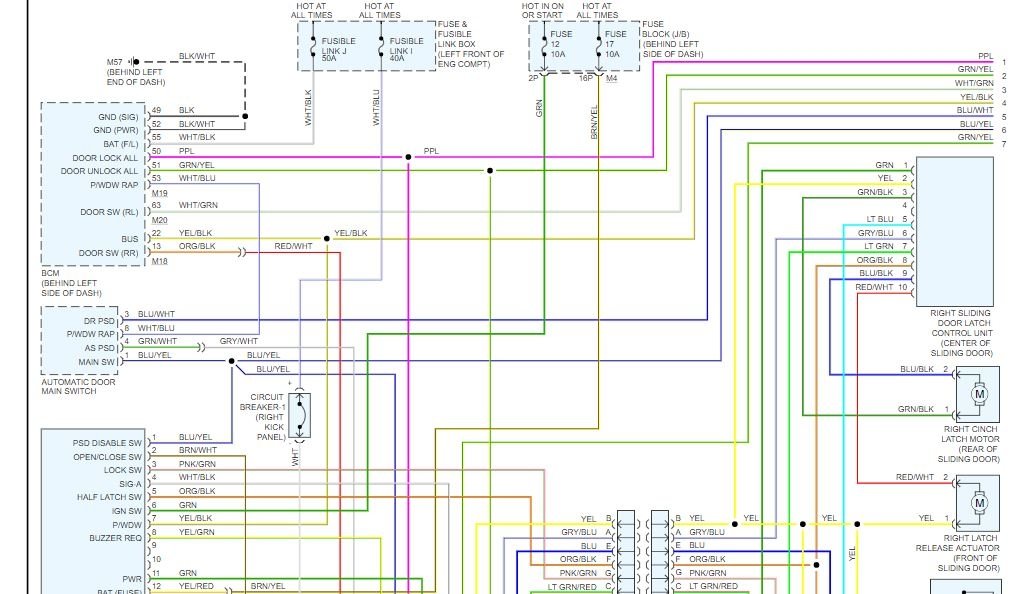

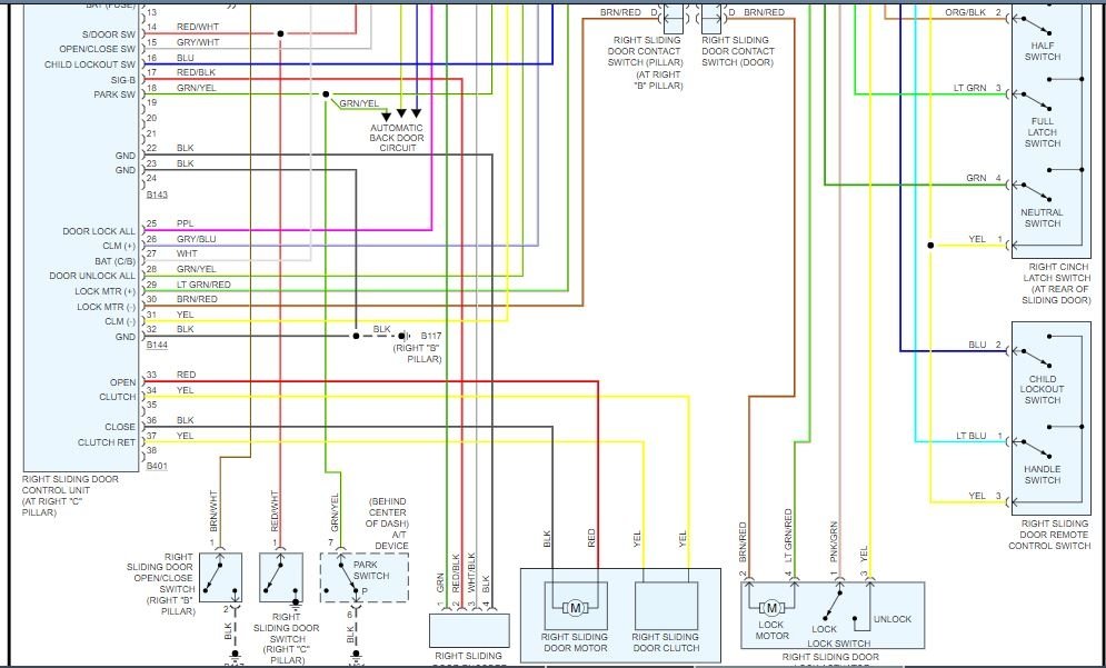

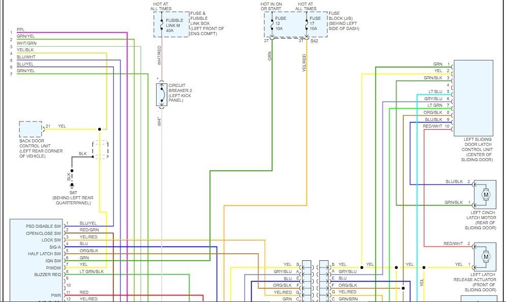

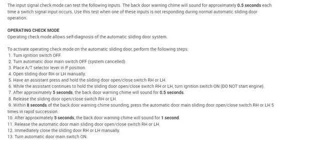

I can push the over head button to open the driver's side sliding door and it opens. When I try to close it, it only beeps. I have to pull the door closed manually.i want to figure out what is wrong and fix it myself.
Mar 19, 2020 at 6:38 PM
Good morning,

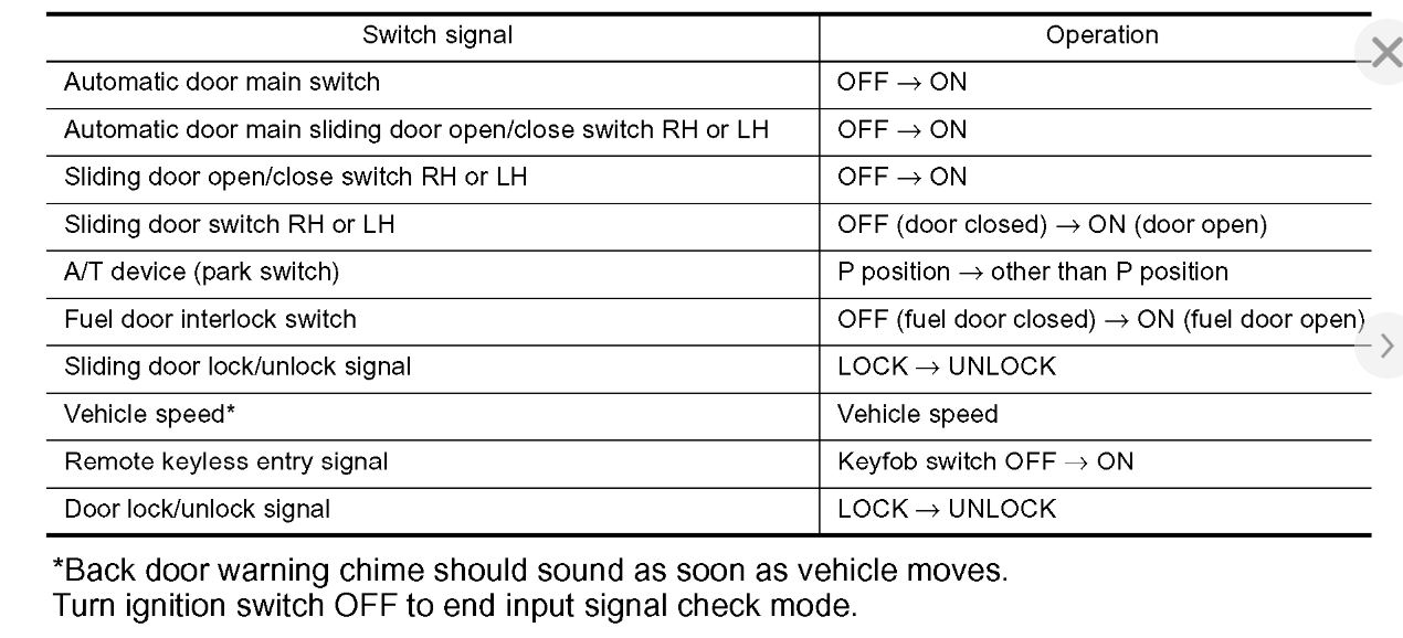

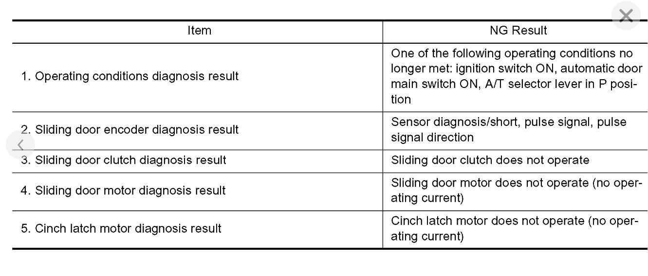

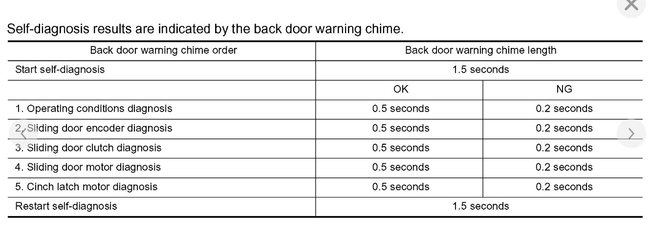

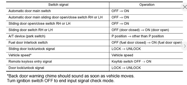

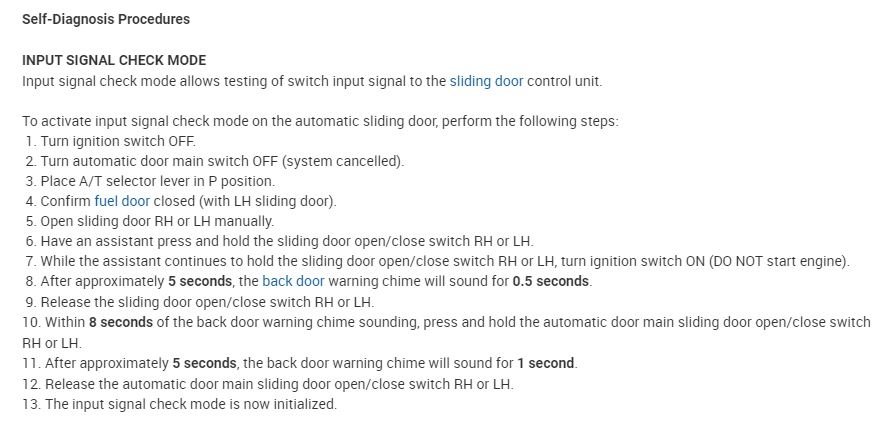

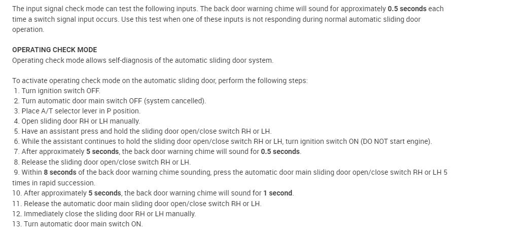

There is a self diagnostic for the doors. I attached them below for you to follow.
It is a little involved but follow the steps exactly and see what you come up with.
