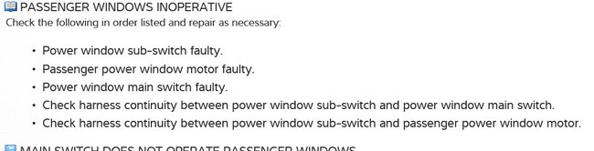

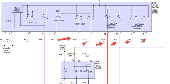

Front passenger and both rear passenger windows inoperative. Drivers side window operating normally.
Jul 26, 2016 at 4:28 AM
HMAC300
  • 48,601 POSTS
see pictures for what to check, then check to see if power is going to other windows when you push main switch if it is it may be motors or the switches.
