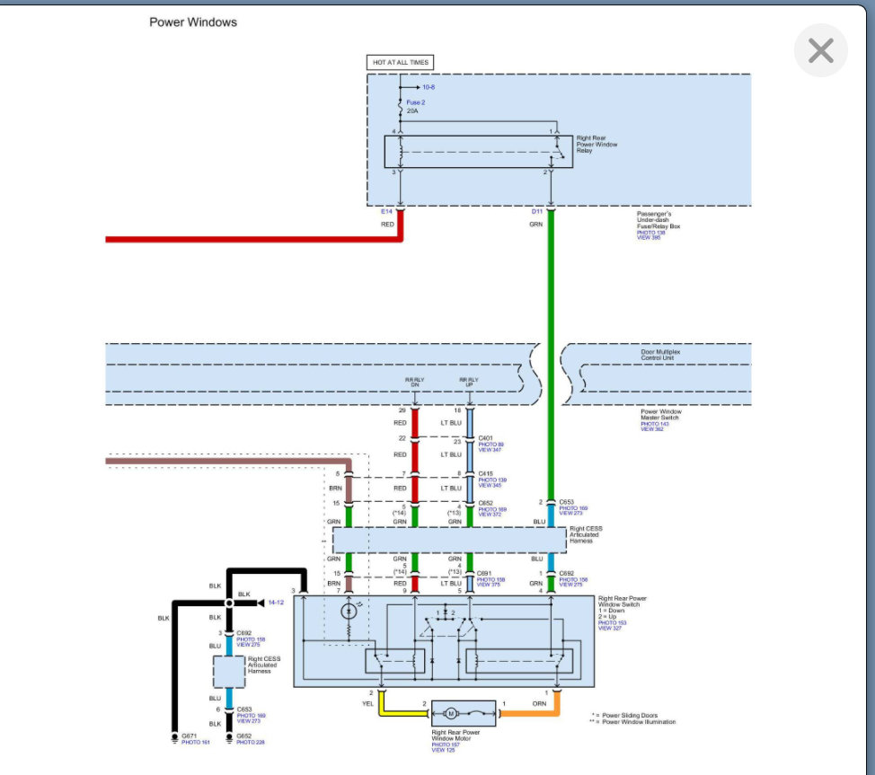

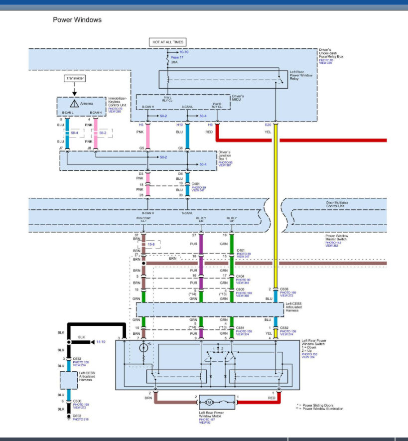

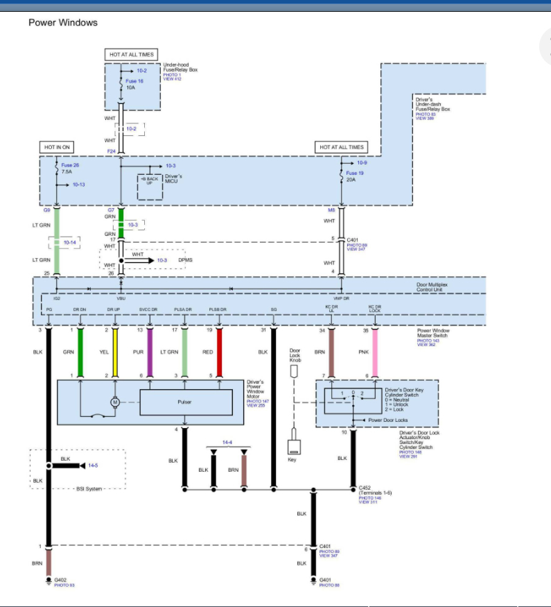

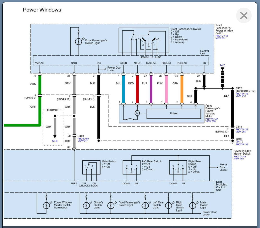

I am attaching the wiring diagram below of the switch but basically, we want to just see if there is voltage coming out on the purple wire that is going to the left rear power switch.
So, the way this works is the master switch sends power to the other switch which is a pass through to the motor.
So, we need to see if the power is even leaving the master switch and go from there.
