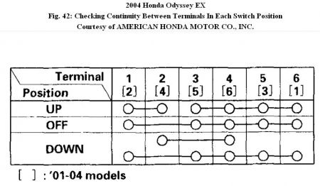

Start by testing the passenger window switch first. PASSENGER'S WINDOW SWITCH TEST 1. Remove the front passenger's switch from front passenger's door panel
https://images.2carpros.com/forum/automotive_pictures/192750_PassengerWindowSwitch04OdysseyFig41_1.jpg
2. Check for continuity between the terminals in each switch position according to the table.
https://images.2carpros.com/forum/automotive_pictures/192750_PassengerWindowSwitch04OdysseyFig42_1.jpg
3. If the continuity is n ot as specified, replace the switch.
