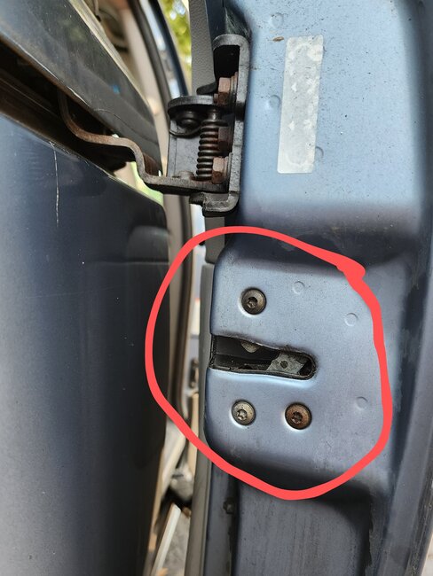

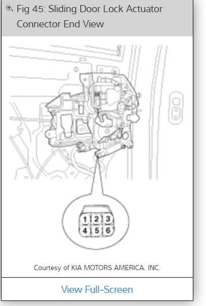

While closing my sliding door it wouldn't latch. It was a bit before the end. After some troubleshooting, I realized it's the door latch. The mechanism doesn't open up when the handle is pulled. The only way to close the door is to pull the handle while using a screwdriver to pop the latch mechanism open. Tried oiling it already.
How do I fix it? Is there a spring or cable or something that snapped?
Thursday, March 21st, 2024 AT 12:48 PM (Merged)
KEN L
  • MASTER CERTIFIED MECHANIC
  • 47,702 POSTS
Yep, the spring inside the latch has broken and it must be replaced, I don't think you can open it up for repair as a safety issue. Check out the images (below). Let us know what happens and please upload pictures or videos of the problem so we can see what's going on.

I replaced the latch. Thanks for that. Fixed that issue.

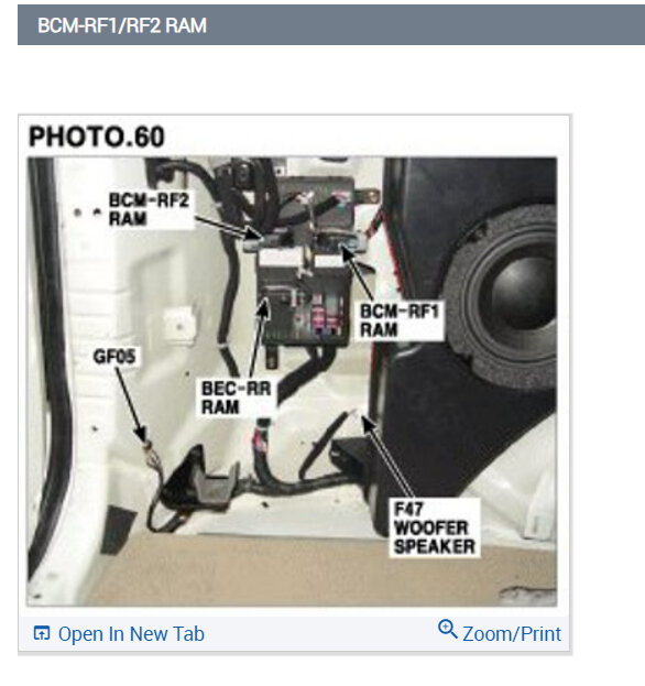

I have a very weird problem in that most days my power sliding doors work fine. At seemingly random times, however, I'll try opening the doors and they'll only open 3/4 of the way and not let me open it any further even when I try manually opening them. This will happen to both sliding doors at the same time. I'll try it again a few hours later and then they'll be working fine again. I can't figure out what's causing it. 99% of the time they're fine.
KEN L
  • 47,702 POSTS

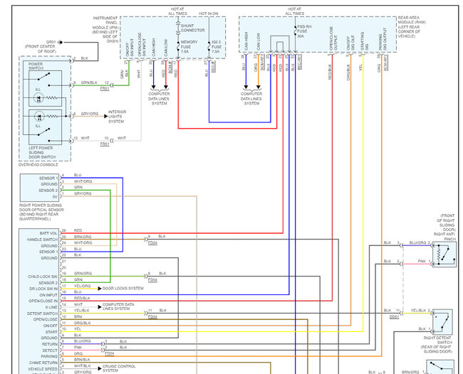

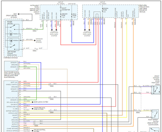

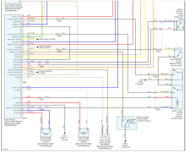

Yep, it sounds like the door sliders need to be lubricated or the RAM (Rear Area Module) module is going out. To be sure we should do a CAN scan to see what comes up, you can get a CAN scanner (Controller Area Network) which will work on most cars from Amazon.
https://youtu.be/u-4syLc-ifQ
Here is a wiring diagram for the sliding doors so you can see how the system works. Check out the images (below). Let us know what happens and please upload pictures or videos of the problem so we can see what's going on.

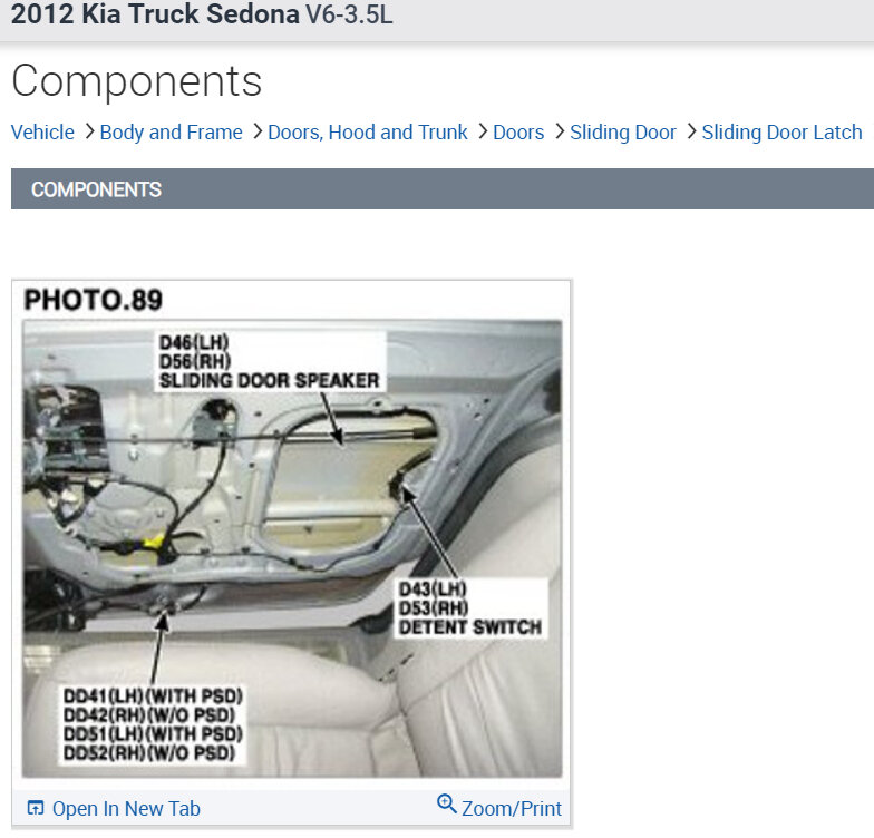

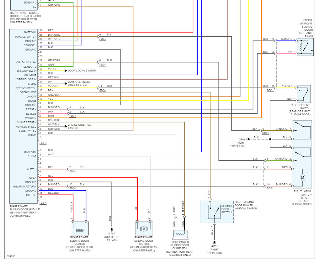

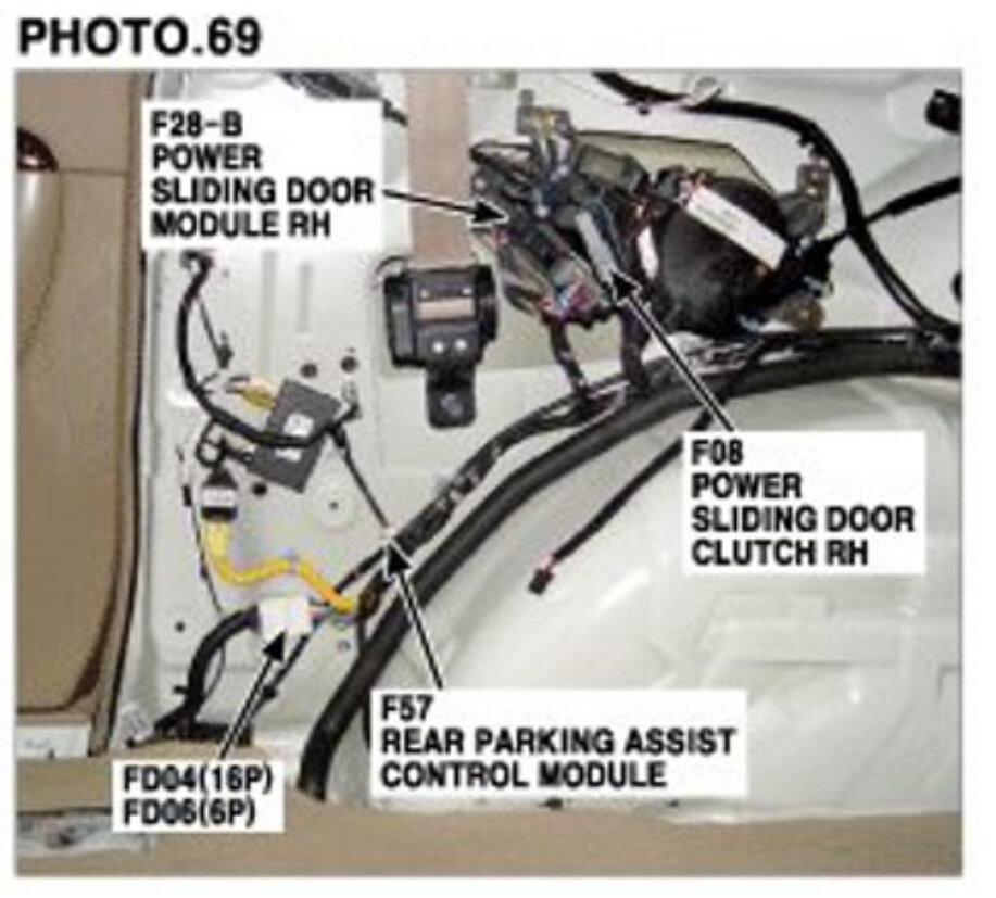

I see online that there appears to be known issues with the sliding doors on the Kia Sedona. But I'm lost about if it's the same problem I have now or how to go about fixing it. My passenger sliding door seems to have no power. Doesn't beep from the button, handle, or overhead button. Won't power open or closed at all. However the windows and power locks still work.
Tuesday, May 28th, 2024 AT 9:48 AM (Merged)
EZEX
  • 49 POSTS
Based off this forum post (https://www.kia-forums.com/threads/rear-power-sliding-door-dead.336560/) it seems like the Power Sliding Door Control Module 95450-4D103 might be to blame. Except I can't figure out how to access it.
KEN L
  • 47,702 POSTS
The control module is located behind the right rear quarter panel. Here is the wiring diagrams so you can see where the door gets its power from and how the system works. Check out the images (below). Please let us know what happens.

How do I get to that?
