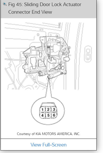

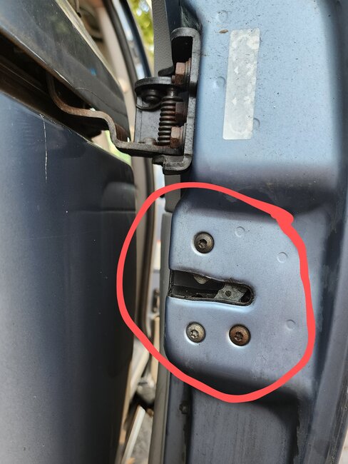

While closing my sliding door it wouldn't latch. It was a bit before the end. After some troubleshooting, I realized it's the door latch. The mechanism doesn't open up when the handle is pulled. The only way to close the door is to pull the handle while using a screwdriver to pop the latch mechanism open. Tried oiling it already.
How do I fix it? Is there a spring or cable or something that snapped?
Mar 21, 2024 at 5:48 AM (Merged)
  • 55,447 POSTS
Yep, the spring inside the latch has broken and it must be replaced, I don't think you can open it up for repair as a safety issue. Check out the images (below). Let us know what happens and please upload pictures or videos of the problem so we can see what's going on.

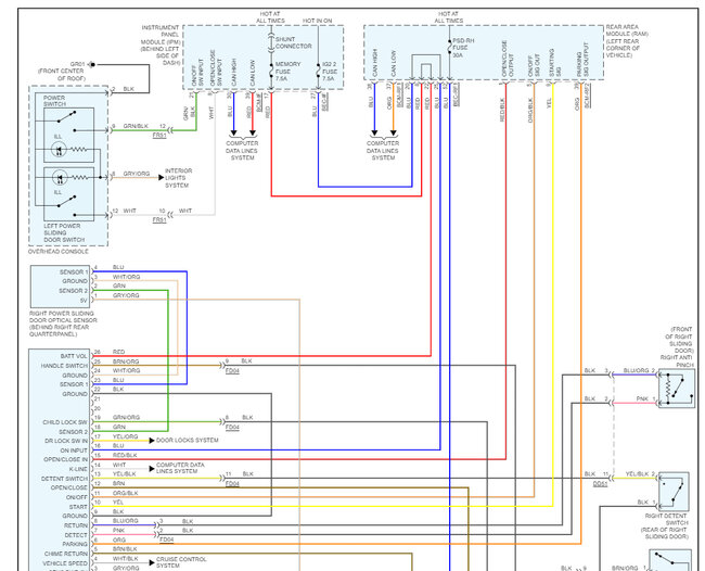

I have a very weird problem in that most days my power sliding doors work fine. At seemingly random times, however, I'll try opening the doors and they'll only open 3/4 of the way and not let me open it any further even when I try manually opening them. This will happen to both sliding doors at the same time. I'll try it again a few hours later and then they'll be working fine again. I can't figure out what's causing it. 99% of the time they're fine.

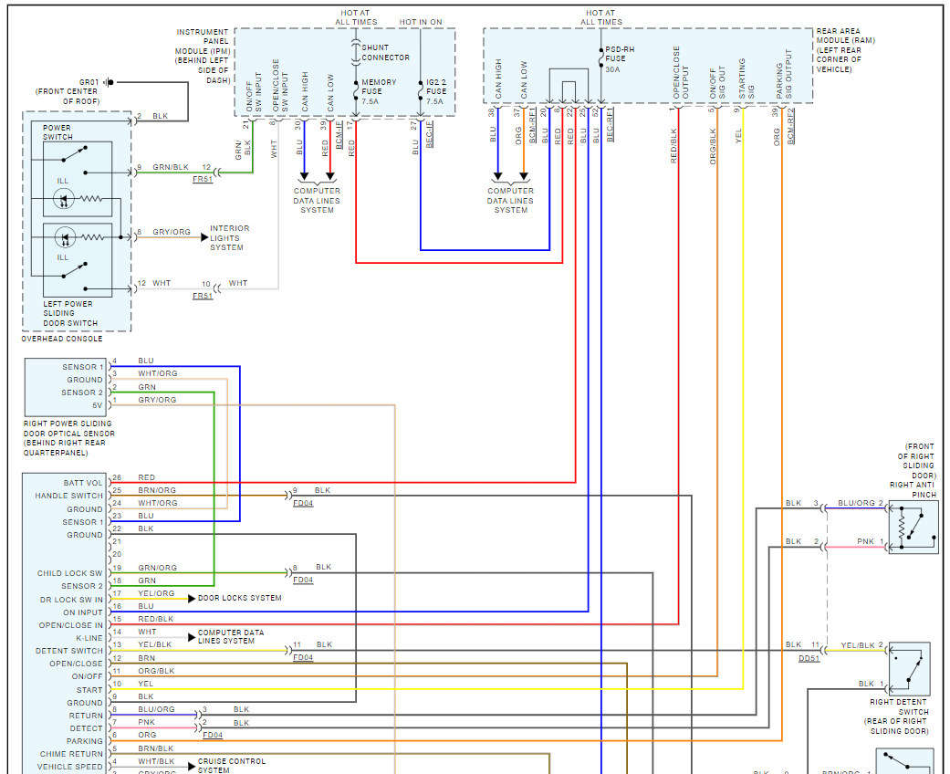

  • 55,447 POSTS
Yep, it sounds like the door sliders need to be lubricated or the RAM (Rear Area Module) module is going out. To be sure we should do a CAN scan to see what comes up, you can get a CAN scanner (Controller Area Network) which will work on most cars from Amazon.
https://youtu.be/u-4syLc-ifQ
Here is a wiring diagram for the sliding doors so you can see how the system works. Check out the images (below). Let us know what happens and please upload pictures or videos of the problem so we can see what's going on.

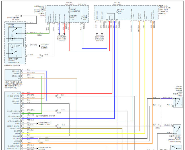

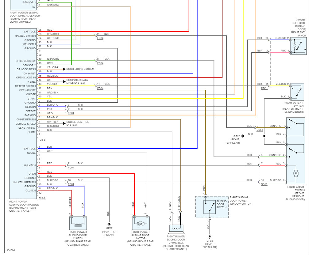

I see online that there appears to be known issues with the sliding doors on the Kia Sedona. But I'm lost about if it's the same problem I have now or how to go about fixing it. My passenger sliding door seems to have no power. Doesn't beep from the button, handle, or overhead button. Won't power open or closed at all. However the windows and power locks still work.
May 28, 2024 at 2:48 AM (Merged)
EZEX
  • 53 POSTS

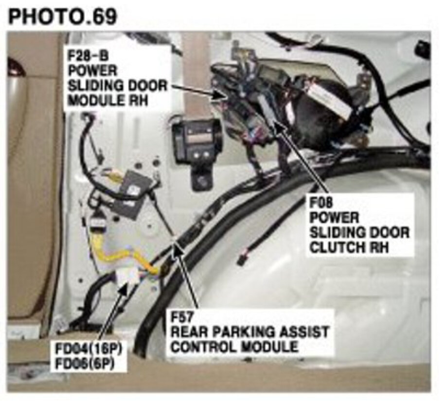

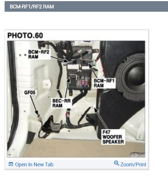

Based off this forum post (https://www.kia-forums.com/threads/rear-power-sliding-door-dead.336560/) it seems like the Power Sliding Door Control Module 95450-4D103 might be to blame. Except I can't figure out how to access it.
  • 55,447 POSTS

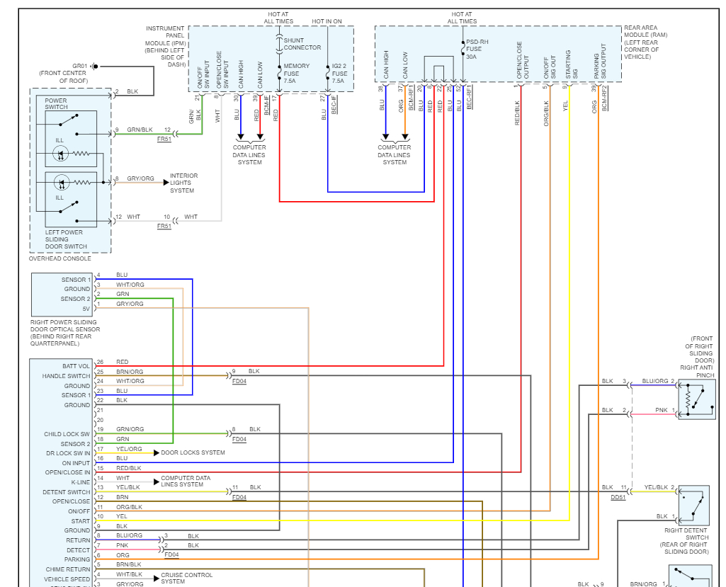

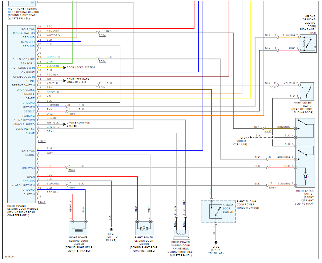

The control module is located behind the right rear quarter panel. Here is the wiring diagrams so you can see where the door gets its power from and how the system works. Check out the images (below). Please let us know what happens.

How do I get to that?
May 28, 2024 at 3:04 AM
  • 55,447 POSTS
We are professionals, so we have access to this kind of information.
May 28, 2024 at 3:10 AM
  • 55,447 POSTS
I got it from Alldata.
May 28, 2024 at 3:27 AM
EZEX
  • 53 POSTS

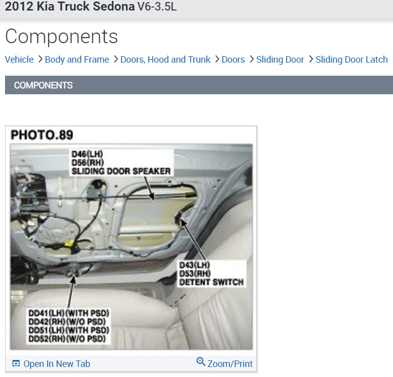

No. I meant how do I go about getting access to that area? Instructions for removal of the right rear quarter panel?
May 28, 2024 at 3:31 AM
  • 55,447 POSTS
Gotcha, here are instructions to remove the panel trim. Check out the images (below). Please let us know what happens.
