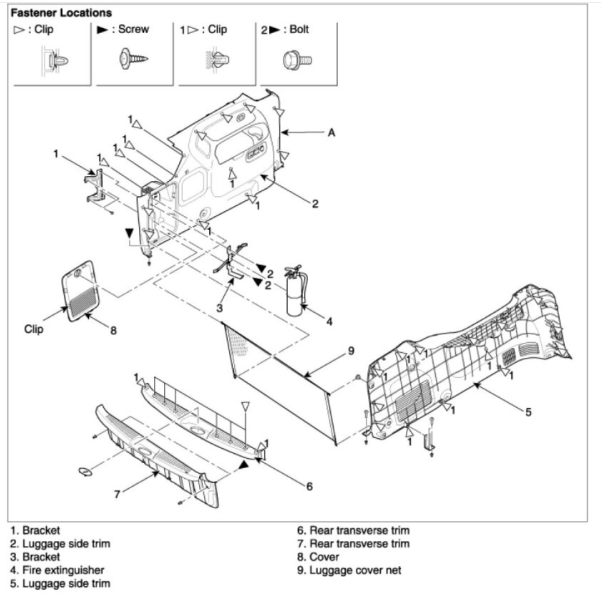

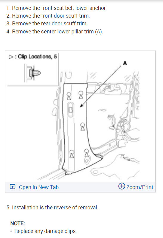

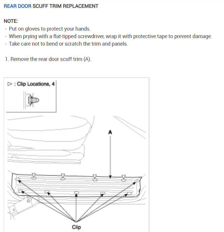

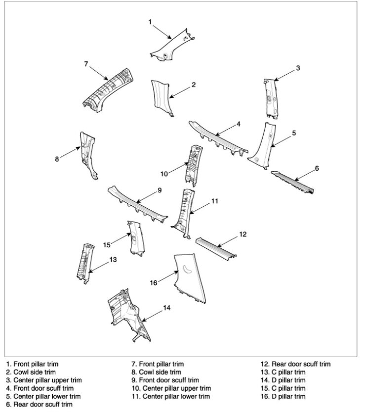

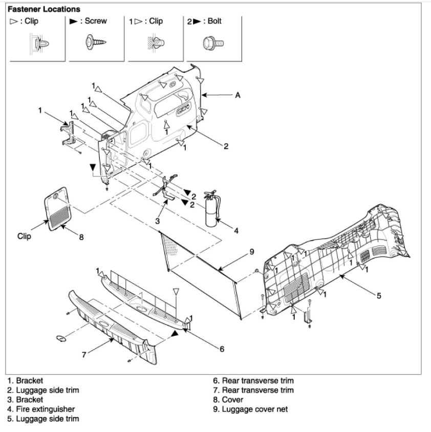

No. I meant how do I go about getting access to that area? Instructions for removal of the right rear quarter panel?
Tuesday, May 28th, 2024 AT 10:31 AM
KEN L
MASTER CERTIFIED MECHANIC
48,397 POSTS
Gotcha, here are instructions to remove the panel trim. Check out the images (below). Please let us know what happens.
