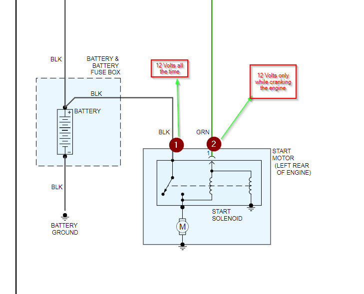

I slammed on brakes to keep from hitting this guy. He tries yanking my locked doors open. My car stalled out and now hasn't cranked. I replaced the starter and the battery.

I had no previous starting problems. It's key start not push. Yes I have power on the control wire on starter. Where is the theft light located??

Can you take a look at this wiring diagram that I attached to this reply? You should have two wires on the starter. The black wire is a direct feed from the battery and you should have 12 volts there at all times. The other wire is the control wire. You should only have 12 volts there when you are cranking the engine.
I just want to confirm this because if you have 12 volts on the control wire then the starter is the issue but you said you replaced that so it is unlikely that it is the issue. However, it could be a faulty starter right out of the box.
Also, if you are not using a volt meter, then we need to use one. A test light will tell you if you have voltage but you need 12 volts to engage the starter. So a test light will light up but you don't know if that is 12 volts or 8 volts.
Let me know and we can go from there. Thanks

The starter is fine, however the battery was dead. I replaced the battery and it tries to turn over but won't. I'm thinking I need a larger cca battery. The one I just bought has 700 cca.
May 31, 2020 at 1:20 PM
700 cca battery is more then large enough to start your engine. Can you get a video or what this is doing when you say it is trying to start? I think seeing it will get me on the same page with what you are seeing and we can figure this out. Plus, how did you confirm the starter is okay? I think this is where I am getting confused and the video will solve that. Thanks
