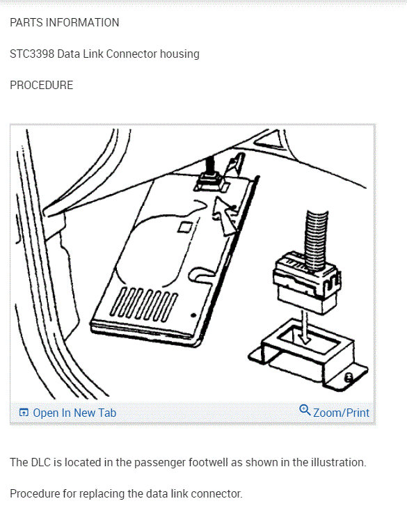

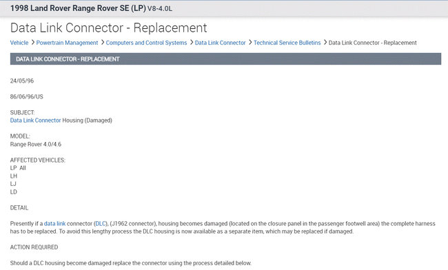

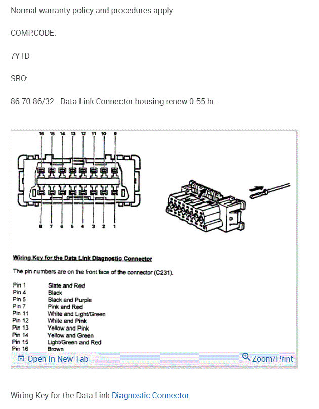

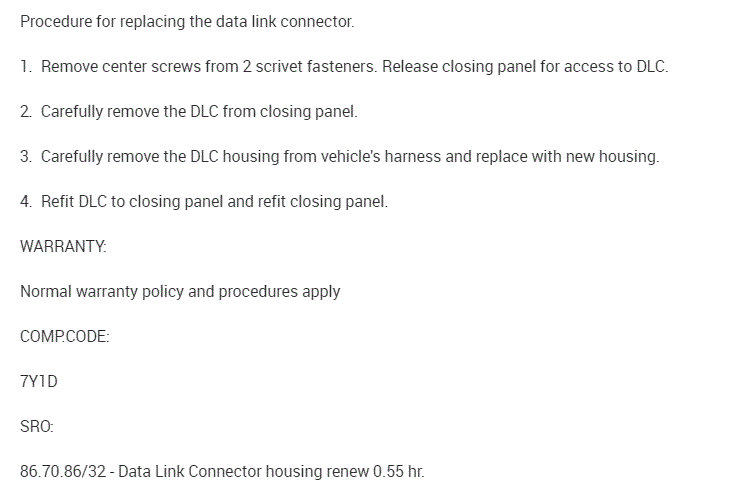

There was a technical service bulletin (TSB) out regarding the data link connector failure. Take a look at the TSB and let me know if that has been checked or performed.
Also, if you get one click when trying to start it and nothing more, that usually indicates a weak connection or battery, faulty starter motor, or a locked engine. Have all of these things been checked?
Let me know what pin you are checking for continuity as well.

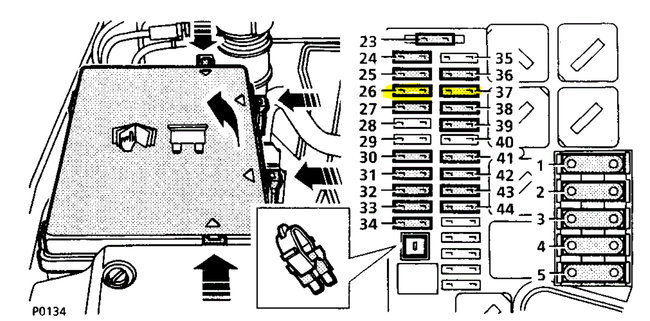

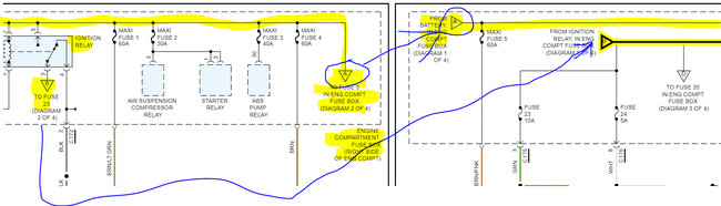

Okay, we have no spark or fuel. We need to check a couple of fuses and other electrical components.
First, if you have a live data scanner, see if there is an RPM signal when the engine is cranking and let me know.

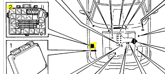

Next, under the hood there are two fuses we need to check for condition and if there is power to them. I attached the entire powertrain management wiring schematic below. It was two pages long, but I had to cut each page in half to make it readable for you. I did overlap them and highlighted the wiring related to the ignition coils and fuel injectors.
Start there. There is a main relay in the under-hood fuse box that powers both components. We need to confirm there is power to it and ground. The fuses are 26 and 37. Fuse 37 powers the relay and components. If you look at pic 1 below, note there is a blue wire with a red tracer. That provides a ground path for the relay to energize via the PCM. So first check the fuses, then the relay itself, and then if they are good, confirm a ground path when the key is turned on. If this fuse or relay is failing, you won't have an injector pulse or ignition spark. If there is another relay in the box that has the same part number, switch them to see if it makes a difference. If there isn't, I included a link explaining how one is checked.
Also, when checking the fuse, it is also important to confirm there is power to and from it. Here are the links you may find helpful:

Thank you, sir, for your support. I have seen the schematic diagram and
the guide to fixing the problem. I will check these and give you a
feedback.

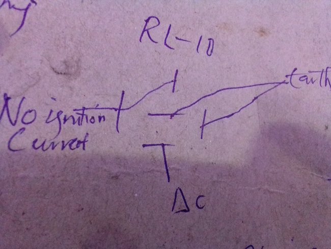

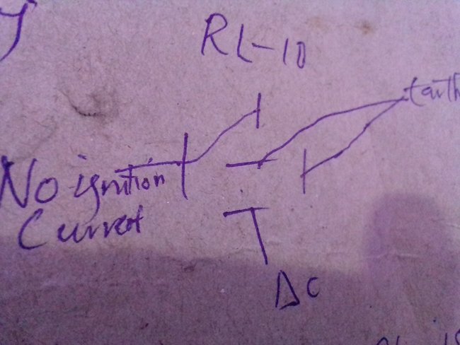

That is what I got there- in one side ground was lacking in the relay connector and on the other side the current was lacking. In the fuse location that you highlighted, there was no current in both places until when I connected a current from inside the car to where I noticed a short of current to the injector circuit. The challenge presently is that there was no rpm signal during cranking with my scan Tool. And it is a three-wire crank sensor. Please how should I test this aside from the live data method I used to be certain that is the crank sensor that is faulty and not a problem in the ECU that is hindering the car from starting. Because there is no spark or injector pulse.
Dec 28, 2021 at 2:00 AM
DAVID DAVO ESSIEN
  • 152 POSTS
Hope there was supposed to be ground and current in that relay socket I showed.

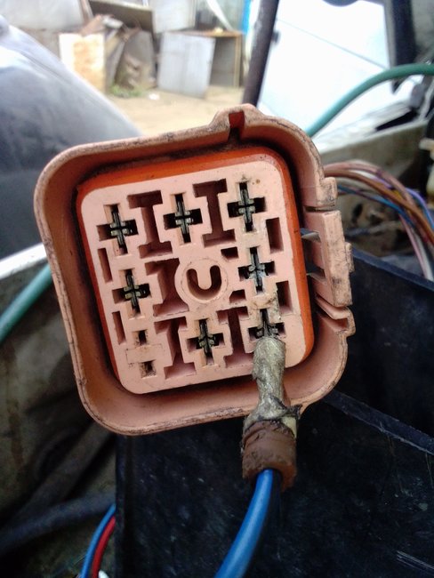

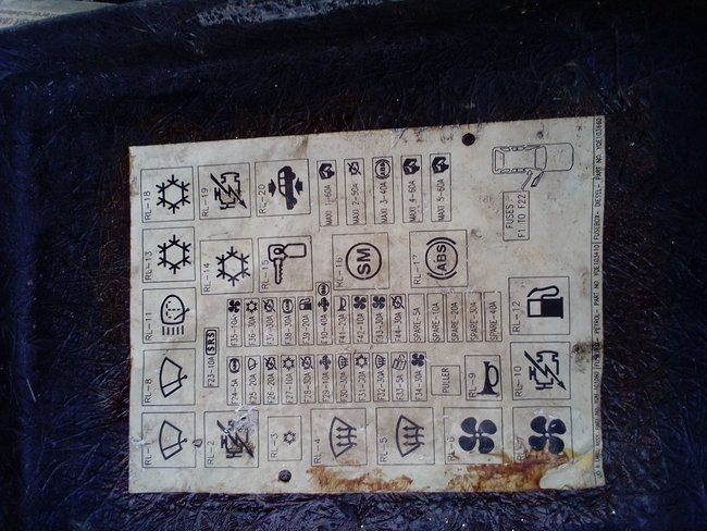

Yes, you right there was no power to the injector with the key "on" but engine off. Please can you send me the best place to connect my ignition with key "on"? The only place I see here is for A/C which I think is not best but when I tap it there the injector normally comes on with the key on but engine off.
Dec 28, 2021 at 7:44 PM
  • 110,251 POSTS
You shouldn't jump power for this circuit. Tell me, I attached a pic below and circled wires. First, is the fuse good? Is there power to and from it? Is there power out from the brown wire with an orange tracer? If the fuse is good and there is power out to the aforementioned wire, did you confirm the relay is good? If you have, check for continuity to ground via the blue wire with a red tracer. That runs to the PCM and when the PCM provides a ground path to that wire, the relay actuates, allowing power to reach the injectors. Also, note that there is a shorting link (fusible link) that could be preventing the ground path from completing. Did you check that?
I don't advise using a different power supply in this case.

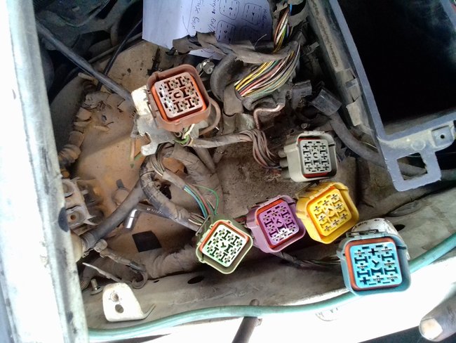

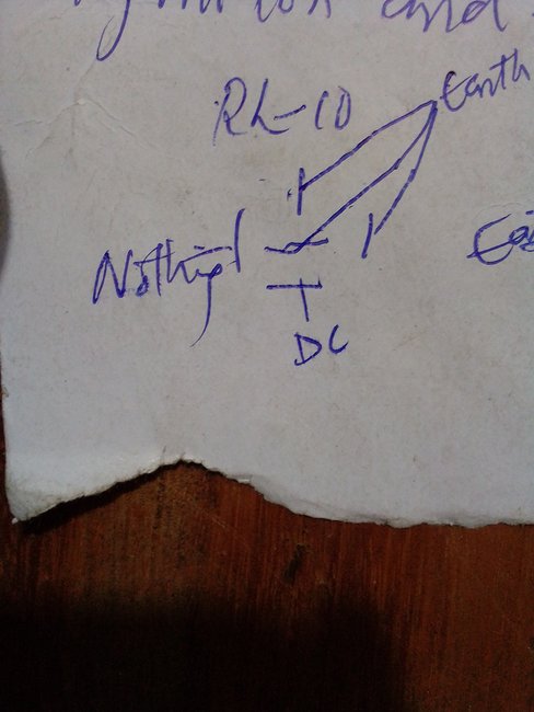

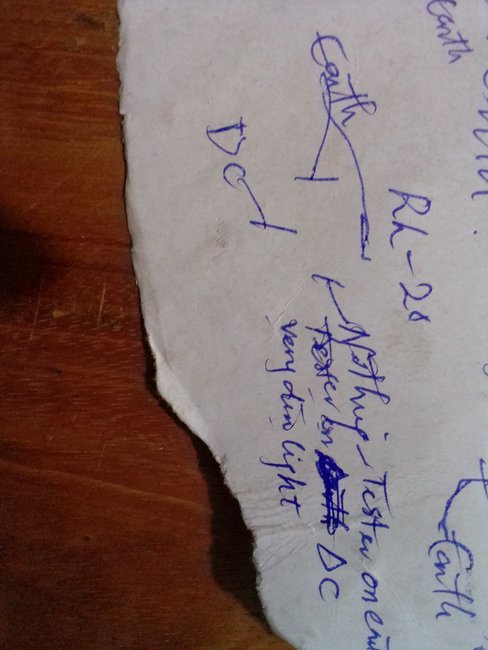

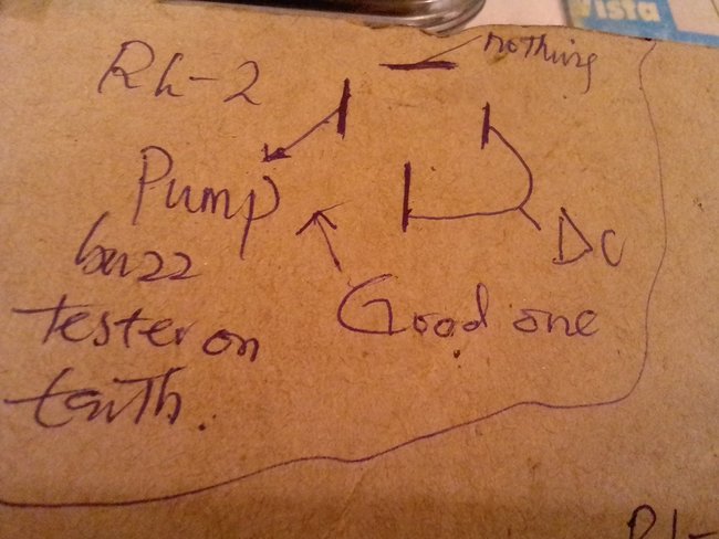

I benched tested virtually all the relay in power center. It was only one relay that felt very hot while the other was bad (RL 10 and 15). But I swapped it with a good one on different at all in terms of power to the injector wire that is brown and orange stripes. I took a picture of that wire.
Dec 29, 2021 at 8:19 AM
  • 110,251 POSTS
Were you able to confirm if there is a ground path via the blue wire with a red tracer? Also, if you have the relay removed and jump pins 3 and 5 (circled in blue below), do you get power to the brown wire with an orange tracer?

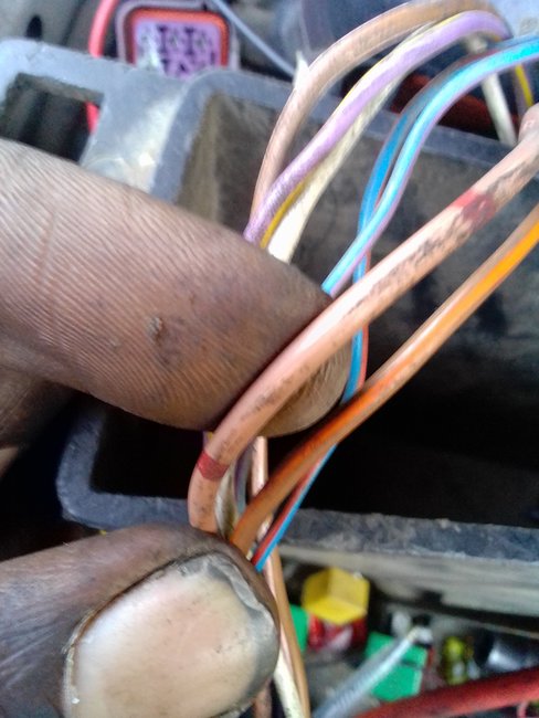

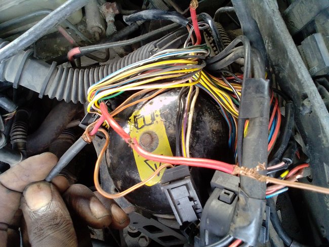

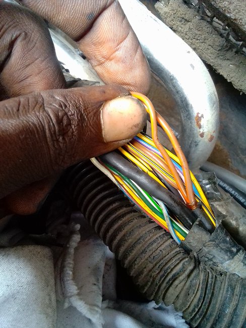

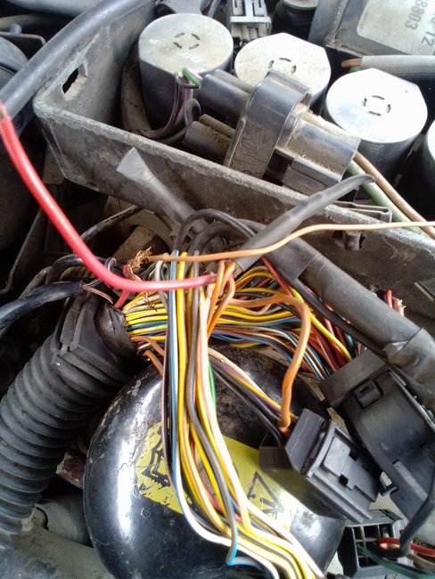

But for the brown wire there was no current but when I tapped current from that A/C system as shown below current entered the brown wire.
The wires were cut by the previous engineers that came to work on the car. There are 2 red wires, one is earth/ground wire, the other was no current nor ground that was the one I connected ignition current to before current entered the fuses and injector wires with key on.
Dec 29, 2021 at 12:58 PM
  • 110,251 POSTS
It's hard for me to determine what is happening looking at the pics. However, when you powered the brown wire, the injectors should have had power.
Let me know what you find.

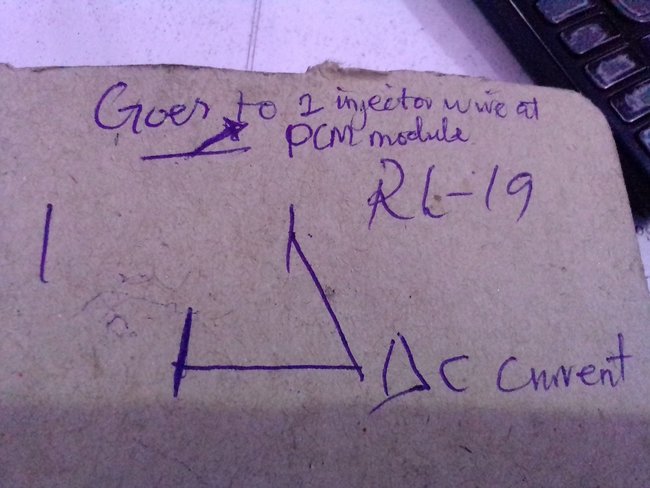

Please, I'm working on the car now which of the relay should I remove? and run the test as shown in the diagram.
Dec 29, 2021 at 7:59 PM
DAVID DAVO ESSIEN
  • 152 POSTS
That's the video showing what happens when I removed RL-19 and bypassing it with wire on.

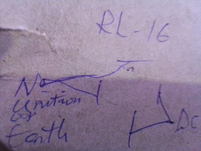

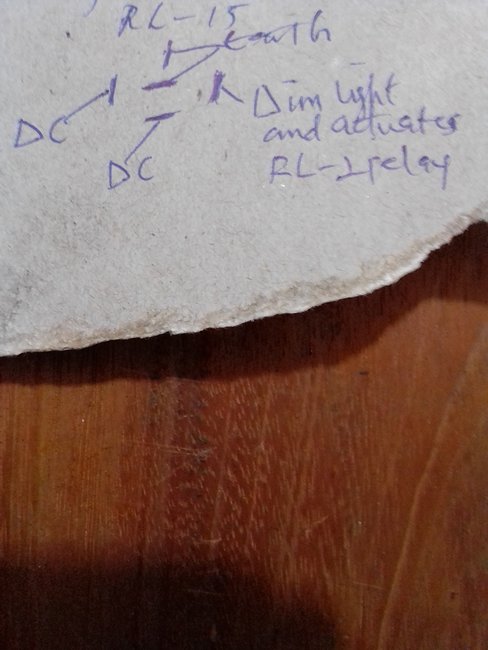

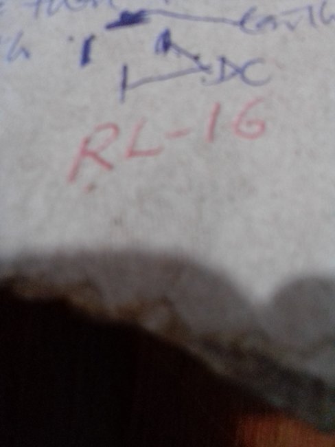

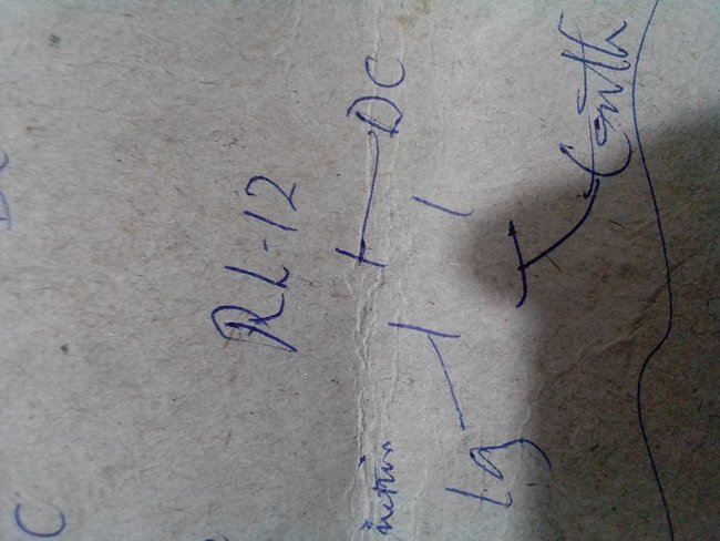

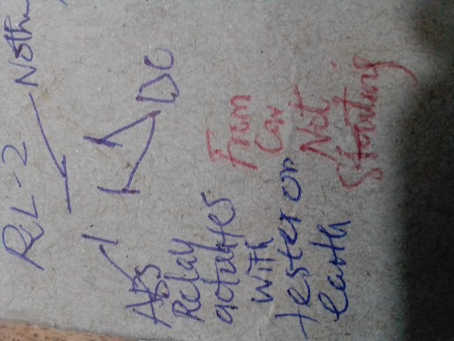

Today I requested something from the man, and he didn't hesitate but did it for me -that was to call is friend that had exactly of his vehicle whose car was starting to come to his house which he did.
When he came, I was surprised over my diagnosis? But before I proceed, I want to thank you for the information that I shouldn't tap current to that injector.
Dec 30, 2021 at 6:08 AM
DAVID DAVO ESSIEN
  • 152 POSTS
These were the things I got from the man car that was starting and driving without any issues but with the man car I got something very different in that power center.
Dec 30, 2021 at 6:24 AM
DAVID DAVO ESSIEN
  • 152 POSTS
These are the things I got from the man car that was not starting.
Dec 30, 2021 at 6:43 AM
DAVID DAVO ESSIEN
  • 152 POSTS
Same thing happens to the PCM circuit where there DC there was no DC in the car that was not starting for example the 5 wire connector had 1 earth that is black wire and blue with ignition current but the other 3 I didn't have anything either ignition, DC nor ground but in the car that wasn't starting I got 4 ignition on the other wires but no earth on the black wire.

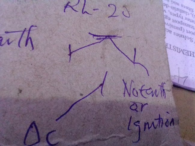

Please sir help me, what's the cause and solution to this car problem? I want the car to start what are you advising me to do?
Dec 30, 2021 at 7:05 AM
  • 110,251 POSTS
Hi David,
I want to help, but I'm starting to get confused. The pics you attached above are hand-drawn, and I'm not really clear on what they are specifically for or what was already done to the vehicle. Not being there leaves me to depend on the schematics I sent. So, if there is something other than that I'm unaware of, it really gets difficult to diagnose. I hope that makes sense and you understand.
I'm also not sure if you are getting power to the relay in both places. It is a switch and nothing more. However, for the relay to work, it first gets energized. When that happens, there is an electromagnetic attraction that closes the switch sending power to (in this case) the injectors.
I really want to help. Please let me know if the relay is getting power to actuate and when that happens, does the power go to the injectors?
I will watch for your reply. Hang in there, my friend. We'll get it figured out one way or another.

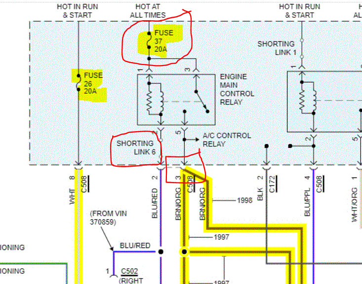

As you can see from the video there was no power at fuses 26 and 37, brown/orange wire too was not receiving power except I bypass current to shorting link 12.
Feb 2, 2022 at 10:29 AM
DAVID DAVO ESSIEN
  • 152 POSTS
This is what I noticed from the aftermarket fuse box that I later replaced yesterday with the one that came with the car. Please note sir that this other aftermarket I inserted has power to fuse 37 without any bypass of current as well as at the shorting link 12. But there was no power to fuse 26 except I swapped the tester location from negative to positive before power gets to that fuse 26. But in the previously inserted fuse box it was not so.
In addition, the blue/red wire I noticed is activating the fusible link 19 with my tester at battery negative and testing that wire. Please, what can I do next?
Feb 2, 2022 at 10:43 AM

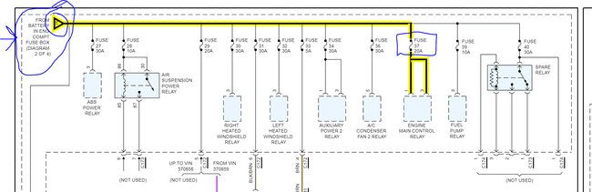

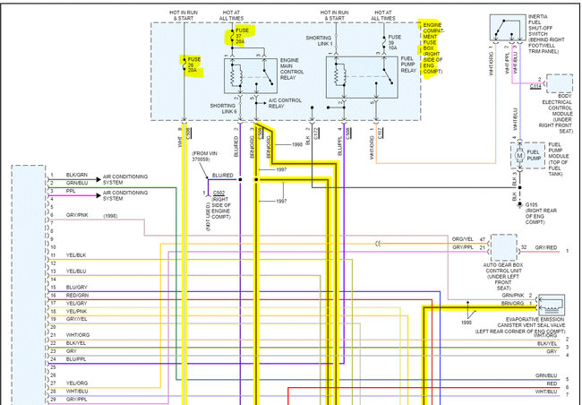

  • 110,251 POSTS

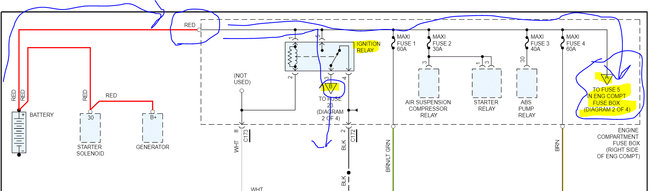

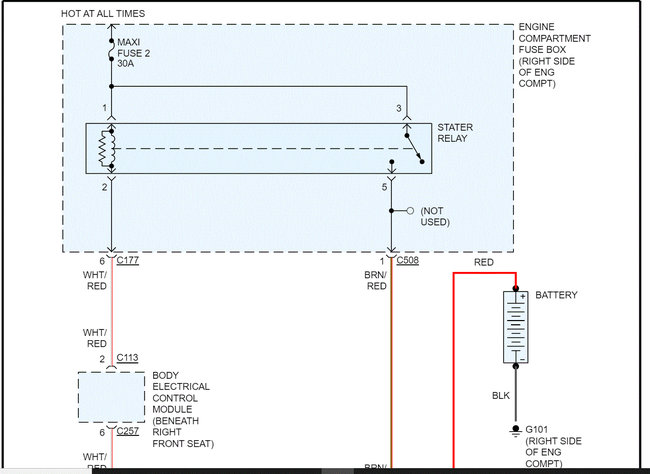

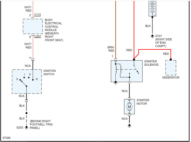

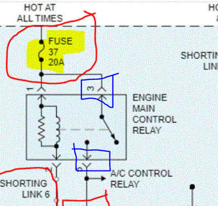

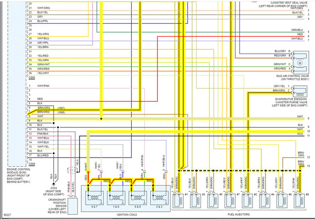

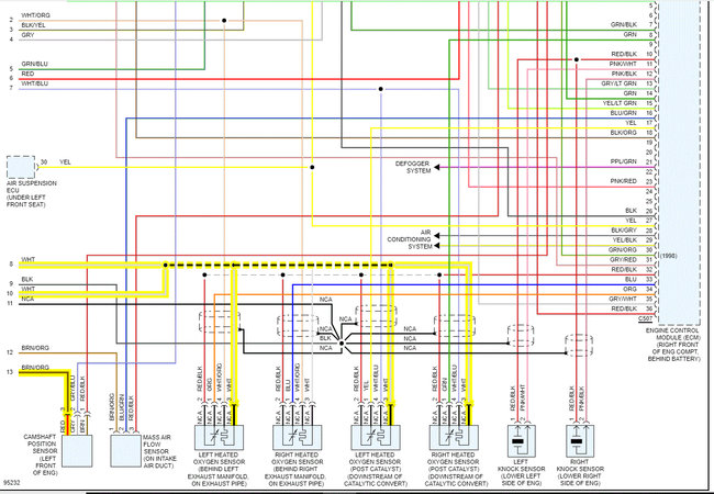

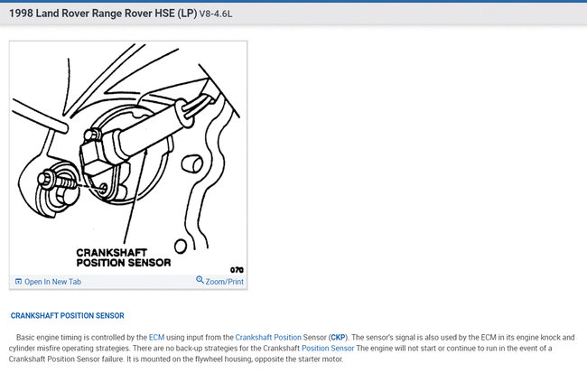

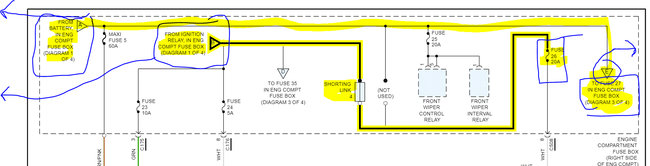

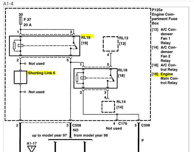

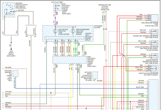

Take a look at the first 4 pics below. I start at the battery and work through the wiring to fuse 26 and 37. See if you can find where power is lost. I highlighted wires, connector identifications, fuses, relays, have blue arrows pointing to where to go next, and everything to the two fuses you mentioned.
The remaining pics are the starting system.
I hope the first 4 pics help. Let me know what you find.
See pics below. Note: Pics 5 and 6 are from one page. I cut it in half to make it readable.

Sounds good. I look forward to hearing from you. Somewhere in that circuit, power is being lost.
