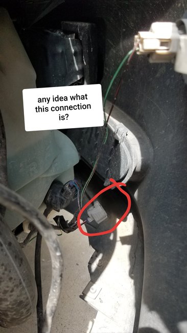

I recently encountered an issue with my car. After sitting about four to five months in the driveway my car's signal lights and hazards aren't working at all. Not even clicking. It has always worked when it was running. Now I got the car up and running, but I still can't figure out what the issue is. It's important because the car has to pass a brake and light inspection. I'll try to make sure I explain anything that could be a variable to this problem. I have installed some HID lights that my brother bought me and that had no issue with the signals because I remember flicking them to make sure and also installing the original bulbs back to check and see if that was the issue. Another variable is I left the vehicle in the driveway without the front bumper during a hard rain period in California. I've checked if all harnesses and connections are connected. I've added a picture of a miscellaneous connection that I don't know where it hooks up too. There's another two that plug into the coolant reservoir, but this one is a mystery.
Thanks in advance and excuse my inexperience lol.

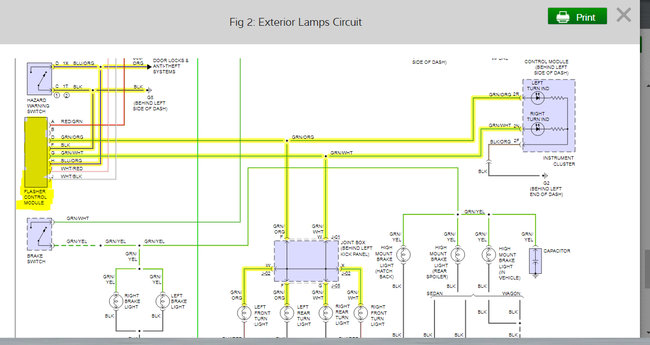

This could be a problem with your flasher control module located behind the instrument cluster in your vehicle. This control module is in charge of your vehicle's turn signals and flashers. I have included an Exterior Lighting Wiring Diagram, troubleshooting flowchart for testing the module, and directions on how to get to the module. I have also included a link below for you to go to if you are unfamiliar with how to use a multimeter, because testing the module will require you to use one.
Please go through these guides and get back to us with what you are able to find out.

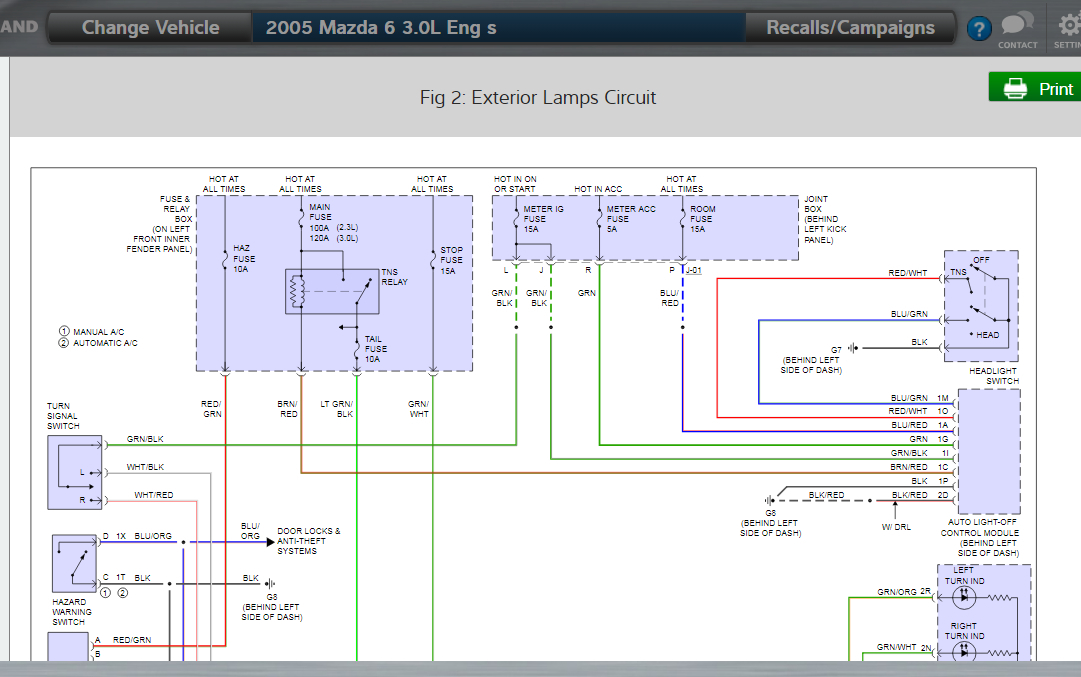

Hello thanks for the feedback, but I read that the signal lights and hazards are powered by the body control module.
Apr 30, 2019 at 2:47 PM
SCGRANTURISMO
  • 4,897 POSTS
Hello again,
I'm so sorry, I forgot to send along the wiring diagram for your vehicle's exterior lighting with my last reply. Please go through it and get back to us with what you can figure out.

I'm sorry for not updating for awhile. I was occupied with school. Anyway, I have replaced the flasher control module and when I removed the old one. I noticed some rattling on the module itself indicating some broken internal parts. I replaced with a new one and it did the trick. The hazards will start to blink uncontrollably for awhile after new installation but will settle down. The only issue I have now is fast blinking by the blinkers. I believe that can be a blown bulb? Also the rear lights do not turn on, but the signals and hazards operate. Thank you
