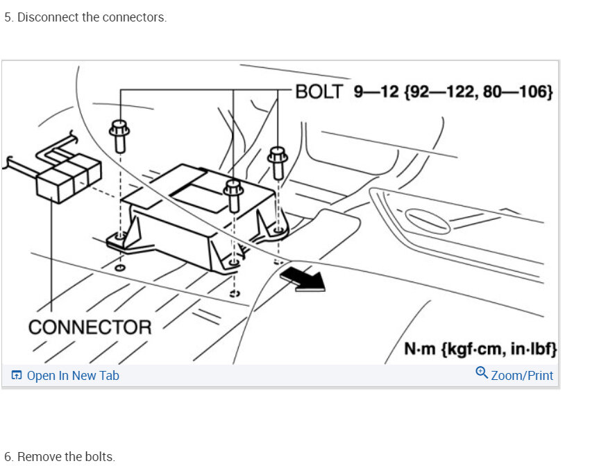

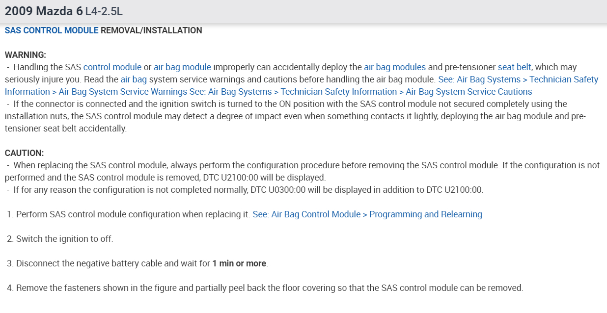

Hello, I have the vehicle listed above in near perfect shape, had it for 11 years with almost no issues. This is the 2nd Generation 6s. Had all the recalls done in 2017 or so. The air bag light came on in 2017 and was Diagnose at the Mazda Stealership and that code was B1127 for the passenger front seat side airbag. Then in Jan 2023, I took it back again and it was B1126 for driver seat side airbag.
Now during this time frame the light would come on and I was told the connection under the seat might be loose or needed to be reconnected and once I did that the light would go off. Now it might stay off for a year or more or when the weather changed. It started in 2022 doing coming on more so that is why I took it back to get scanned again in Jan 2023 and found out it was the driver's side. After the scan the light remained off until August.
Here is why I am contacting you guys. I can't get a straight answer from neither of the Mazda Places nor actually talk to the tech who did this. One shop told me it was a common connection issue and the other is saying it needs to be repaired. My car is worth 6 grand and the 2 repairs will probably be about 2 grand and that is not worth it. Yes, I have complained a lot and got a few small answers.

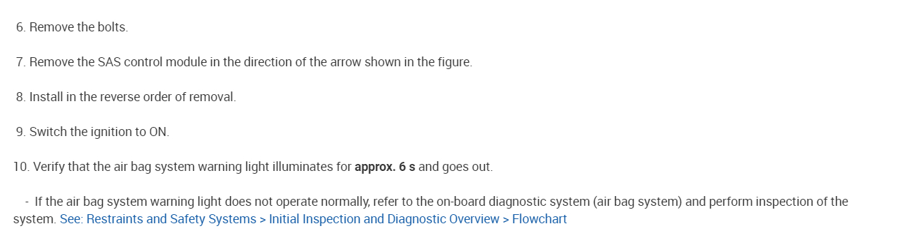

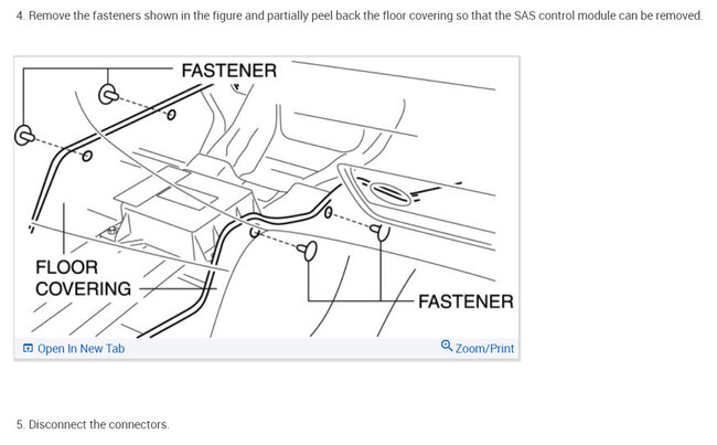

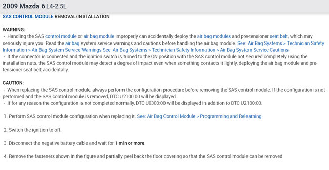

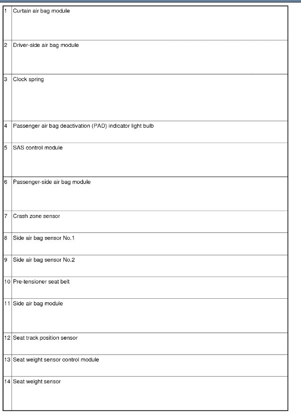

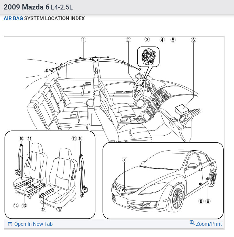

Yes, when the airbag light flashes the system is disabled. To me it sounds like the airbag module needs to be replaced but first I would check the electrical connector and look for corrosion which could cause the issue as well. Here is the location so you can check it out, and also disconnect the battery before you begin. I am not sure which link you are talking about; do you mean the one on the airbag code video? Check out the images (below). Please let us know what happens.

Yes, you need a scanner to clear the codes, because it has both drivers side and passengers side codes which is remote that both sides are bad at the same time it makes me think it is the control module that is bad but to be sure I wanted to clear and run the codes again.
