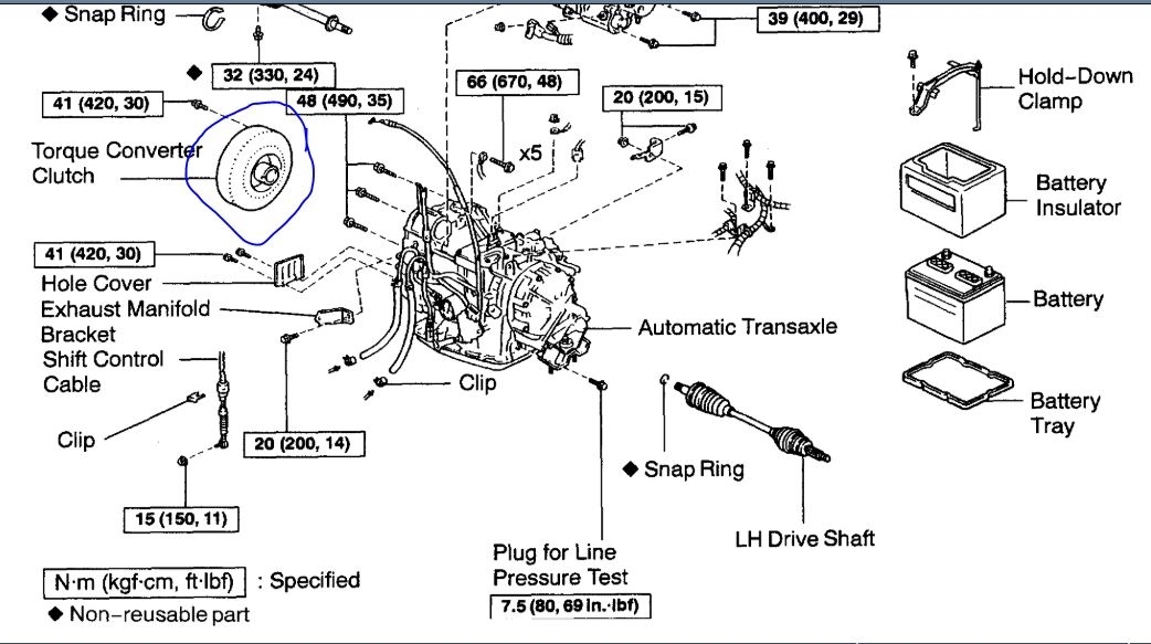

Okay, this sounds like the torque converter in the transmission is locked up causing it to stall in gear.
This is when the clutches seize inside the converter and it is locked up all the time instead of when it is commanded.
It will require removal of the transmission and replacing at least the torque converter.
https://www.2carpros.com/articles/transmission-replacement-removal-manual
