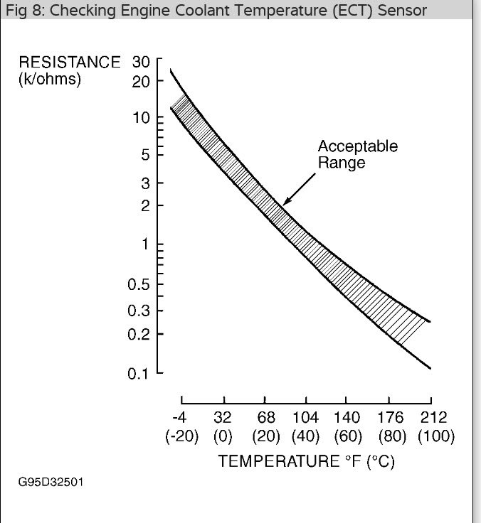

Alli can suggest then is to go to this link and see if anything comes up from it. also check resistance of coolant temp sensor see pic.
