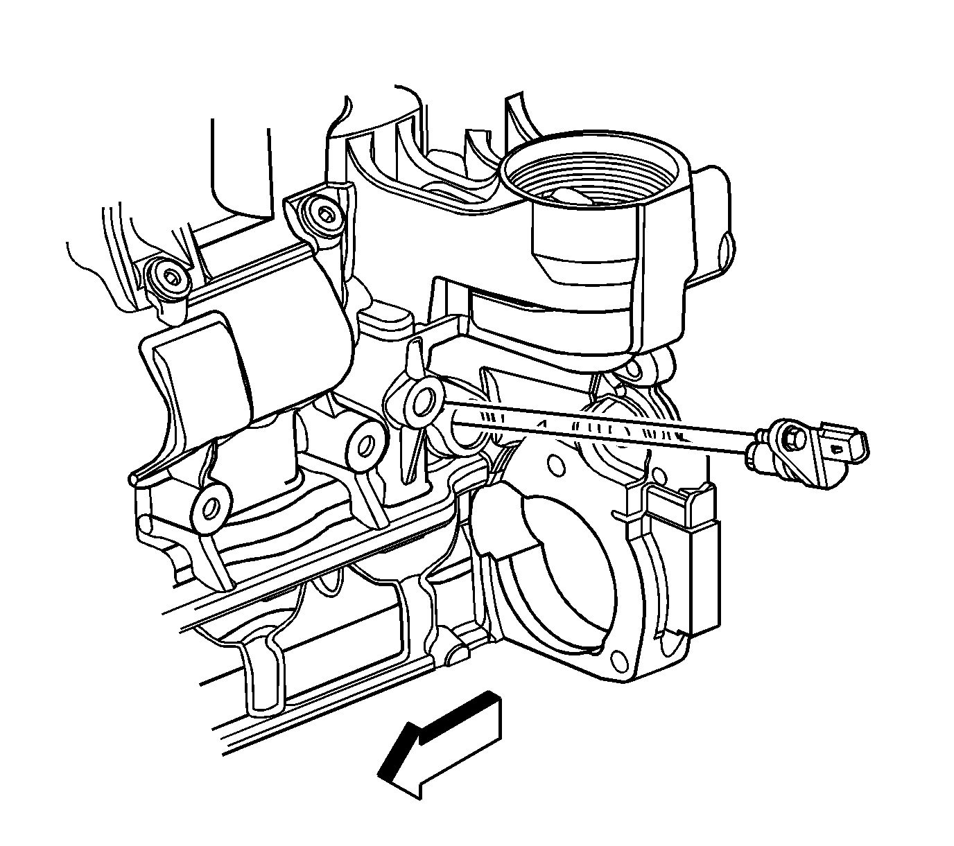

It honestly sounds like a bad crankshaft position sensor. When they go bad, often times they work when cold and when they start to heat up, expansion causes them to fail. Once they cool back off, they work again until it starts the cycle over again. Take a look through this link and let me know if it seems to mirror your symptoms.

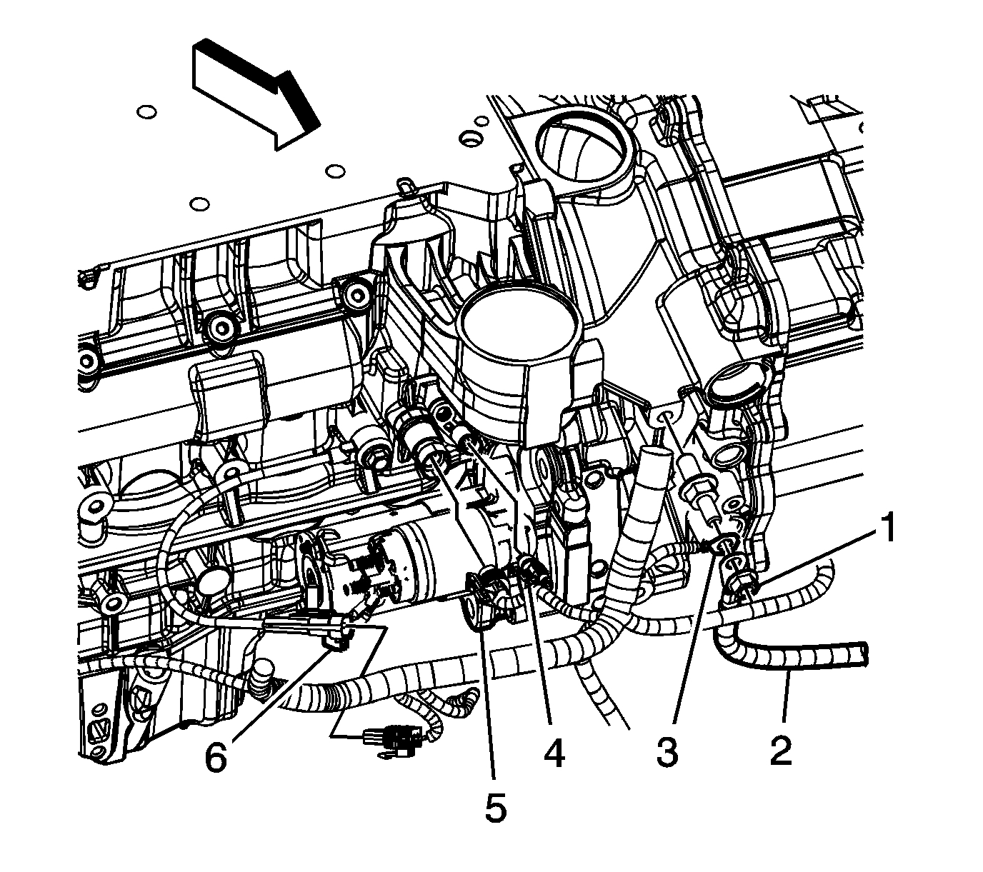

Unlike the example in the aforementioned sensor replacement, your car's sensor is behind the starter. Here are the directions specific to replacement. The attached pictures correlate with these directions. Note: Prior to removal of the starter, disconnect the battery.
_________________________________________
CRANKSHAFT POSITION SENSOR REPLACEMENT
Crankshaft Position Sensor Replacement
Removal Procedure
1. Remove the starter.
2. Disconnect the crankshaft position (CKP) sensor electrical connector (4).
3. Remove the CKP sensor bolt.
4. Remove the CKP sensor.
Installation Procedure
1. Lubricate the CKP sensor O-ring seal with clean engine oil.
2. Install the CKP sensor.
Notice: Refer to Fastener Notice.
3. Install the CKP sensor bolt.
Tighten the sensor bolt to 10 N.m (89 lb in).
4. Connect the CKP sensor electrical connector (4).
5. Install the starter.

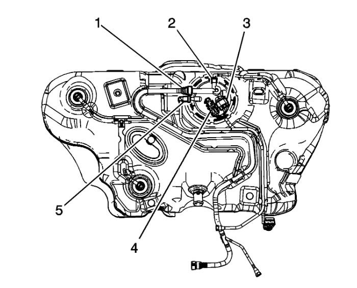

Car will start and run five minutes and just shuts off, wait a bit and will restart. i changed my crankshaft sensor and still does the same thing. i have no check engine light on. fuel pump does not come on right away but does after a few. please help. i tried to take for ride and the only window that works is the passenger front.

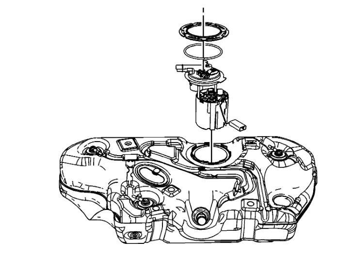

Good evening,
The first thing I would do is check the fuel pressure when it will not start. you have all the indications of a bad fuel pump.
https://www.2carpros.com/articles/how-to-replace-an-electric-fuel-pump
Procedure below
Caution: In order to reduce the risk of fire and personal injury that may result from a fuel leak, always replace the fuel sender gasket when reinstalling the fuel sender assembly.
1. Remove the fuel tank.
2. Disconnect the fuel pressure sensor and fuel pump module electrical connectors (1, 4).
3. Disconnect the fuel tank vent pipe quick connect fittings (2, 3).
4. Disconnect the fuel tank feed pipe quick connect fitting (5).

6. Remove the module lock ring.
7. Slowly raise the module until the fuel level sensor float arm is just visible. Ensure that the fuel level sensor harness connector clears the tank opening.
Important: When removing the module from the fuel tank, be aware that the module reservoir bowl is full of fuel. The module must be tipped slightly during removal to avoid bending the fuel level sensor float arm.
8. Tilt the module toward the rear of the fuel tank to allow the level sensor float arm to clear the tank opening. Remove the module from the tank.
9. Carefully discard the fuel in the module reservoir bowl into an approved fuel container.
Important: DO NOT reuse the old fuel pump module seal.
10. Remove and discard the fuel pump module seal.
