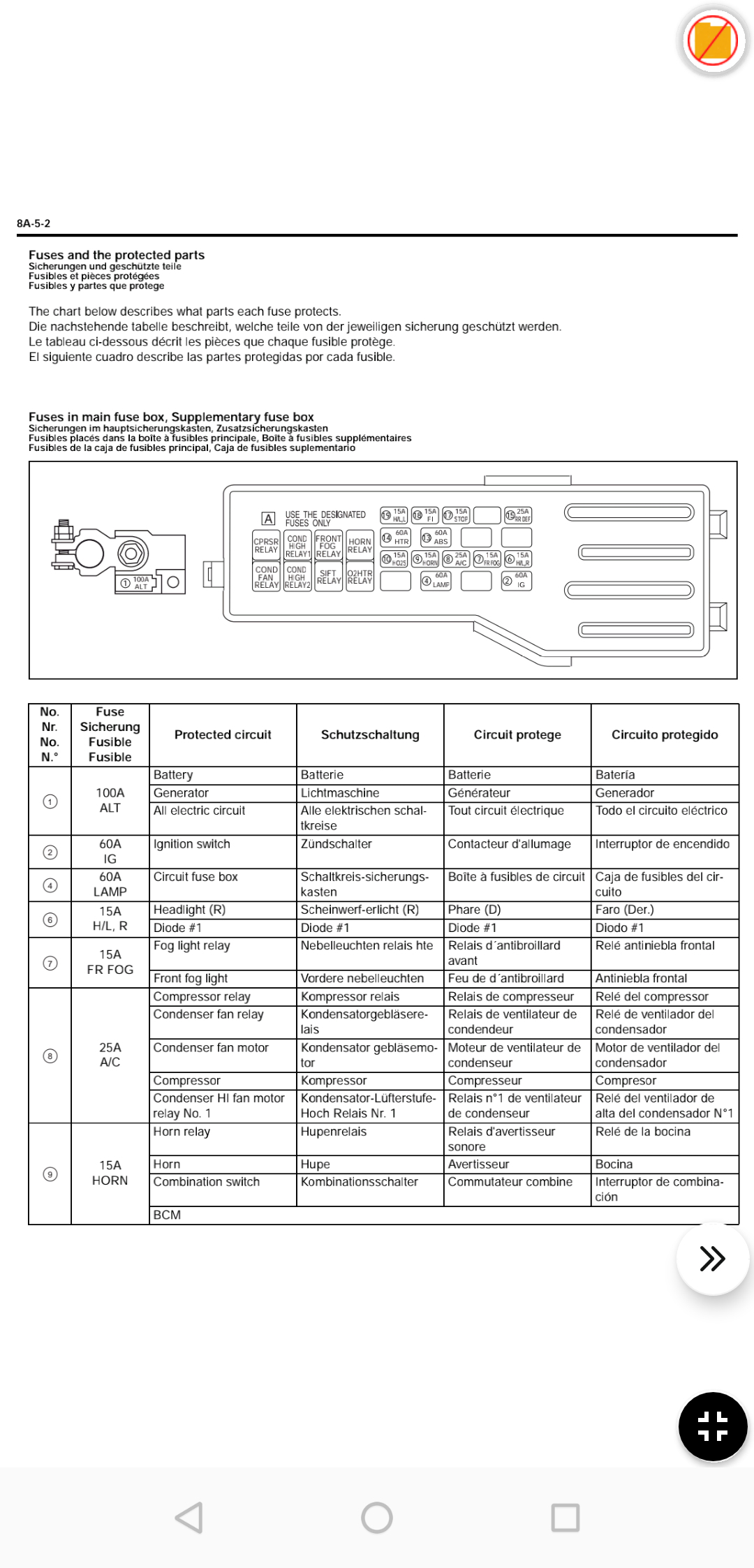

Fuse keeps blowing
2005 SUZUKI XL7
120,000 MILES
ADEL SAEED
When I install a new fuse in and it pops.
Jun 14, 2021 at 4:24 AM
AL514
  • 5,656 POSTS
Hello, sorry to hear about this issue. This can be a frustrating one. Which fuse is it that keeps popping? Fuses blow when there is a shorted power supply to ground. It can be in the wiring harness or a component that has a short internally. Usually for this problem a technician will put a circuit breaker that is the same rated as the fuse. This way you don't have to be going through a hundred fuses trying to find the problem.
