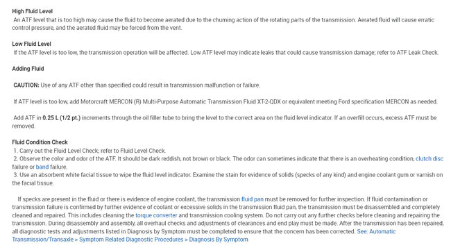

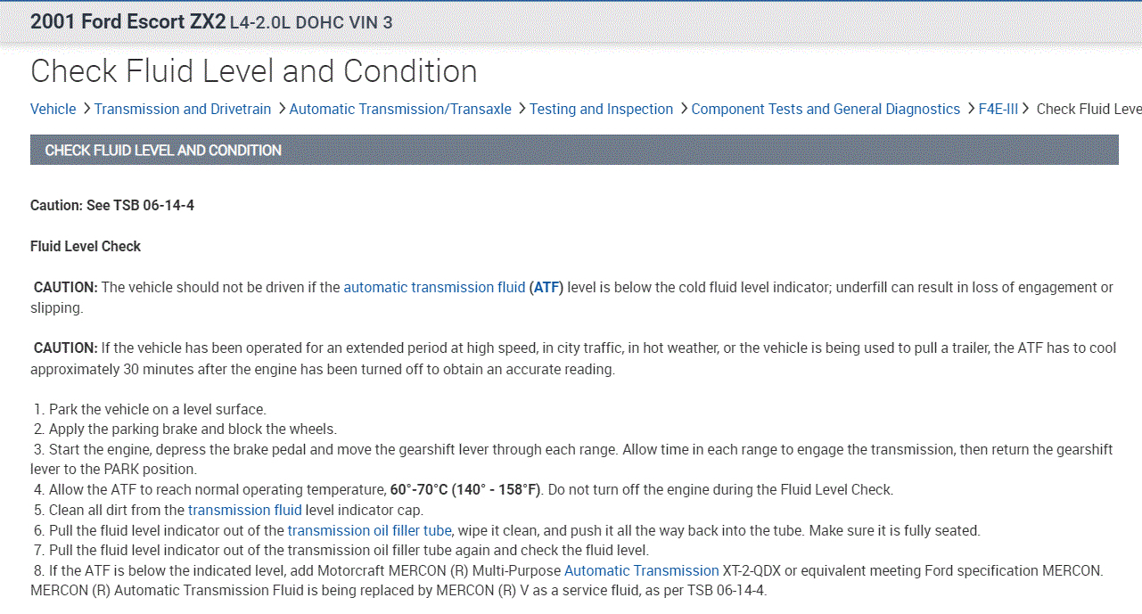

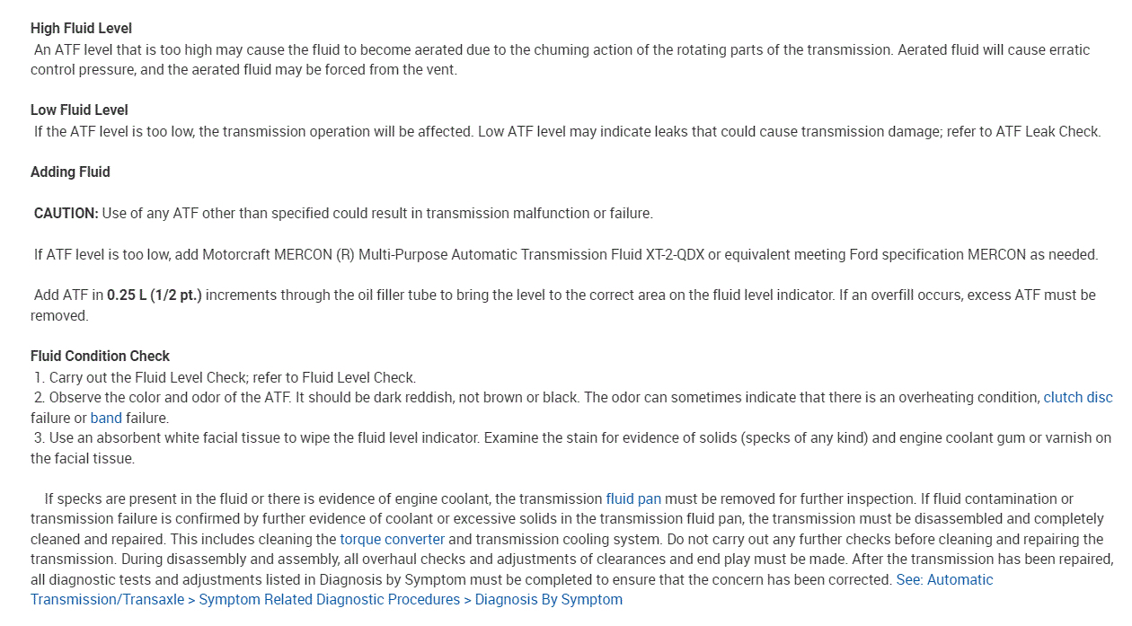

First, have you checked the condition and level of the transmission fluid? Also, have you checked to see if there are any codes stored in the computer?
If you haven't. start with the fluid condition/level. Here is a link that explains in general how to do it:
https://www.2carpros.com/articles/how-to-check-and-add-transmission-fluid
I attached the directions specific to your vehicle below. Take a look through them and let me know what you find.
