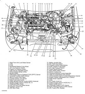

2002 Ford Escort 4 cyl Front Wheel Drive Automatic
would like a diagram of where all three temp sensors are located
Mar 14, 2010 at 7:26 AM
DAVE H
  • 13,384 POSTS
Engine Coolant Temperature (ECT) Sensor..On left rear of engine. See Fig. 2 Instrumentation Engine Coolant Temperature Sender..On left rear of engine. See Fig. 2 . Intake Air Temperature (IAT) Sensor...In top left front of engine compartment, on front of air cleaner. See Fig. 2
