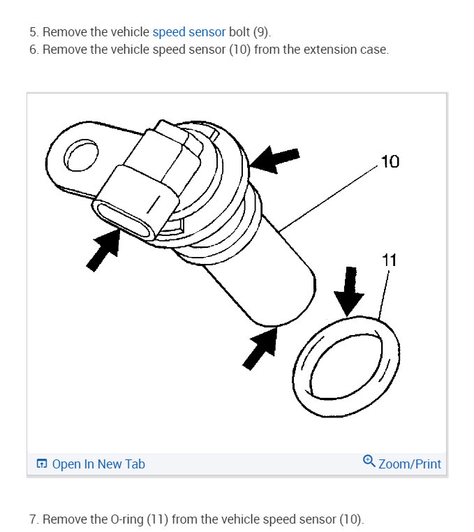

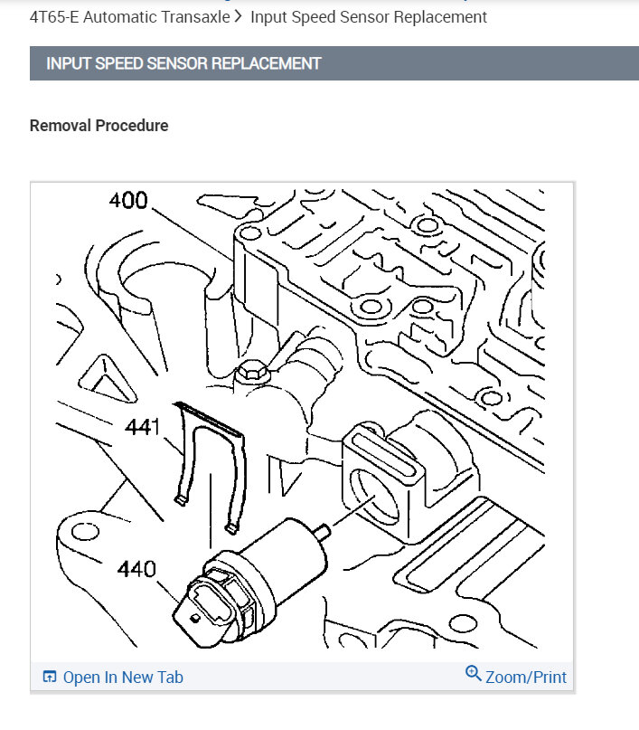

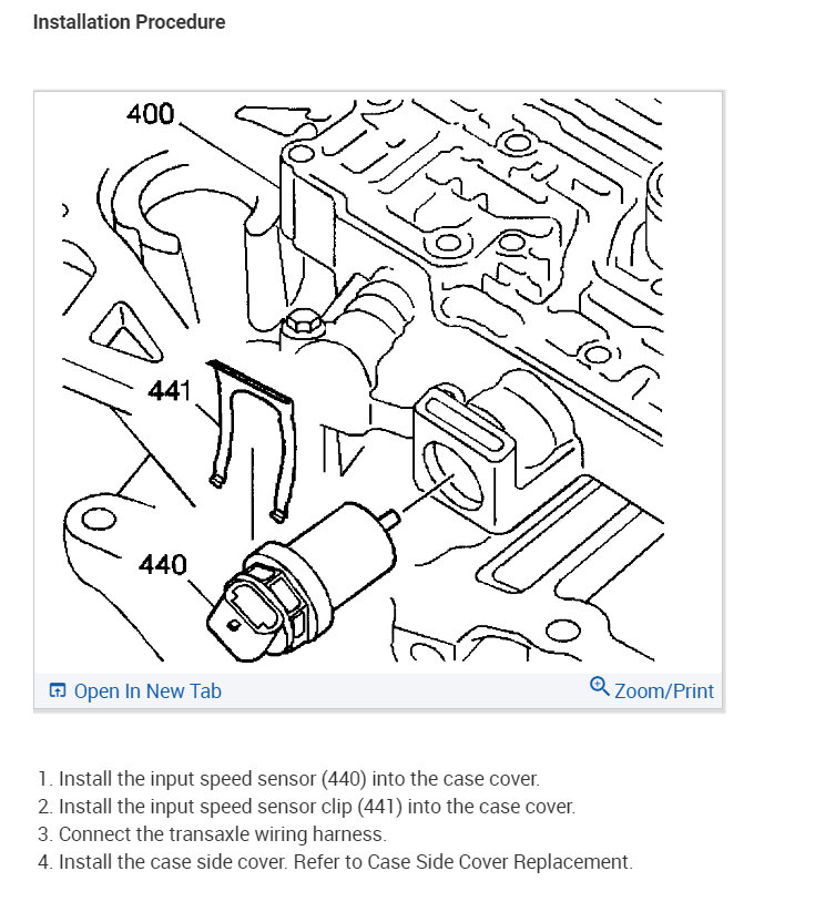

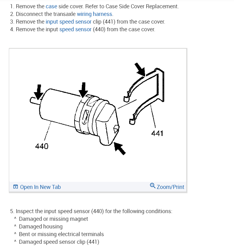

Is the speedometer working? I would try to change out the input shaft sensor because if it is off a little the transmission won't shift, and it won't have a code.
This guide may help as well:

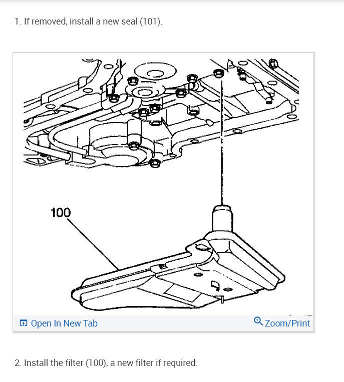

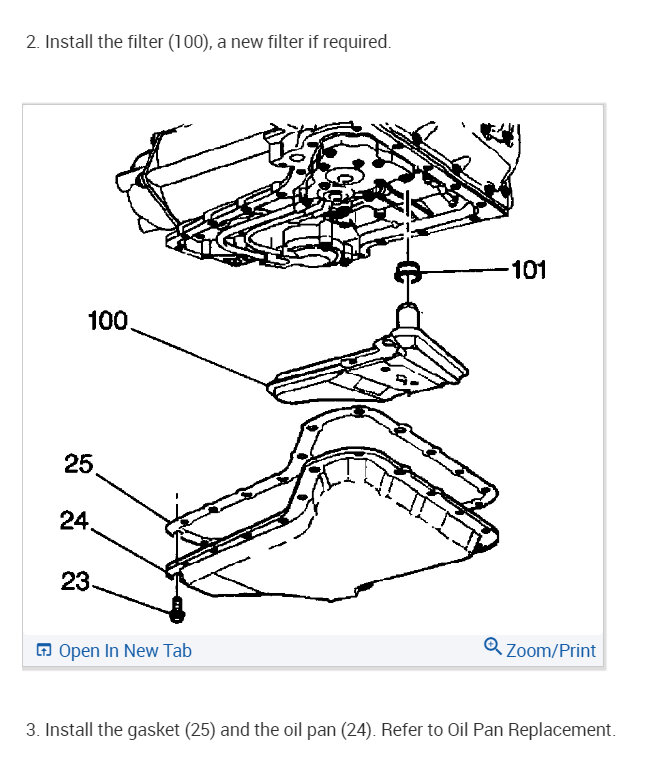

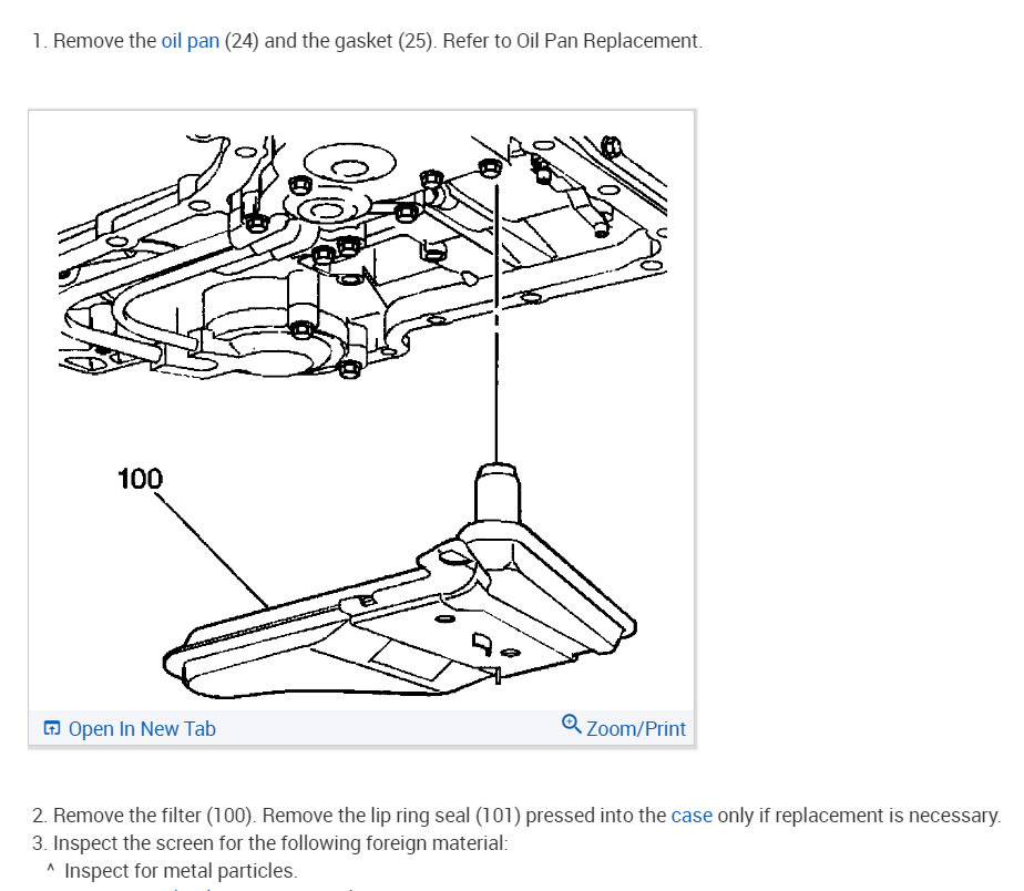

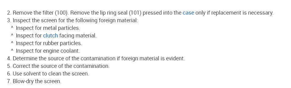

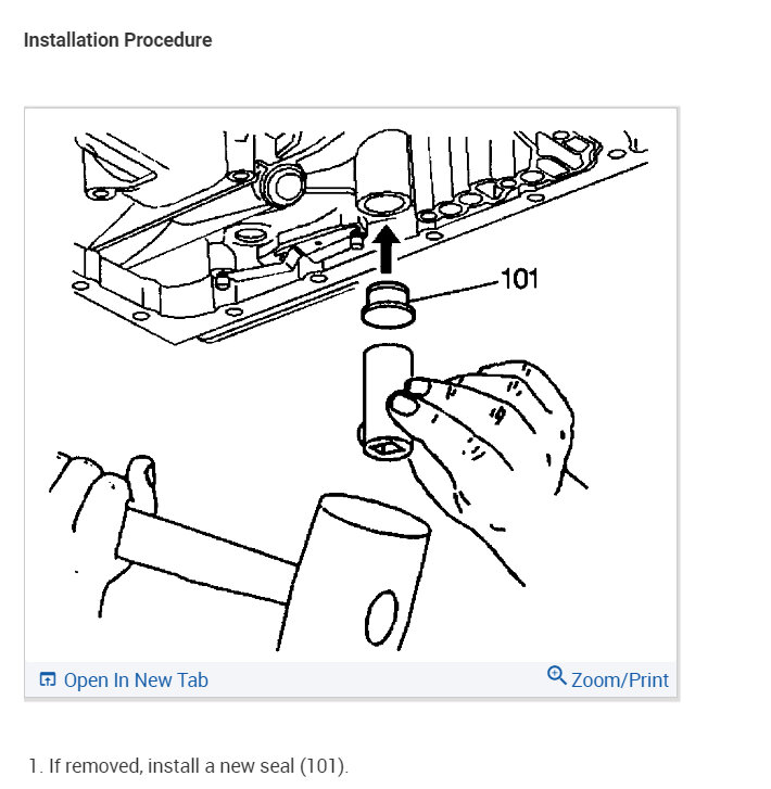

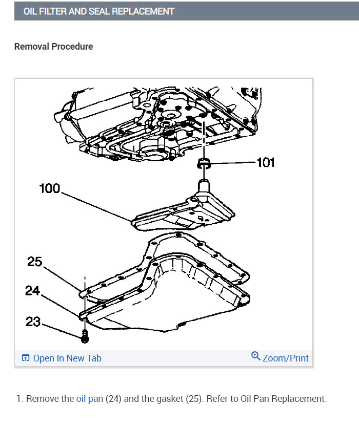

I have also seen the filter fall out of the case which lowers fluid pressure which can be a problem as well. Check out the images (below). Please let us know what you find. We are interested to see what it is.

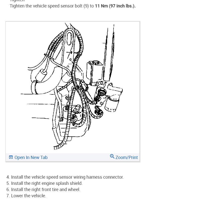

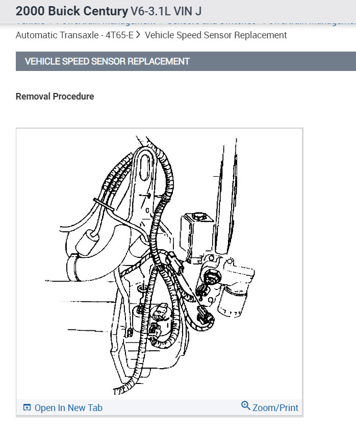

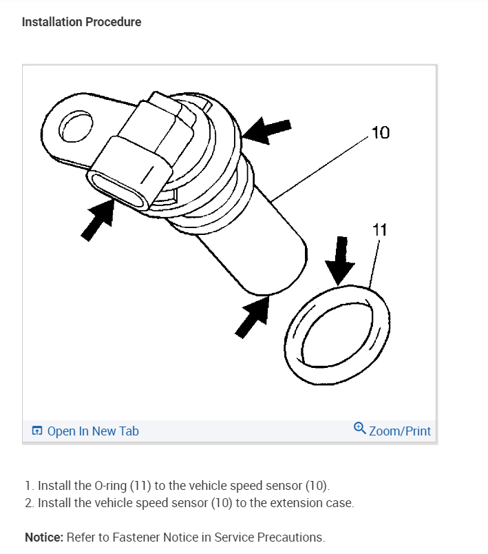

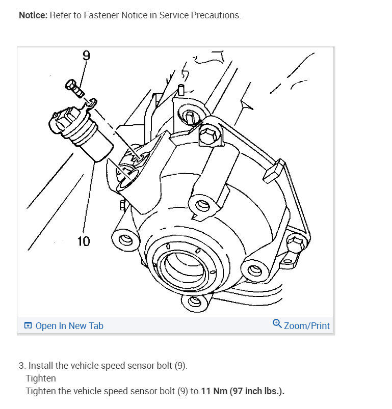

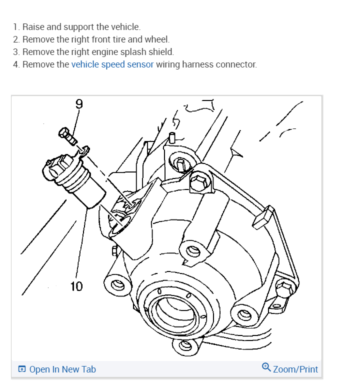

Hello!! Thank you for asking me that. The answer is no, the speedometer is not working. hasn't since i became unstuck.
Feb 3, 2023 at 6:14 AM

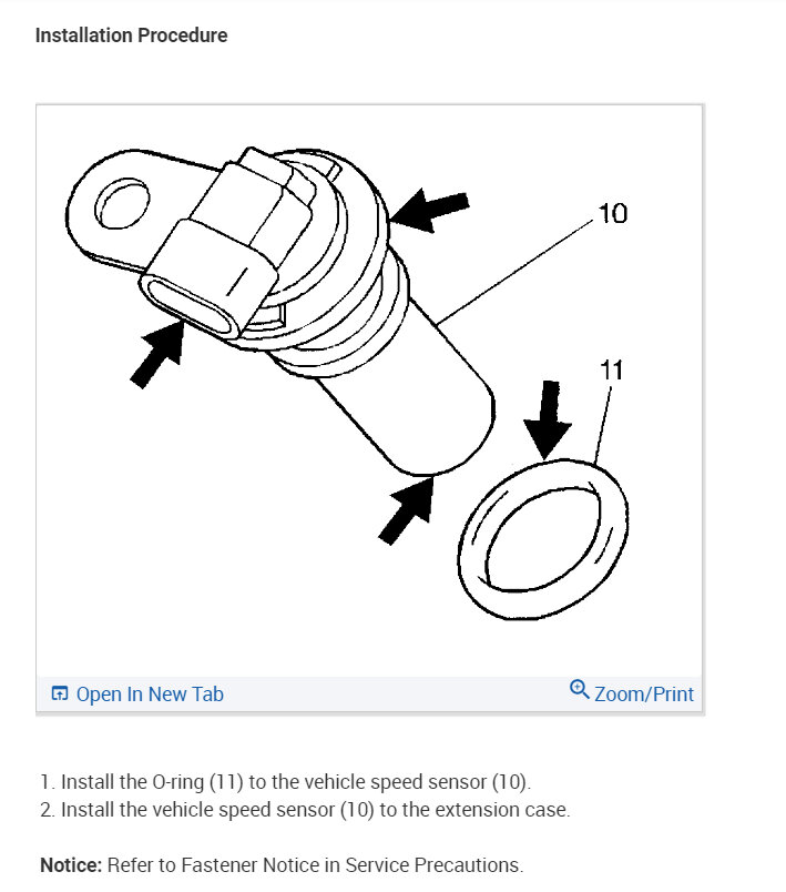

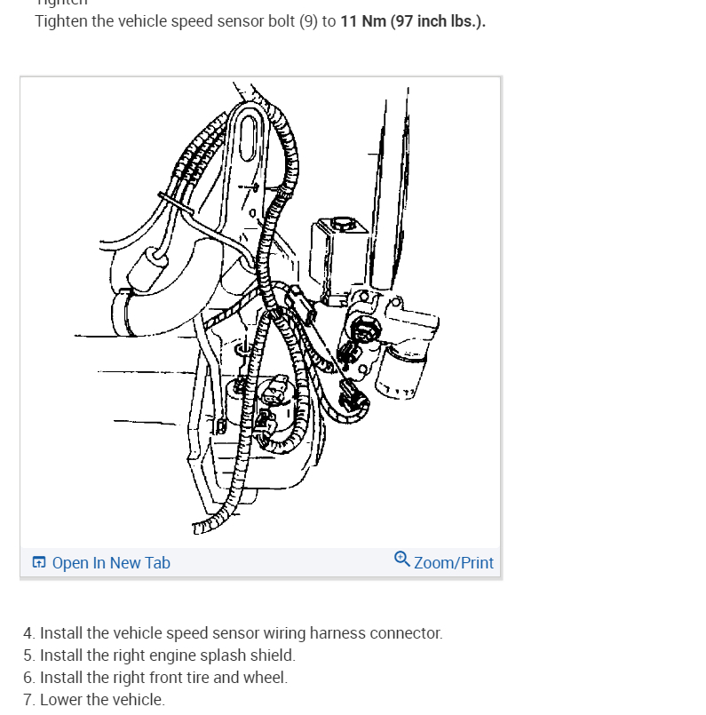

  • 55,051 POSTS
Yep, that will cause a shifting problem, please check the wiring to the sensor first, here is the location of the vehicle speed sensor so you can check it out. Please let me know.
