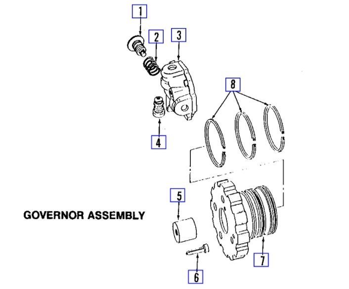

No to the input speed sensor. I think you have dirt in the governor that is causing this issue.
The governor may be serviced by removing the trans-axle oil pan and valve body assembly. The governor may be unbolted from the governor support and removed from the trans-axle for reconditioning or replacement.
When cleaning or assembling the governor, make sure the governor valves move freely in the bores of the governor body.

Do you have a picture of what the governor looks like so that I know what to look for? I think I am getting in over my head both for physical as well as capability reasons. You have been great!
Wednesday, April 25th, 2018 AT 11:24 AM
  • 52,797 POSTS
Picture as requested.

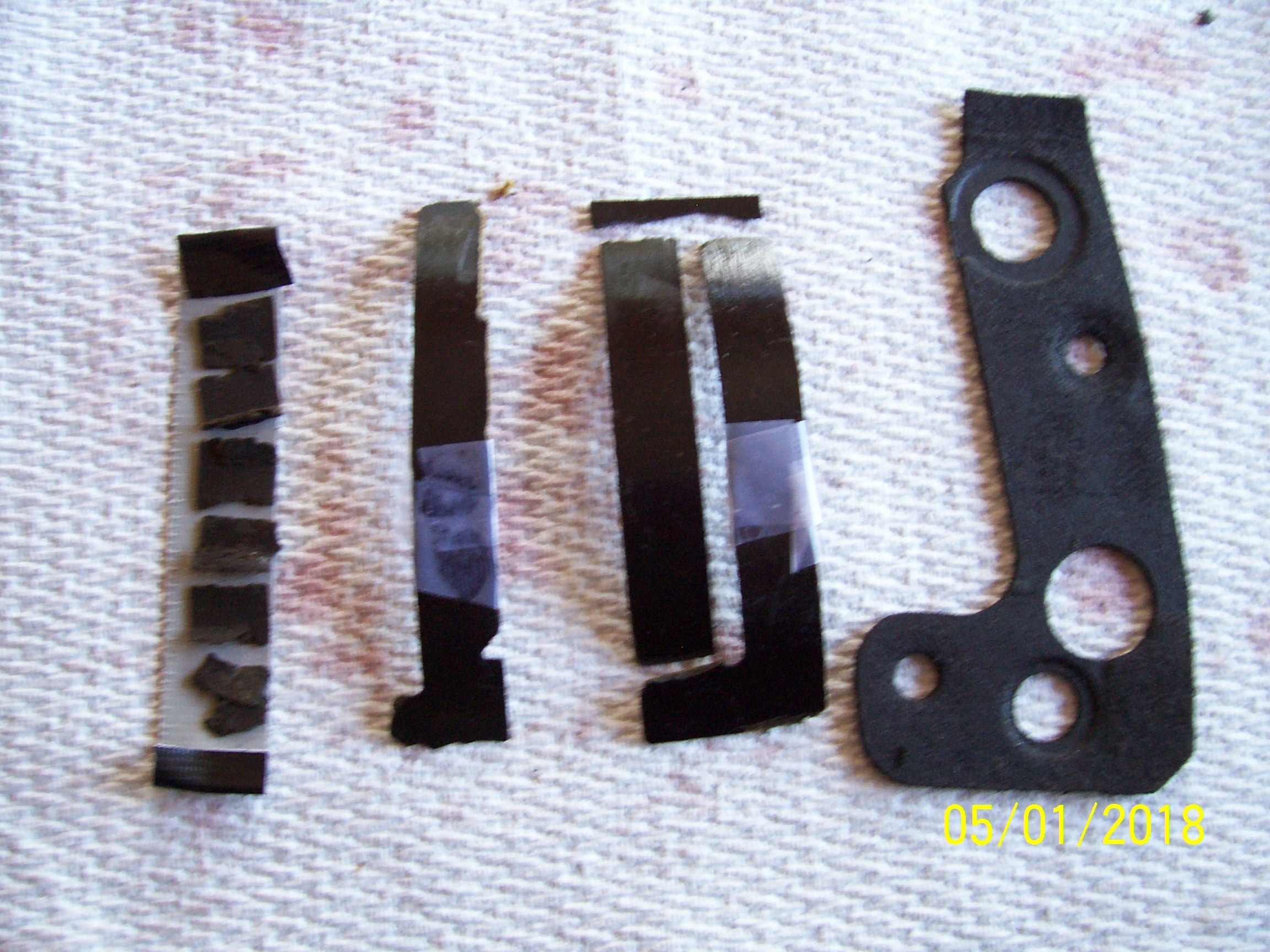

Okay, we removed the pan and were astounded to find large pieces of what appears to be gasket material in the pan, up inside the filter, and above the filter. The filter was probably obstructed and so we are wondering. Might Iit function correctly now, after removing those pieces; however. Where did they come from. We are attaching a picture of those pieces and have tried to arrange them in the configuration it might have been in. We realize the one shaped like an "L" is part of the filter system. We think one piece is still missing. And perhaps two to three inches long. Might we have found the problem? If not, the diagram you sent showing the governor body helps us. Not at all. Where do we look for the Governor Body now that the pan is off?

Okay, that is all clutch material. It looks like you have clutch failure in one of the clutch packs. I would stop right there. The transmission will have to be removed and inspected.
