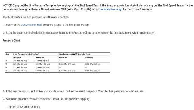

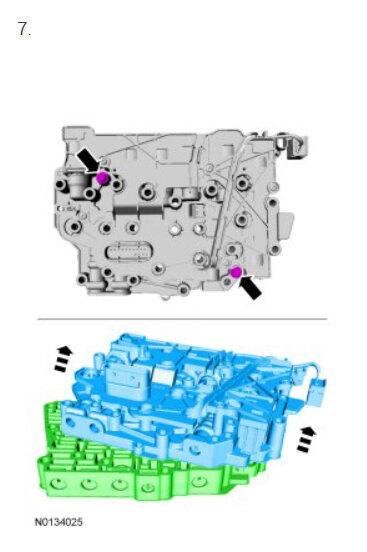

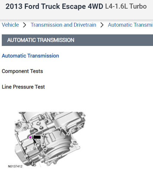

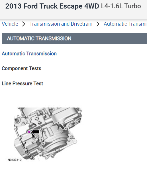

I have seen the front fluid pressure pump fail which can cause multiple shift solenoid failures. I would check the fluid pressure of the transmission before replacing any more shift solenoids. Check out the images (below). Please let us know what happens.

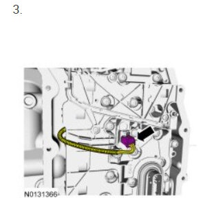

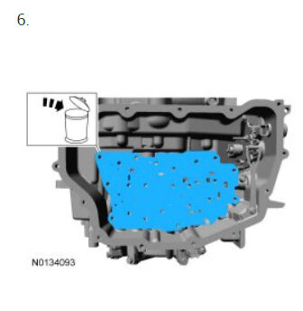

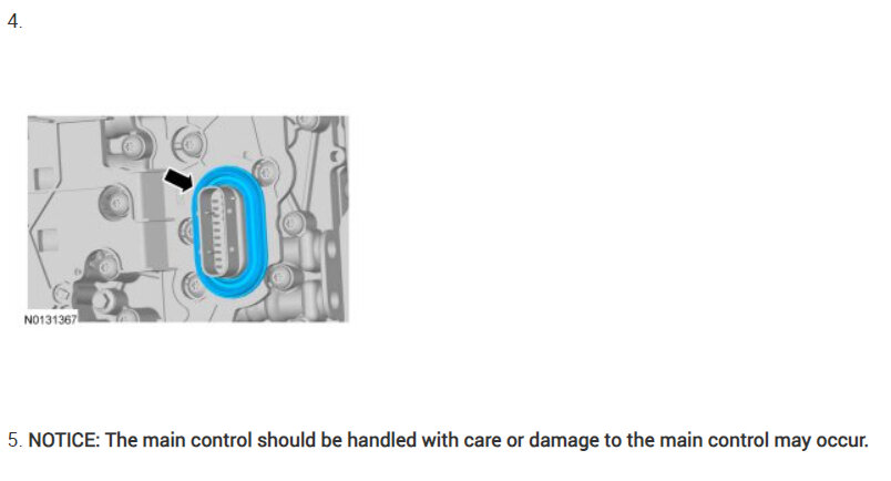

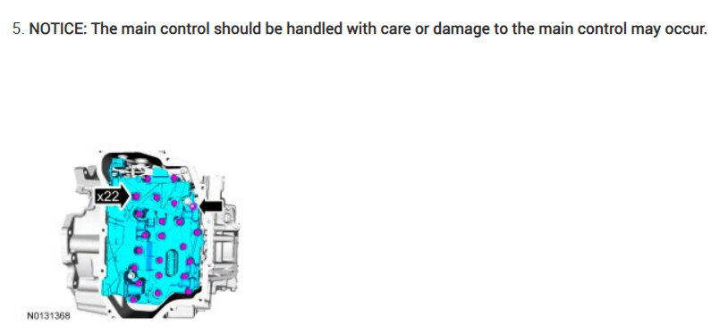

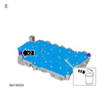

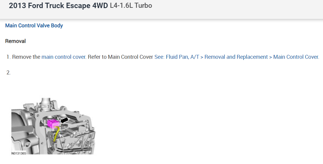

It should be okay with that low of mileage but you never know, you can try a valve body which is the only service you can do without removing the transmission for a rebuild. Here is how to swap out the valve body.
Tighten in a crisscross pattern.
- Tighten to 10 Nm (89 lb-in).
Check out the images (below). Let us know how it goes.
Oct 2, 2024 at 2:31 AM

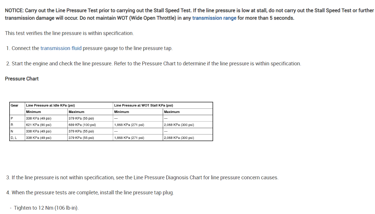

Hello again. Pressure tested the unit and here are the results.
Idle in P steady at 118 psi
Idle in D spikes over 175 shaky needle for a second or two then steady at 107 when gear
engagement is felt.
Idle in R steady at 135
In D normal accel up to 215
In D harder accel in low gear up to 285
Using a Gear Wrench brand gauge, not a cheap one. Gauge goes up to 300 psi.

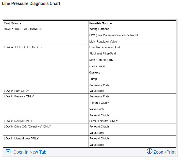

So it would appear I have a problem with excess pressure, not too little, may have nothing to do with valve body or solenoids? What do you suggest now? Thanks.
Oct 24, 2024 at 5:03 AM
  • 55,433 POSTS
Yep, this would be a problem with the pressure regulating solenoid in the valve body or the pressure relief valve is stuck. Good job getting the pressures.

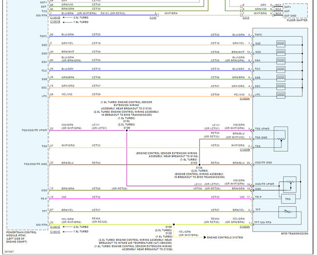

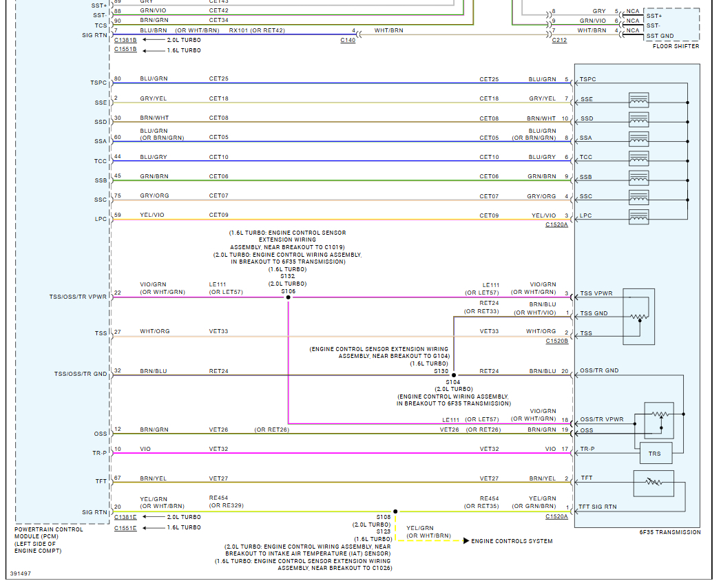

Okay, thanks, so I still have to remove the valve body. Better than removing the whole transmission. Would you suggest replacing both the pressure regulating solenoid and the pressure relief valve? Do you have a schematic showing me where these are and how to check for function? Or should it be obvious when I look at it on the work bench? Don't expect to have a problem removing the valve body.
Oct 25, 2024 at 7:59 AM
  • 55,433 POSTS

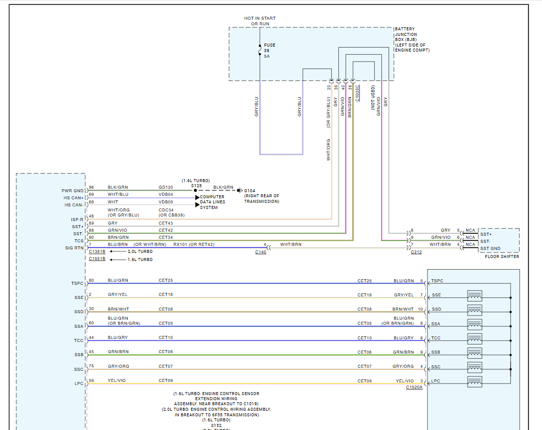

Yes, I would replace both. They don't say which solenoid is which, but I do have the transmission wiring diagrams so you can match the wiring to the solenoid. Check out the images (below). Let us know what you find.
