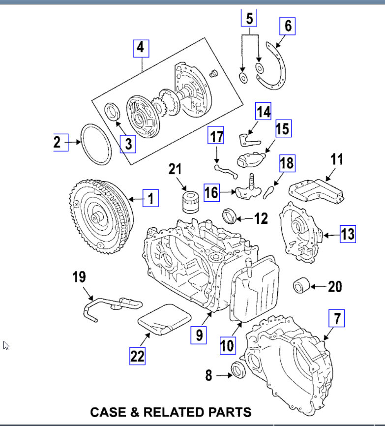

What is the location of the valve body to change shift solenoids?
Oct 24, 2020 at 2:17 PM

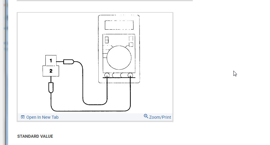

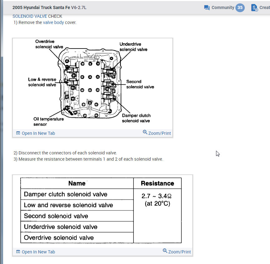

I attached the info on where they are located and how to test them just to be sure they are failed. Let us know if you have questions. FYI - The valve body cover is number 10 in the first attachment.
