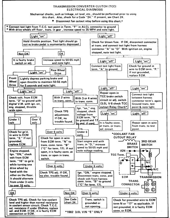

Where is the transmission shift solenoid located and can it be replaced without opening the transmission?
Dec 18, 2017 at 6:46 AM
  • 110,246 POSTS
Shift solenoids weren't used in these years. The only one you may be thinking of is the torque converter clutch solenoid. I attached a checks for you to review. Let me know if it helps. Also, please list what the symptoms are you are having so I know better how to help.
