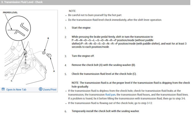

What’s happening to my car if suddenly, while driving, the gears don’t engage. The engine runs, but when i try to change gear mode it doesn’t shift.
Nov 30, 2024 at 11:05 AM
  • 55,381 POSTS

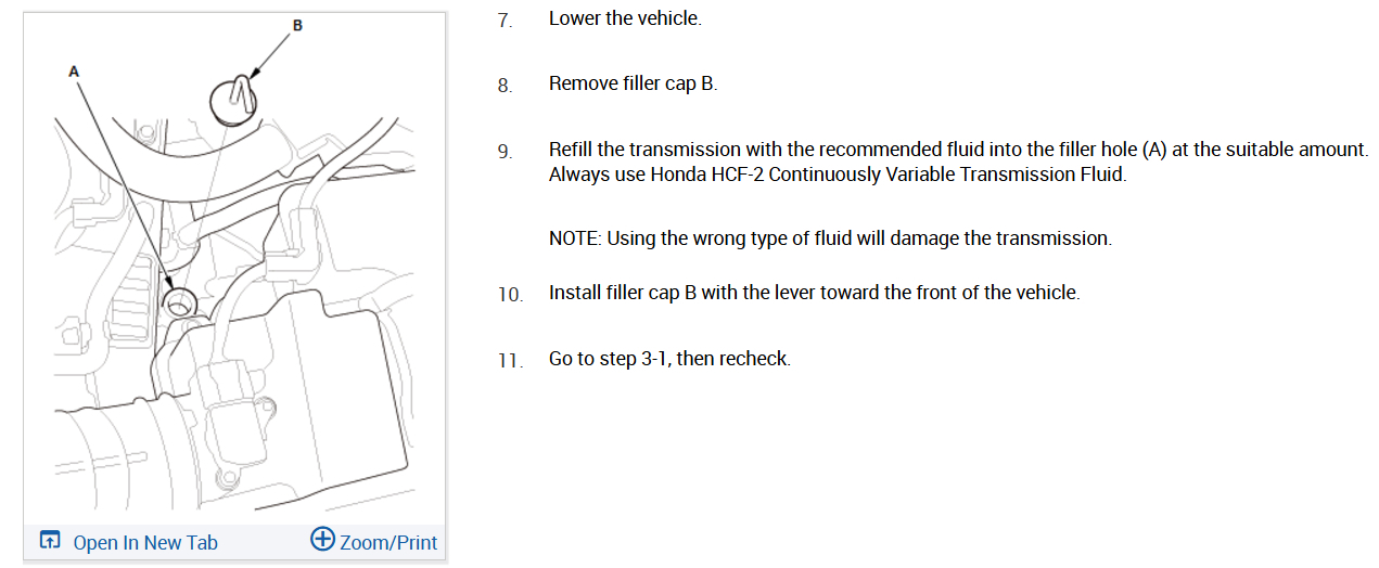

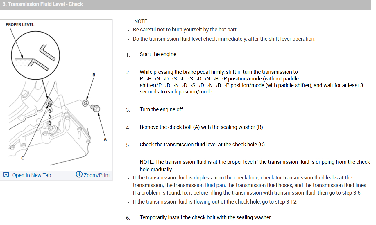

So does the car move and not shift or does the car not move? Anytime you have a transmission problem it is best to check the fluid level and condition. Here is a guide to help with the instructions for your car in the images below.
https://www.2carpros.com/articles/how-to-check-and-add-transmission-fluid

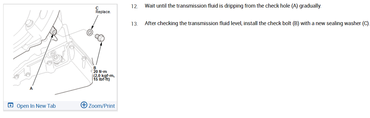

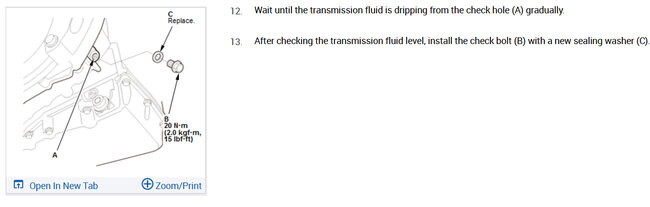

This car has the CVT transmission which has a history of failure. Let me know if the fluid is dark and burnt smelling. Checking this fluid is much like the old standard transmission with a drain plug in the side of the case which is what the level should be. You might want to try a fluid change as well.
Use Honda HCF-2.
NOTE: Using the wrong type of fluid will damage the transmission.
