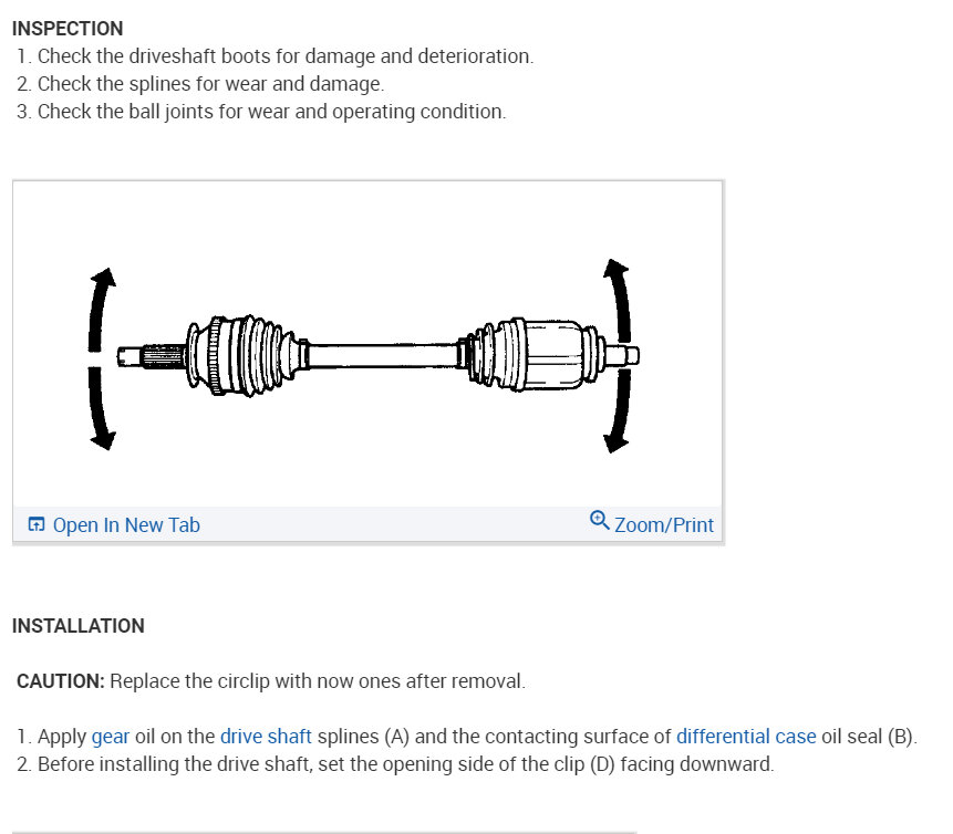

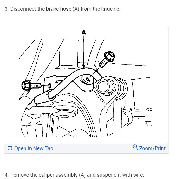

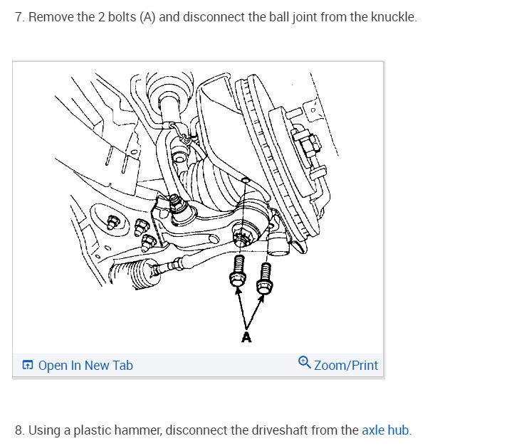

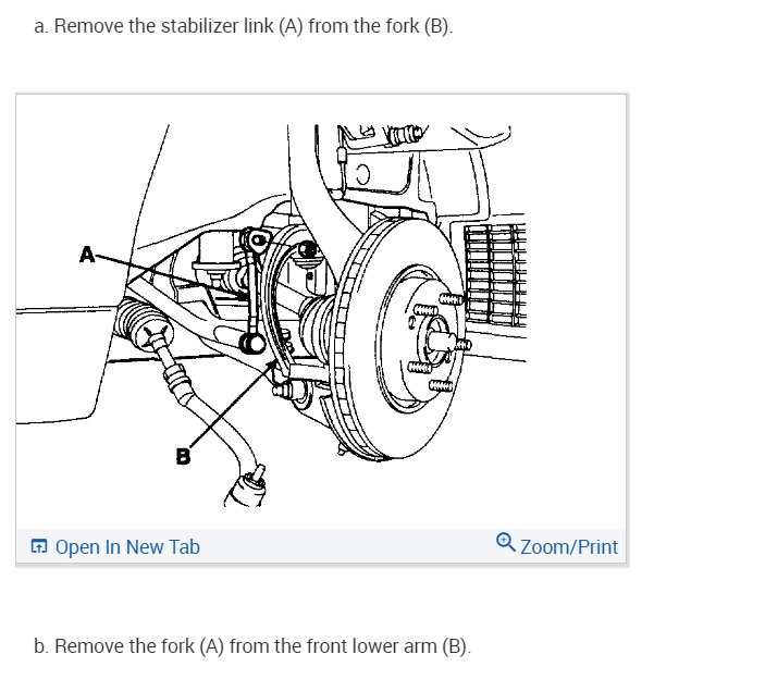

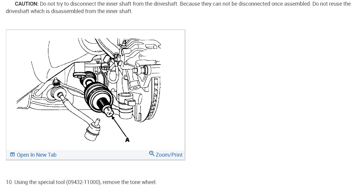

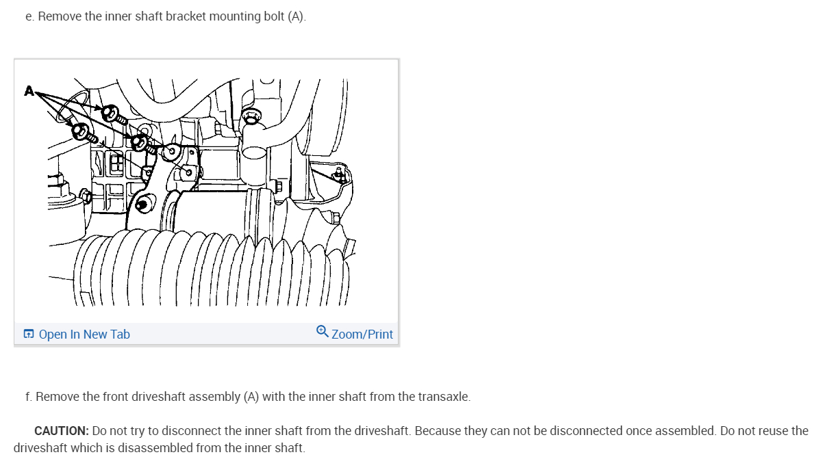

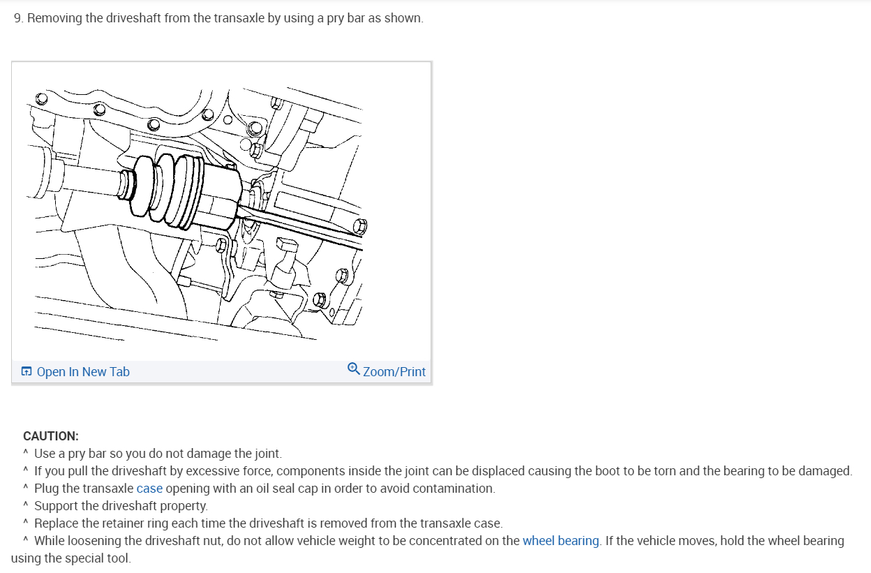

So, my car usually clunks over bumps and what not. No matter the speed, and it’s not only when turning. It’s a pretty bad clunk. But I was driving home at about 35 MPH, and it sounded almost like something may have broken, and the car got super shaky, and I had to stay under 30 MPH to get home. I just went and looked under the car and saw nothing hanging down or out of place. The alignment is bad, and I noticed my driver side tire is worn on just the sides almost bald. Middle of tire is fine.
Jul 26, 2023 at 6:14 AM
  • 55,224 POSTS

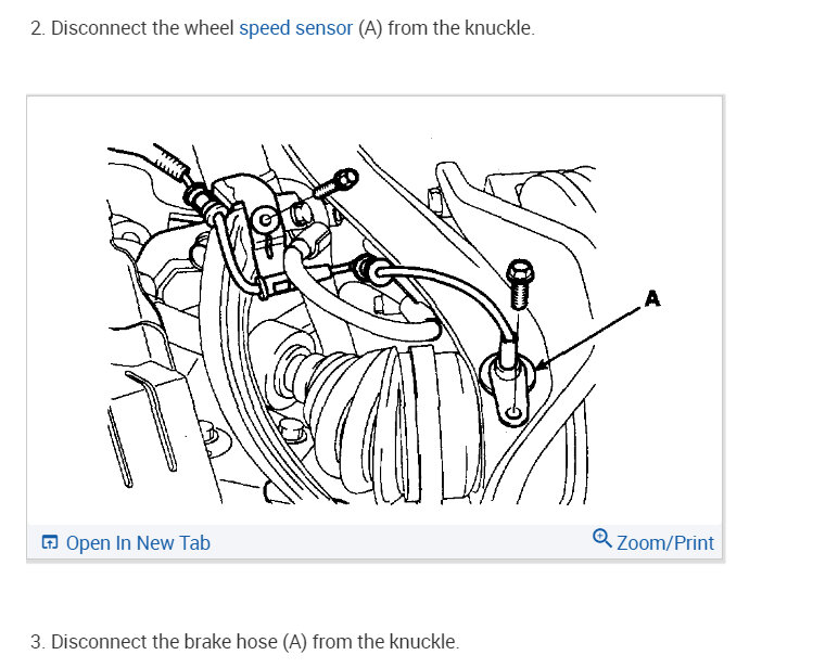

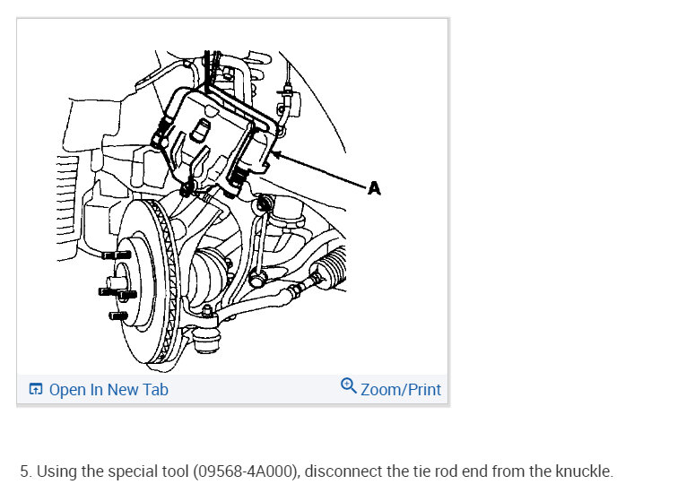

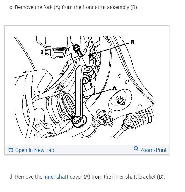

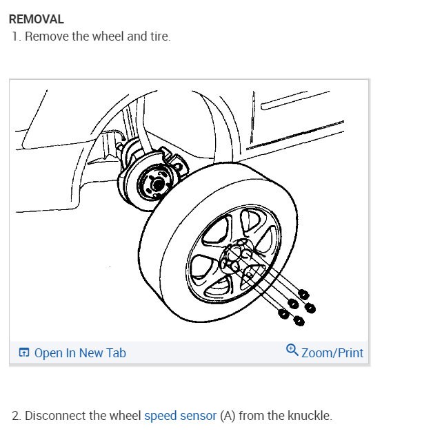

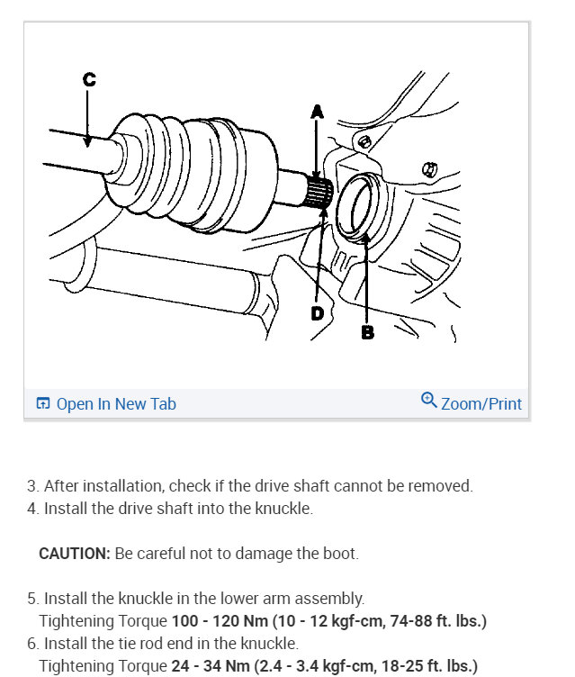

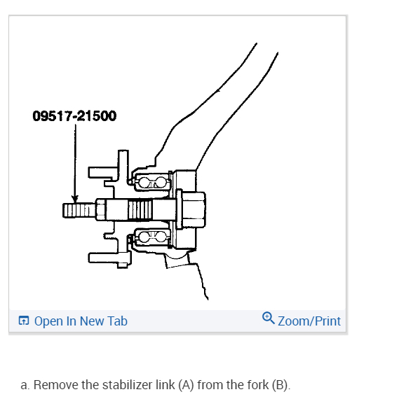

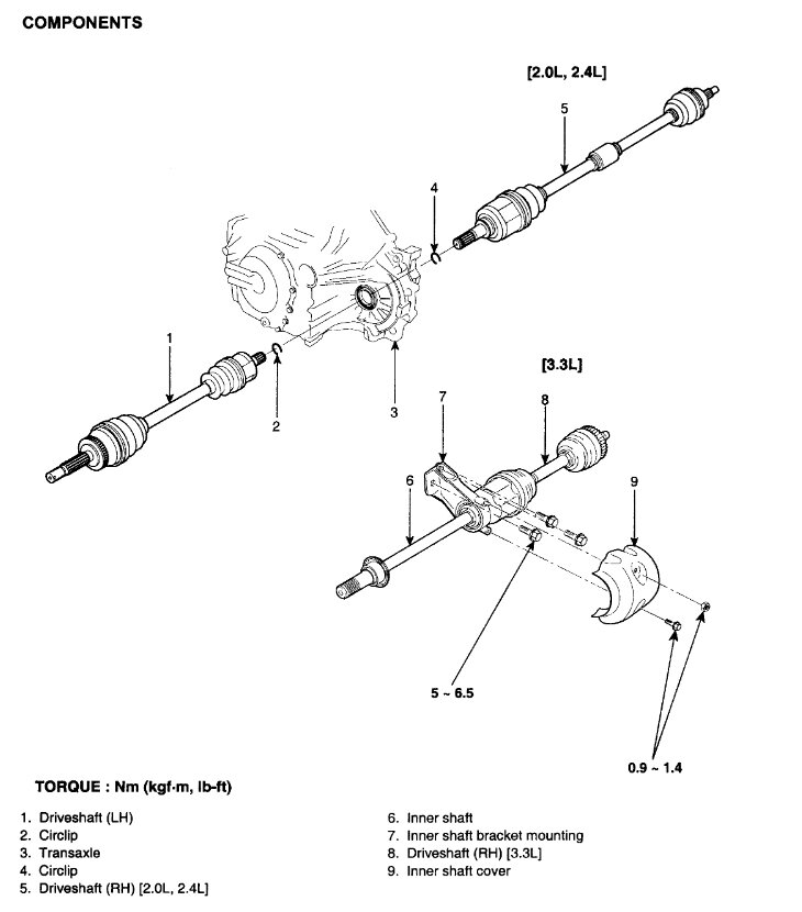

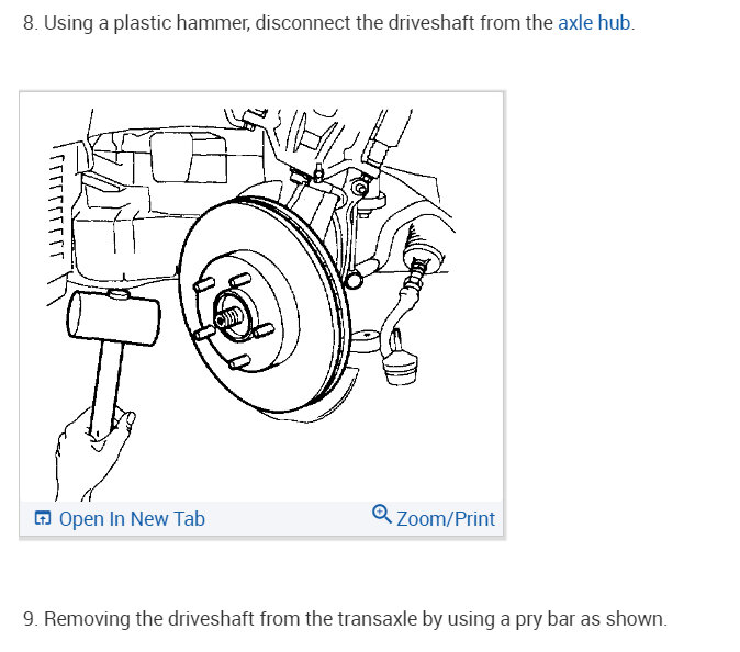

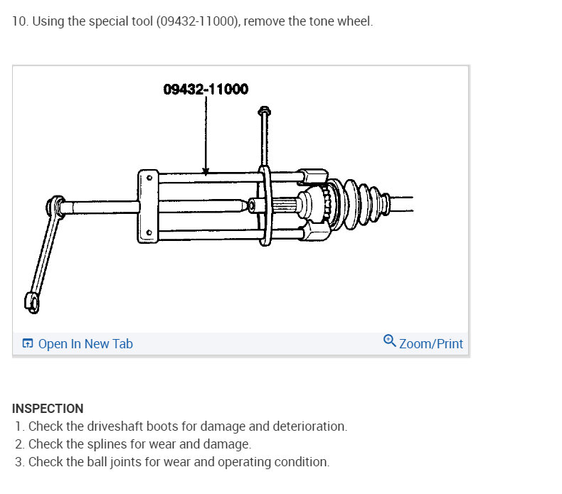

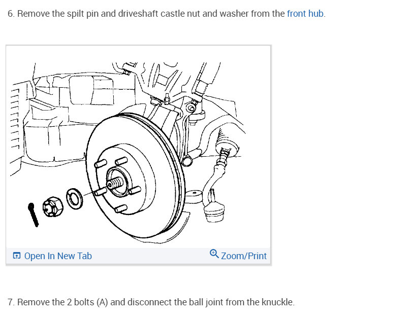

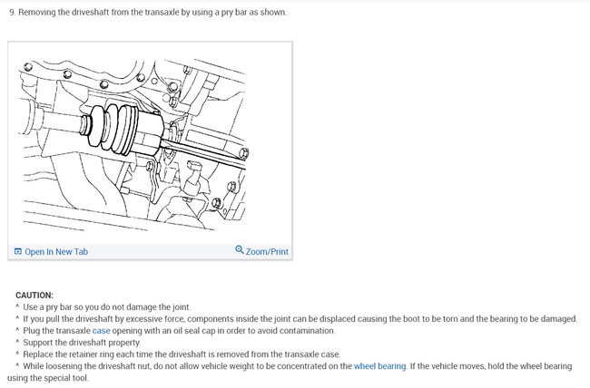

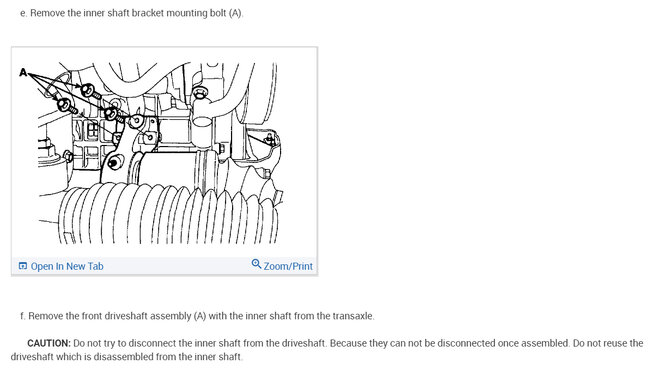

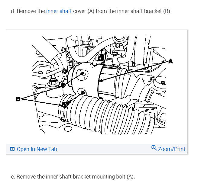

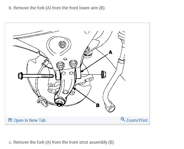

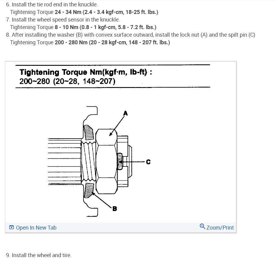

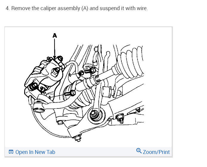

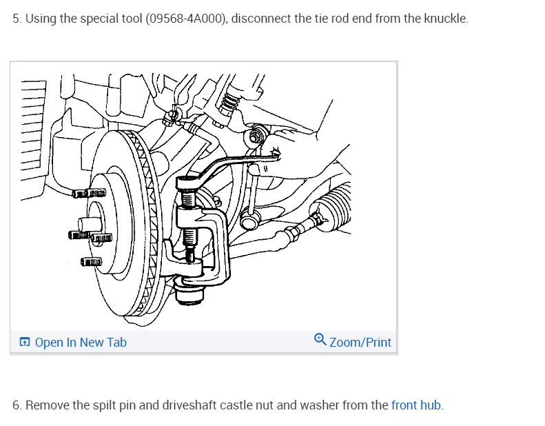

If the engine is running okay it sounds like the CV axles need to be replaced. here is a generic guide to help you step by step with instructions in the diagrams below to show you how on your car:
https://www.2carpros.com/articles/replace-cv-axle
