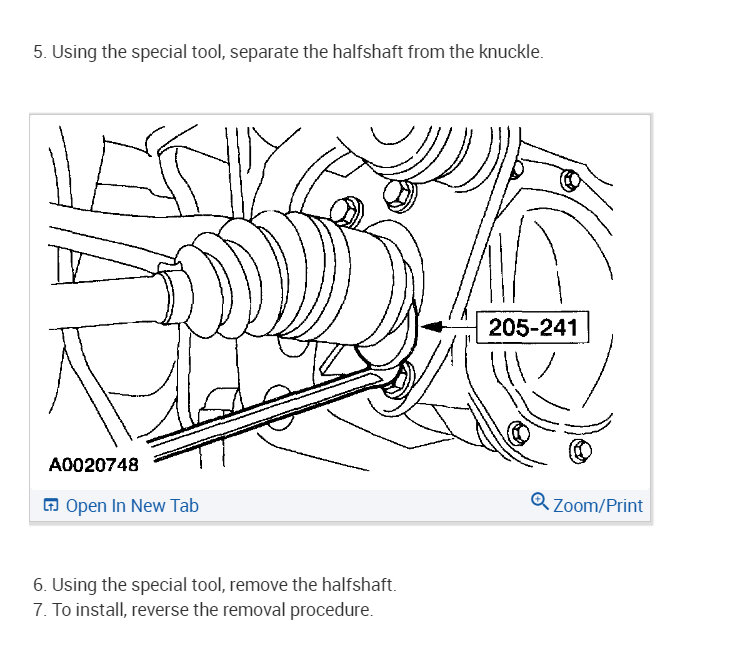

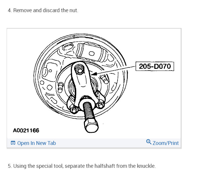

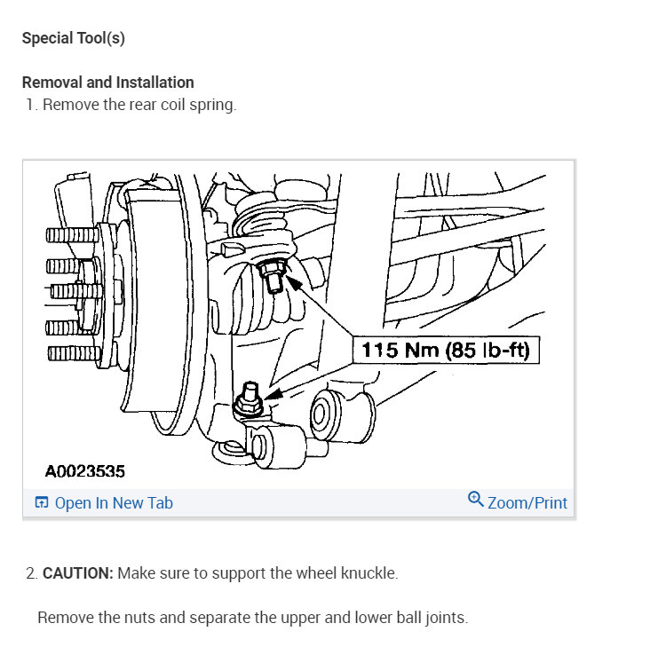

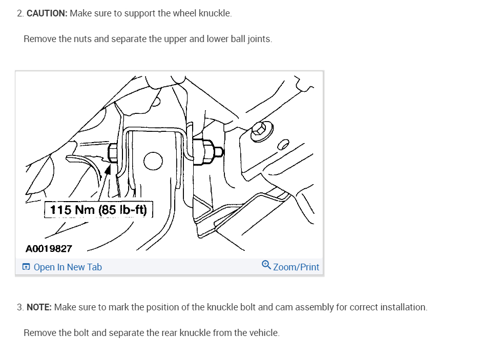

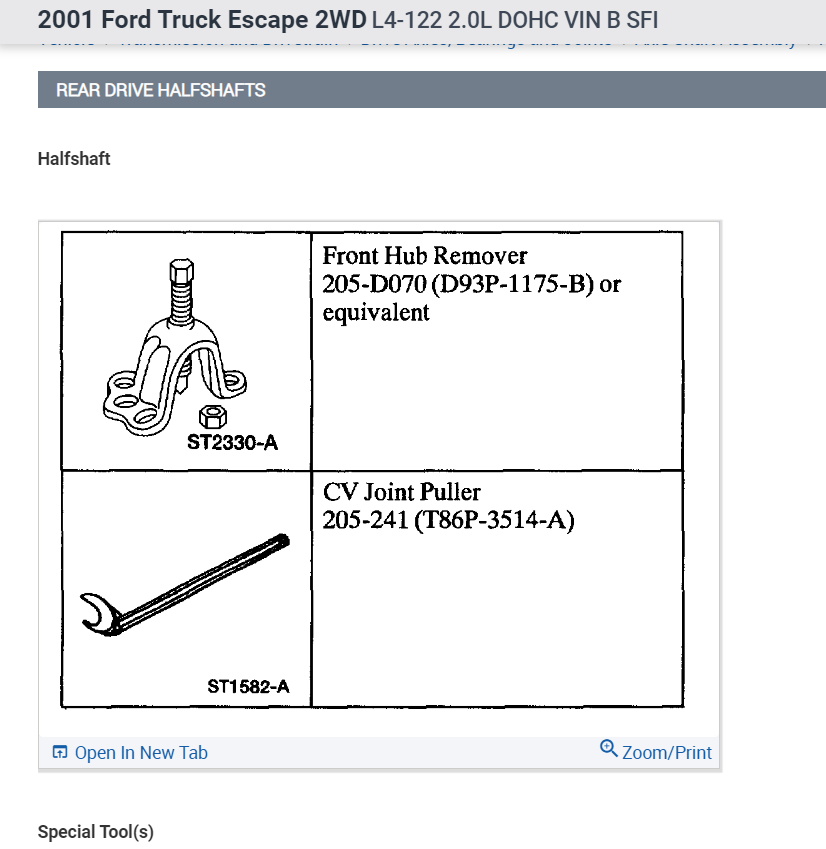

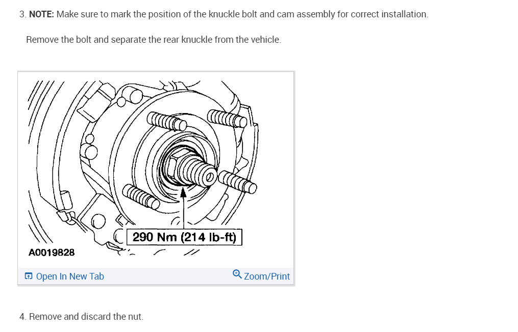

I have seen the CV axles cause these issues. When the CV joint wears out it will not transfer the torque of the engine smoothly. Here is a guide so you can see how the parts work and I have included the replacement instructions in the images below in case you need them.
https://www.2carpros.com/articles/how-a-cv-joint-works
This video will show you the steps as well, it is a similar car, but the process is the same.
https://youtu.be/nZPJzFuOITc
