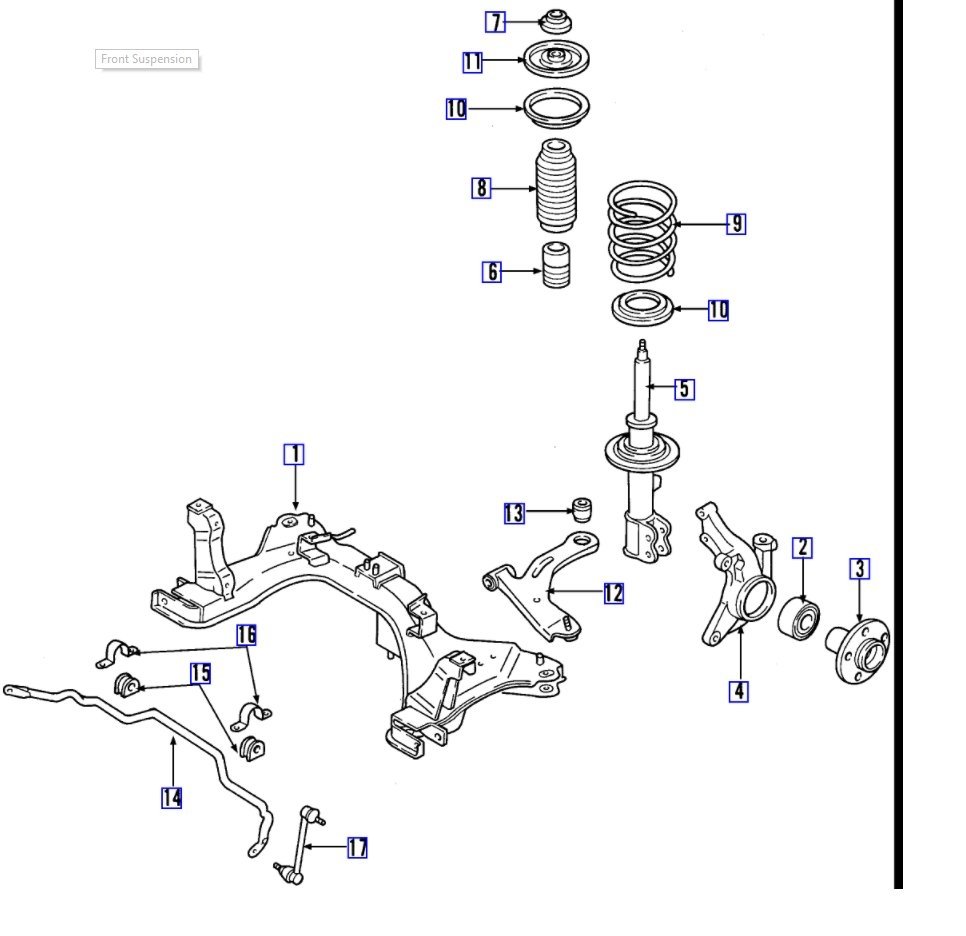

Yes the problem with these cars is the lower ball joints and control arm bushings. Here is a guide to help you see what you are in for when doing the job.
https://www.2carpros.com/articles/lower-control-arm-bushing-replacement
Purchase the entire arm its easier to and get both sides. Image (below)

Check either the sway bar links or the control arm bushings both super common on the Escapes.
